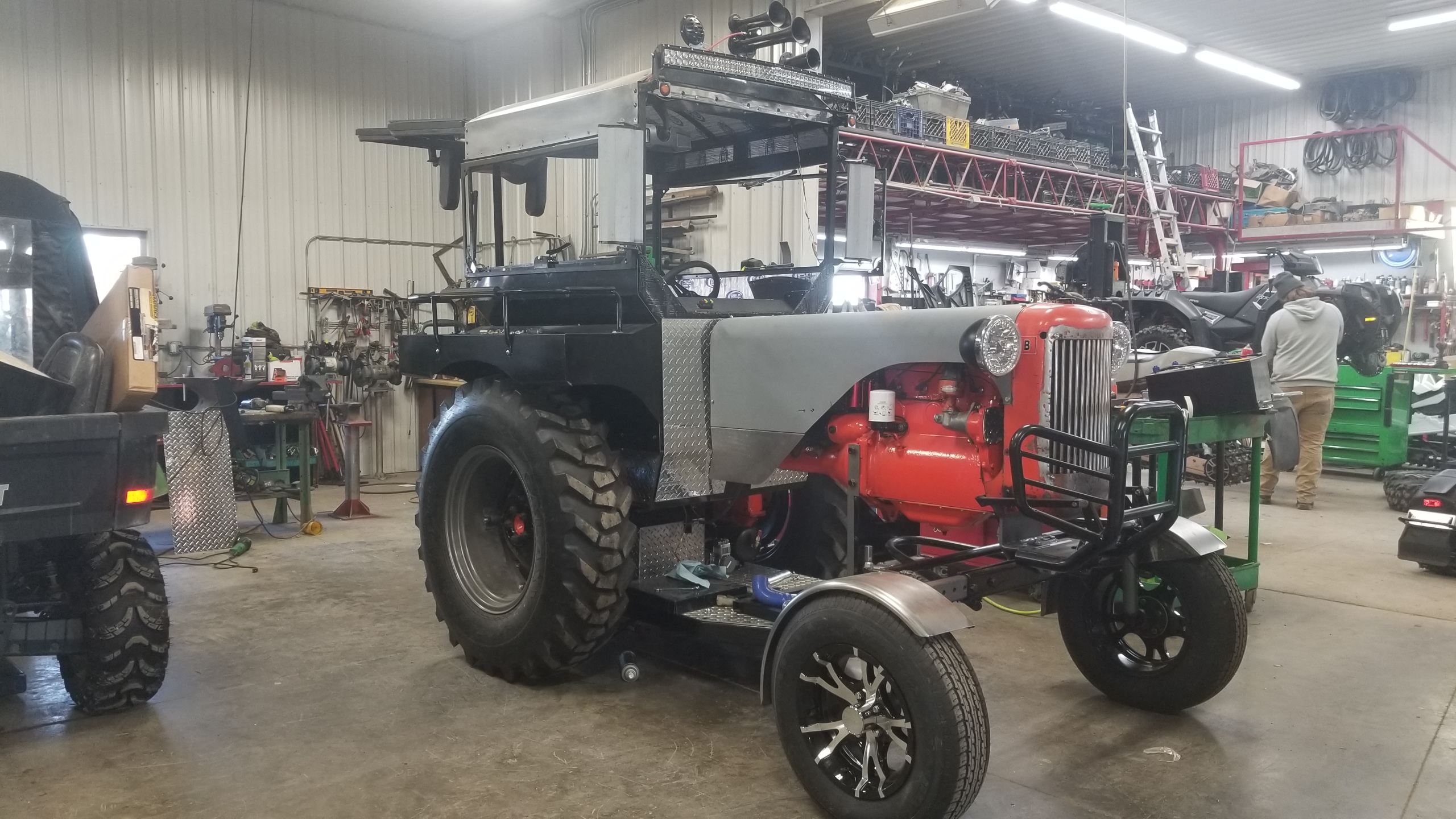

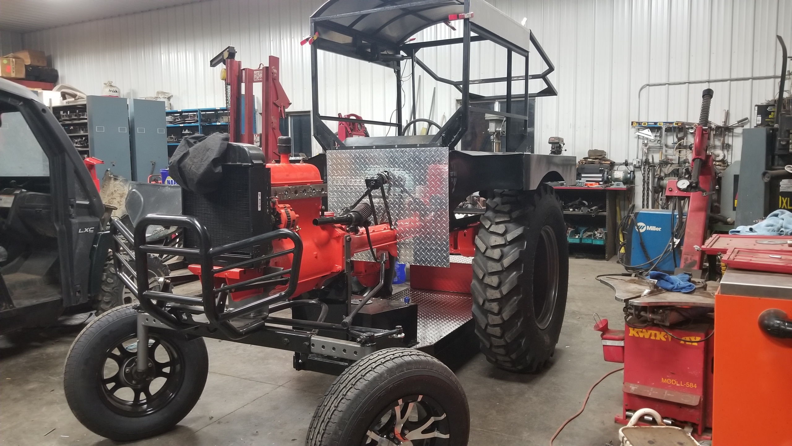

Got the hood made for the super b xt
Dick L View Drop Down
Location: Edon Ohio
Points: 5093
Post Options Post Options   Thanks (0) Thanks(0)   Quote Dick L Quote  Post ReplyReply Direct Link To This Post Posted: 23 Sep 2018 at 9:16am
That is going to be a head turner for sure when done.

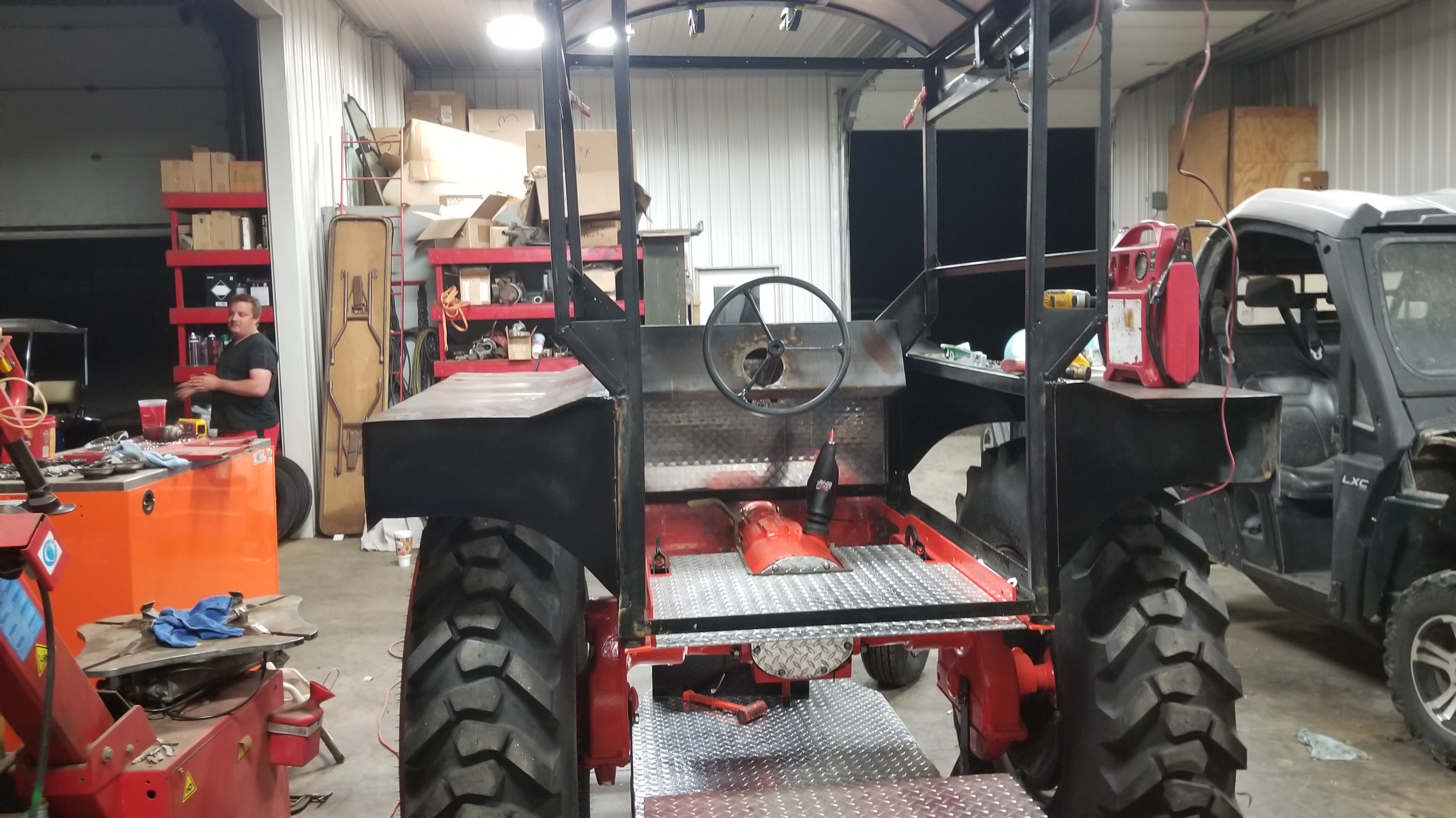

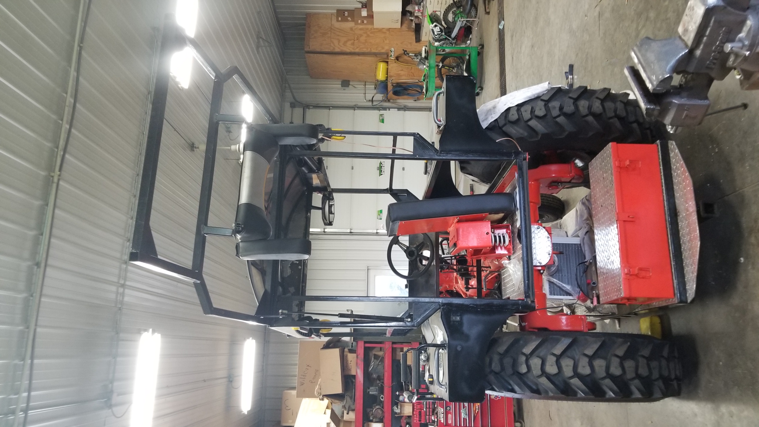

Almost ready for paint having trouble posting pictures for some reason. Get back to you
