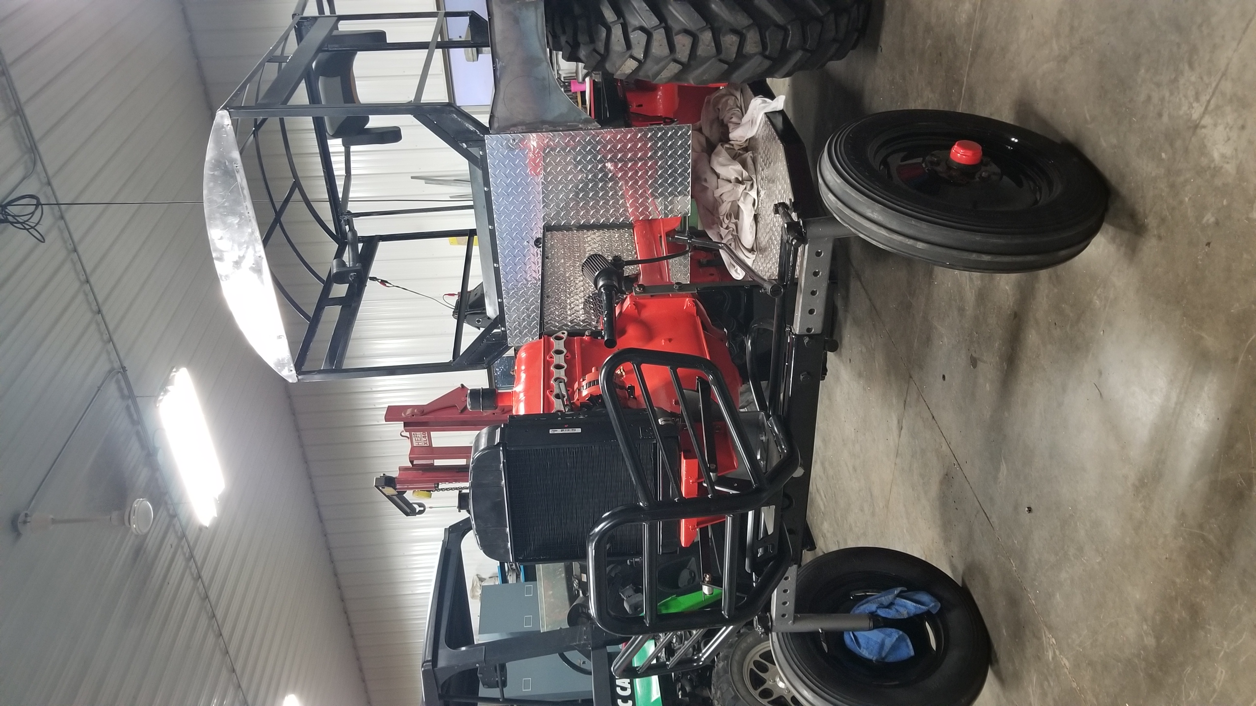

I'm new to discussion forums. building what I'm calling a Super B, and I want to build a high RPM engine for it. Any advice? Hardened seats? Why is the compression so low? Will D15 pistons work on it? Looking for about 3,000 Rpm. Bigger valves? I'm building my own exhaust and intake out of stainless steel.

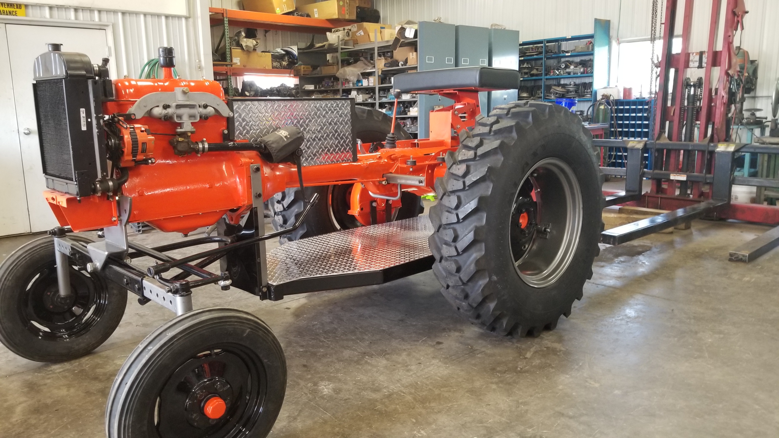

Another photo
