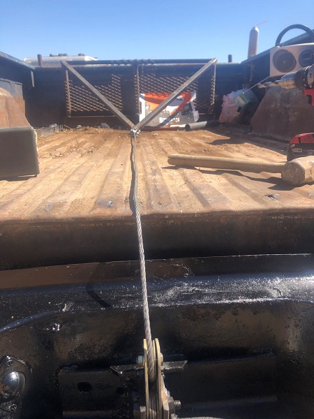

  That's got a hard azz back breaking job to do,,,,, and finds a way to "Get Er Done",,,,,

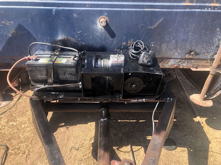

 Two or three months ago, I happened onto a Ramsey 3000# winch at the local friendly County Transfer Station,,,,(they don't call it "The City Dump" no more) Anyway,,it looked pretty complete so I trew it on the trailer and come on home. Soons I had a chance I piddled with it some and found that the forward "solenoid" was not working,, so I tried shorting across that terminals and DANG if it didn't start moving,,,!!  I took off all the copper strips they used for jumpers and sanded the contact areas til shiny and the SOB worked like a new machine forward AND Reverse,,!!  I put it up on a shelf thinking I would find a job for it for sure,,,,,,,,Ya'll know ole Joe's bout 7/8 Thrifty and 1/8 cheep,,,,,LOL
  Anyway,,when we started the re-shingling job on the house,,the first time I had to go dump a trailer load of shingles,,,,It took me dang near two friggin hours to rack all them friggin shingles out the trailer,,,,!! So, I mounted that cute little Ramsey winch on the back of the Pick up bed trailer, welded up a 1/4" cable "PULL" chingas that would just fit inside the inner fenderwells and THEN the three dudes workin on the shingles all wanted to go with me to see how this corntraption worked,,,,
 Guys,,,we had us a good sized CROWD all hemmin and hawin and wantin to take some pics,,,,ClapI hit the switch (Thanks Steve (I think) for the link to Surplus Center and that thing worked pretty as you can please and flat unloaded the whole friggin trailer full of shingles out on the ground before Quick Could Get Ready,,,,,,!!! Took longer to sweep out the trailer,,,,,Clap
  Well,,we made 6 trips to the dump and I knew I was gonna revise the winch location and move it to the front of trailer and make it a permanent installation as Then The boys won't run and hide when I mention that the "Trash" in trailer needs dumped,,,,,The winch would get all the trash dumped ON IT while in the back location and it being in front ,,it don't ever SEE any of the trash,,,
 See what ya'll think,,,,chit I might want to patent the idea,,,,,Clap

Back many years ago, a friend showed me a neat trick that is even thriftier.  If you are loading bulk materials for a trip to the dump, use a tarp that is 2x as long as the bed of the vehicle, in question.  put tarp in bed, with the excess tarp, in front of the bed.  load what you can pull out, maybe 200-400#. loop the tarp excess over the material. repeat with another tarp, and layer, etc, etc, rill you run out of tarps and material, or reach the height of material that is safe.  Get to the dump, pull off the top layer, and work your way to the bottom.  load comes off faster than you can fold the tarps...Wink

 Yeah, JC, I finished up the modifications and moved the winch to the front of trailer and run that cable under the trailer to a snatch block on rear bumper,,, then cable just lays on top of bed tied to the Pulling drag.  I also added some angle iron pieces welded to bed to guide that drag as it tried to climb over the fenderwells a time or two. It now just works slicker than owl chit.....Clap
