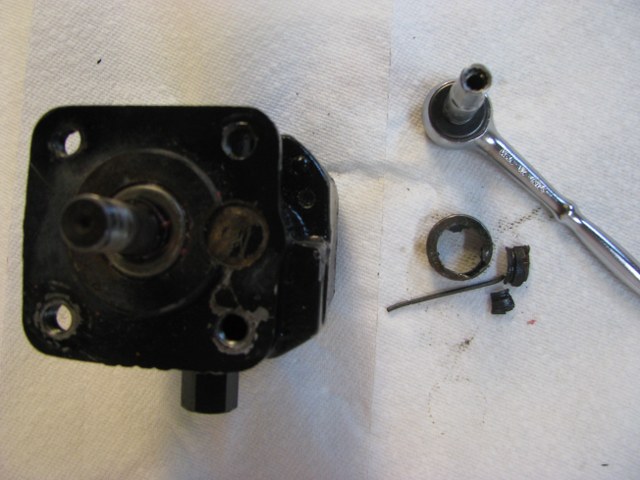

Not a happy camper as I discovered the shaft seal is leaking on my power steering pump. Instructions say to take apart the pump so the shaft can be removed along with the seal. Trouble is the pump is screwed together with what looks like 8, 12 point cap screws. Will standard 12 point sockets fit these? All I have is 6 point and a 1/4" is too small and a 9/32" is too big.
Here's a picture of the 8 screws and then one of the leaking shaft seal.

Metric maybe

Metric on a WD-45?????????????? GET A 12 POINT SOCKET...PROBABLY 1/4" 12 POINT.

Had the same problem...McMaster Carr has the 12 point sockets in stock and are quick on delivery.  As I recall however, you want to get a deep well socket because the normal one is too thick to fit in the recessed area.  Den

Sears has em (Craftsman)

Thanks everyone. You know what they say "every project is an opportunity to acquire more tools" I'll update as soon as I get the sockets.

Should be a 1/4" 12-point deep-well, and yes, a good investment.

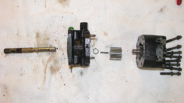

Well the 12 point sockets came today. Got the pump apart and the seal replaced and have it back together. There was a gasket between the two pieces of the pump. It looked like a metal foil gasket. For some strange reason I was able to get it apart, get the old seal out and new one in and it back together and didn't destroy the foil gasket. I'll put it back on the WD45 tomorrow night and then get it tested over the weekend. Thanks for all the help and suggestions everyone. Here's a few pictures.
