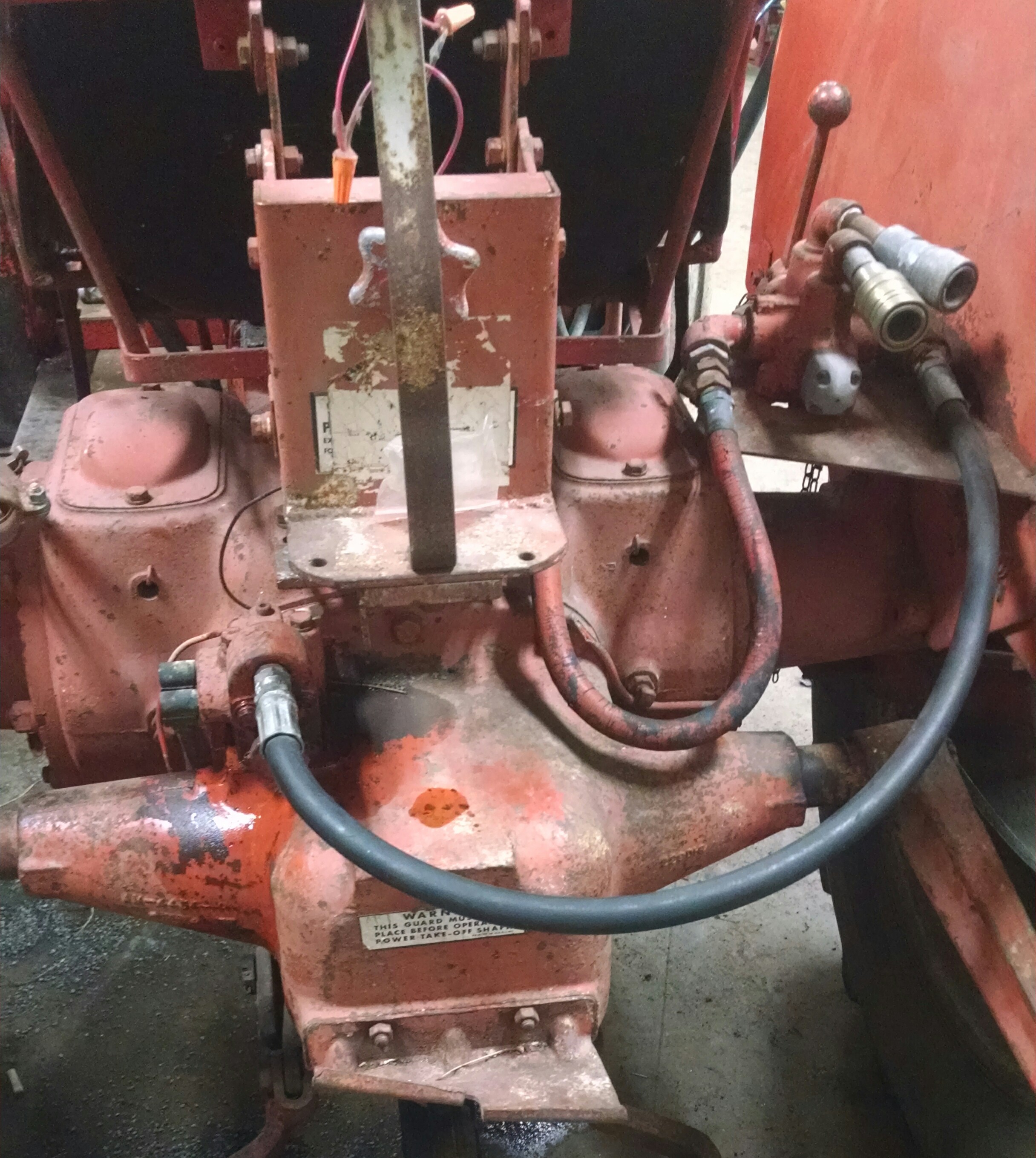

Hi I recently picked up a 1958 d17 with front pump and 500 series loader on it. All those things work well. But have run into a problem. I can't get the 2 point to lift or go down. When I push the lever to engage the hydraulics I can hear the pump kick in. But nothing happens. I can lift the arms up and down with my hand. It does have a separate remote running off the rear hydraulics. So I Even unhooked the hose and plugged it off to see if that would do anything. But it didn't. Also tried turning the knob underneath the hydraulics in and out doesn't help.fluids are all good to fill levels. Thanks

Could somebody shrink the pictures so we can get a better look.
The last tractor I sold was the D-17.  As said above forget the front pump.  It is my estimation that it works the loader only.
The ones I sold did not have all the additional hydraulic hardware on the side.  I would like to see how it is plumbed.  Where does it get it's pressurized hydraulic oil?   (1) from the front pump, or (2) from the internal hydraulic system

A very poor job of adding a low-pressure 2-way valve. Where the black hose connects to the block to the LEFT of the seat, it should be a Pioneer connection, so you can unplug that black hose when wanting to use the lift arms. So, disconnect that black hose to the left of the seat and plug the block where the hose went. Then, up is up and clear down is down on the long/lift-lower lever to the left of the steering wheel. Traction Booster lever needs to be DOWN.

I tried that also. No go
Post Options Post Options   Thanks (0) Thanks(0)   Quote CTuckerNWIL Quote  Post ReplyReply Direct Link To This Post Posted: 21 Feb 2017 at 4:58pm
Have you got a 2 way cylinder you could plug into the remote? If that won't operate the cylinder, you'll have to look further. It seems to me, if that 2 way add on is an open center valve, everything will be dumped back in the rearend and won't allow the lift arms to work. If it is closed center, the lift arms should work without disconnecting it.
Post Options Post Options   Thanks (0) Thanks(0)   Quote CTuckerNWIL Quote  Post ReplyReply Direct Link To This Post Posted: 21 Feb 2017 at 5:05pm
Here ya go Bill.
Post Options Post Options   Thanks (0) Thanks(0)   Quote CTuckerNWIL Quote  Post ReplyReply Direct Link To This Post Posted: 21 Feb 2017 at 5:06pm
So, is that block on the left, that the hose hooks to, a transport valve?

From the Operator manual: Transport valve- The knob on the valve must be turned out as far as possible for automatic operation of tools connected to the lift arms. The knob must be turned in for operation of ram when automatic operation is not desired.
