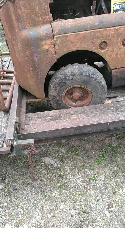

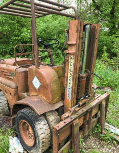

Hello everyone and thanks in advance for any help I get. I bought a Allis Chamlers fork lift yesterday and looking for any I can get on it. It does run kind of but smokes. It moves and hydraulics work but no brakes. Here are a couple photos of it.
Now to get it off my trailer.

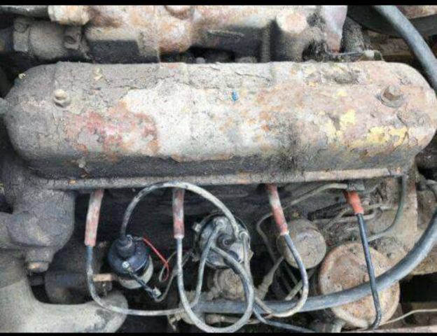

Well been tinkering with my new toy when I have a spare moment. I really need to figure out the smoking. It doesn't have air cleaner hooked up so its not restricted air cleaner. It smokes really bad on start up but longer it runs the less it smokes. I am thinking possible head return hole plugged up. Trying to find valve cover gasket but no luck locally and unsure of any I find on the net. Have looked at Liberated Manuals and no luck finding a manual so far.

As for the engine smoking... if it's over a while after start-up it maybe a case of the oil coming down the valve guides when parked several hours or overnight. A while after running the next day the smoke quits once burned off (relatively easy fix). If it were the piston rings worn out there is far less smoke on start-up and then when the engine warms up it starts smoking far worse. In such a scenario it can be a case of stuck piston rings also, from having been parked several years. If this situation is within reason you can change oil and use one quart of Rislone engine treatment for loosening gum & deposits and the rings will come loose after a few hours of warm running. I've had good success using it. Some engines are beyond hope with this method. Then you have to put up with smoke or spend $$. Have fun with you project.

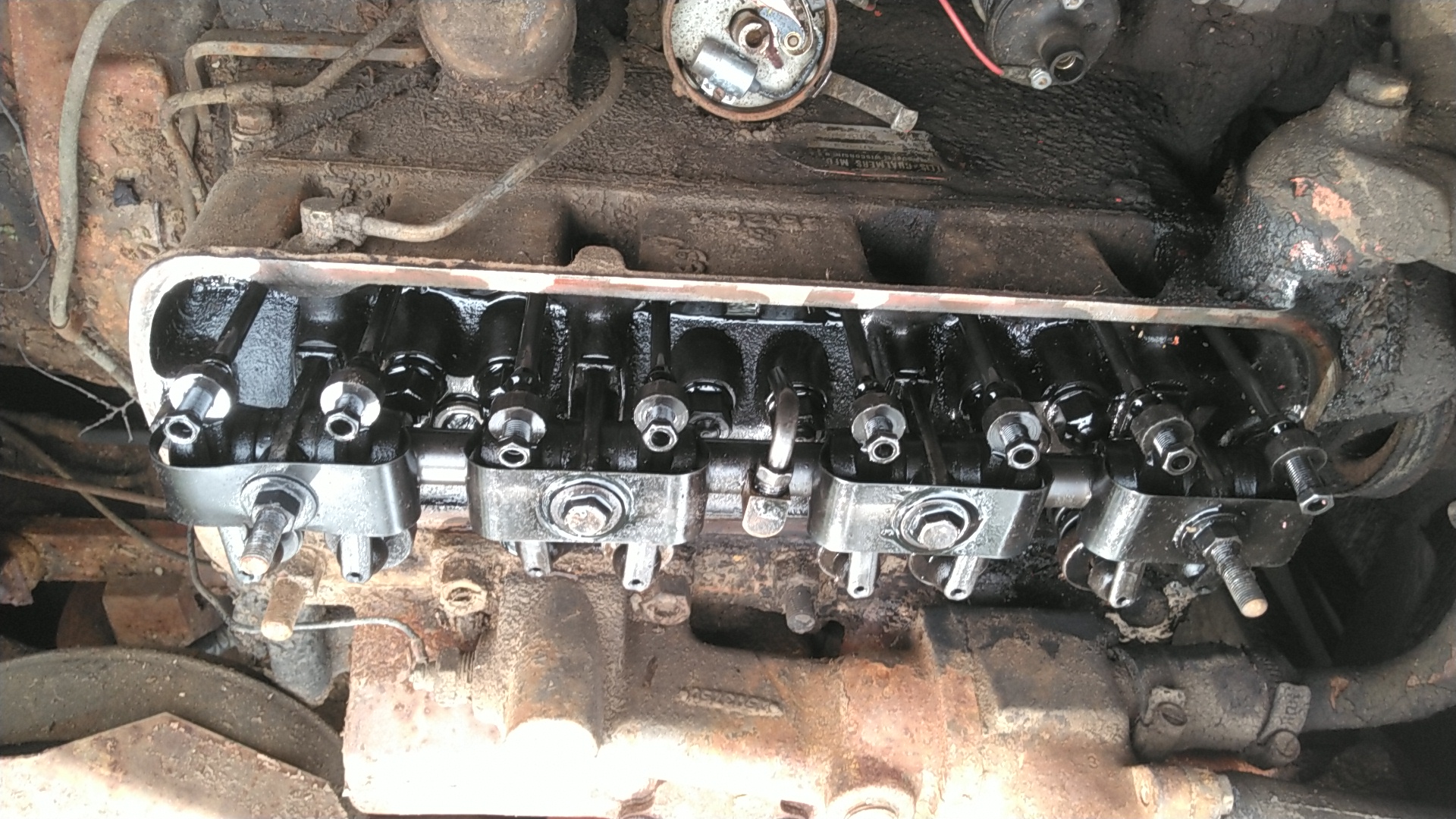

Well finally got a chance to pull valve cover and didn't find what I was hoping for it's absolutely clean inside so still looking for cause of excessive smoke on start up15910412497655027959464371108157.jpg

So you say the excessive smoke is on start up... does it run relatively smoke free after a minute or two? If it does it's just worn valve guides, I have done ''easy fix'' for that problem several times.

Got it running again after pulling valve cover and a tune up. And this time the smoke never stopped. it seems to have a weak cylinder so now to find parts to do engine tear down. But it did get the load of boards moved for me.
