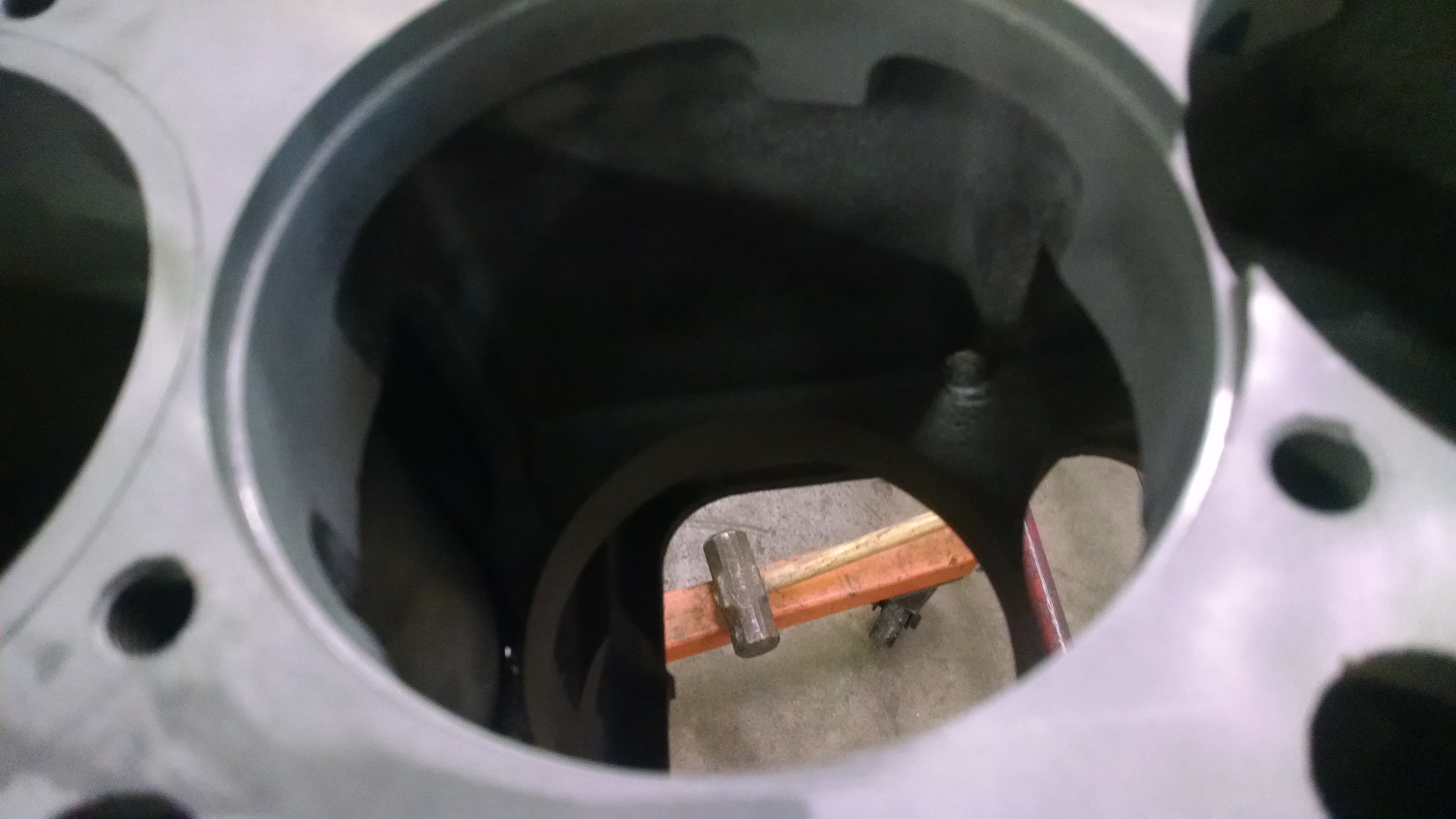

Here's a pic of how I do the flange.  I offset the cylinders on the original bores, 1 and 4 go out or away from the center to each end of the block, 2 and 3 move some also.  1 and 2 along with 3 and 4 overlap some on the flange, but there is some room left from 2 to 3 in the center.  All get moved away from the camshaft side of the block, then grind some clearance in the front, back and along the camshaft side to allow some coolant flow.  There isn't really enough material left to run much of a press fit on the sleeves, so .0005" press fit is all. Much more press fit and it is going to split the block bottom at this point.
 I make sure to take the edge off the bottom of the sleeve flange, so it has clearance to sit firmly on it's seat with out interfering with the slight radius left from the tool when boring the sleeve counterbore in the block.  I also do just a slight undercut under the flange on the sleeve.  If this isn't done, there is a chance that the sleeves could move a little bit
I blast the block clean on the inside, install sleeves with sleeve retainer around the bottoms.  Then I use a product called Rock Block, it's a fiber based block filler.  Grout based fillers will weep water, fiber will not, and it machines out easy and doesn't wreck tooling if the need ever arises in the future.
After install, they get bored, honed and block gets decked, then I cut O ring grooves in the sleeve.
This particular block in the picture is a #40 so it's solid above the center main for a 201 engine.  It's set at 4.6" bore with room left to bore to 4.7" a time or two should it get worn or scored.
