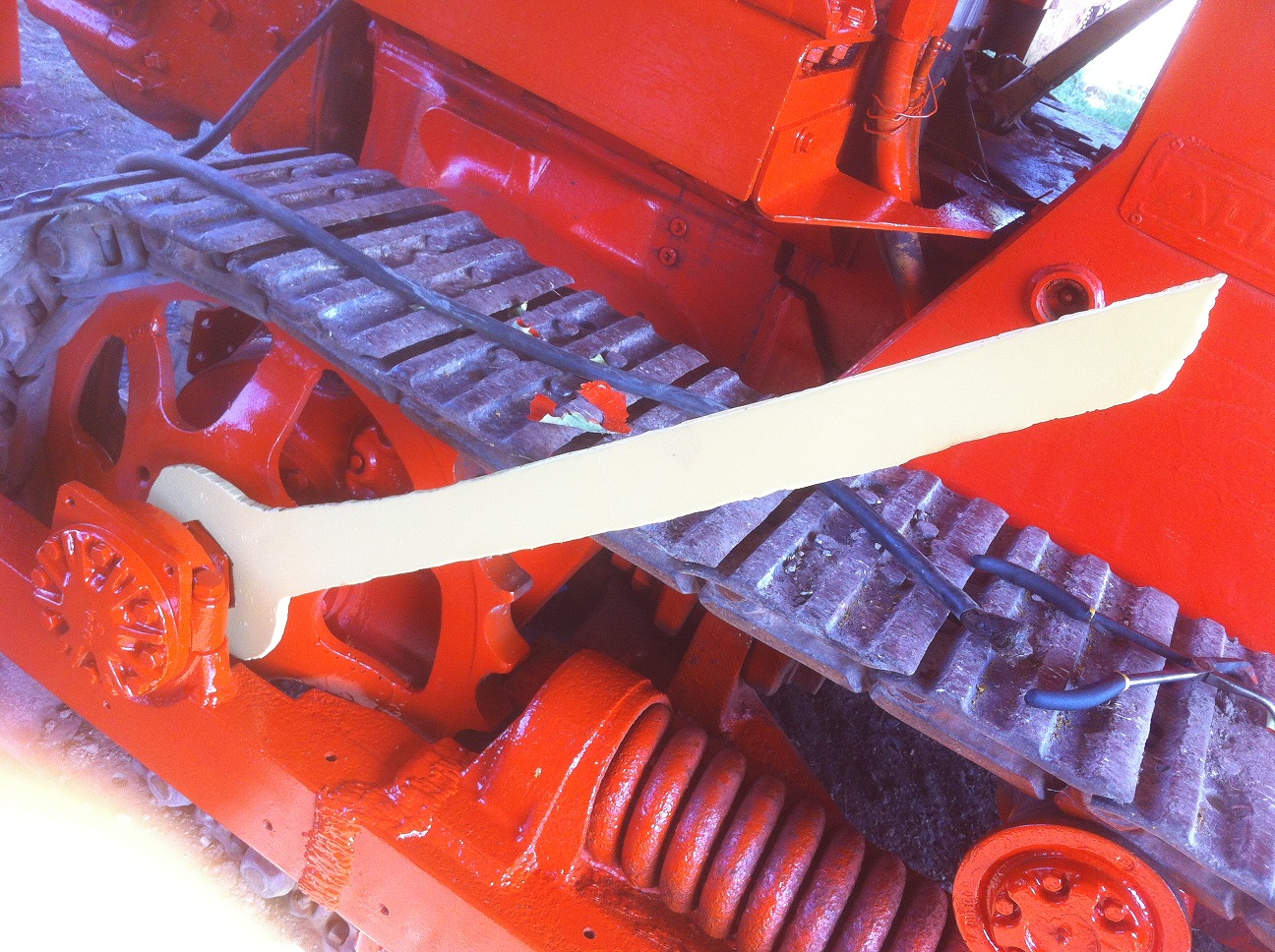

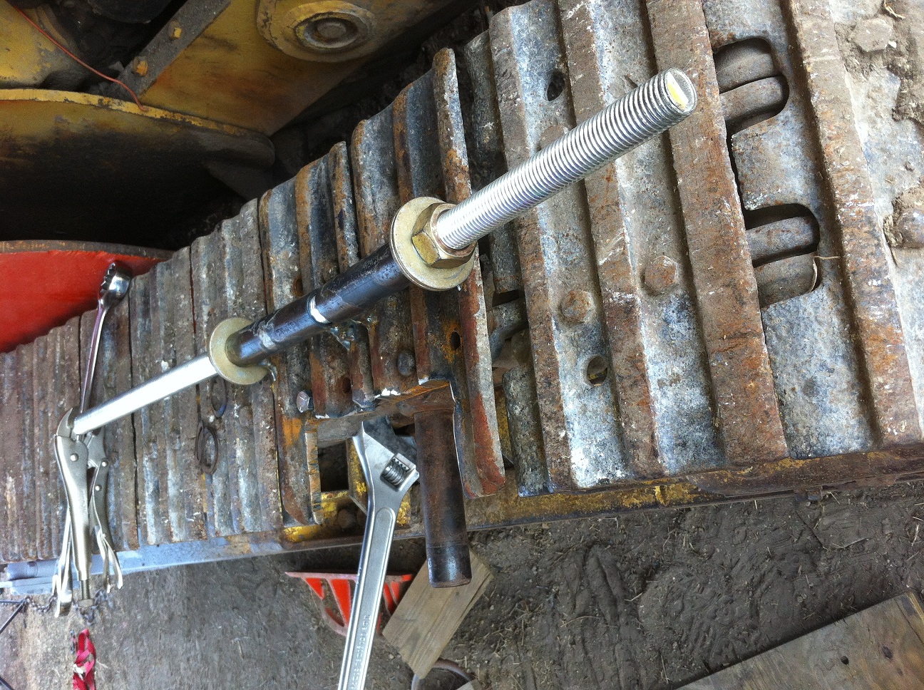

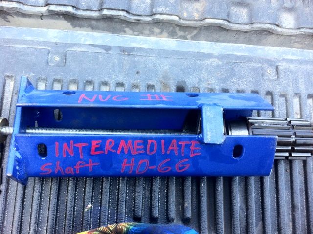

TWO OF THE FIVE TOOLS I HAVE MADE SO FAR FOR THIS MACHINEII WILL POST THE OTHERS LATER.

Tools that do the job. That track pin looks to be in excellent shape. What do you use to pull track pins wityh the track on the machine?

A ( B F H  ) and a punch . Punch has a handle on it so as to hold steady by helper while you use hammer . You can make up a sleeve to center punch onto the track pin , this  bolts to the track link so punch does not need to be located after each hit.
 On the pin (opposite side your driving from , buck the track link with a pipe or heavy metal bar to opposite track so hit is solid and not bouncing when force is applied.

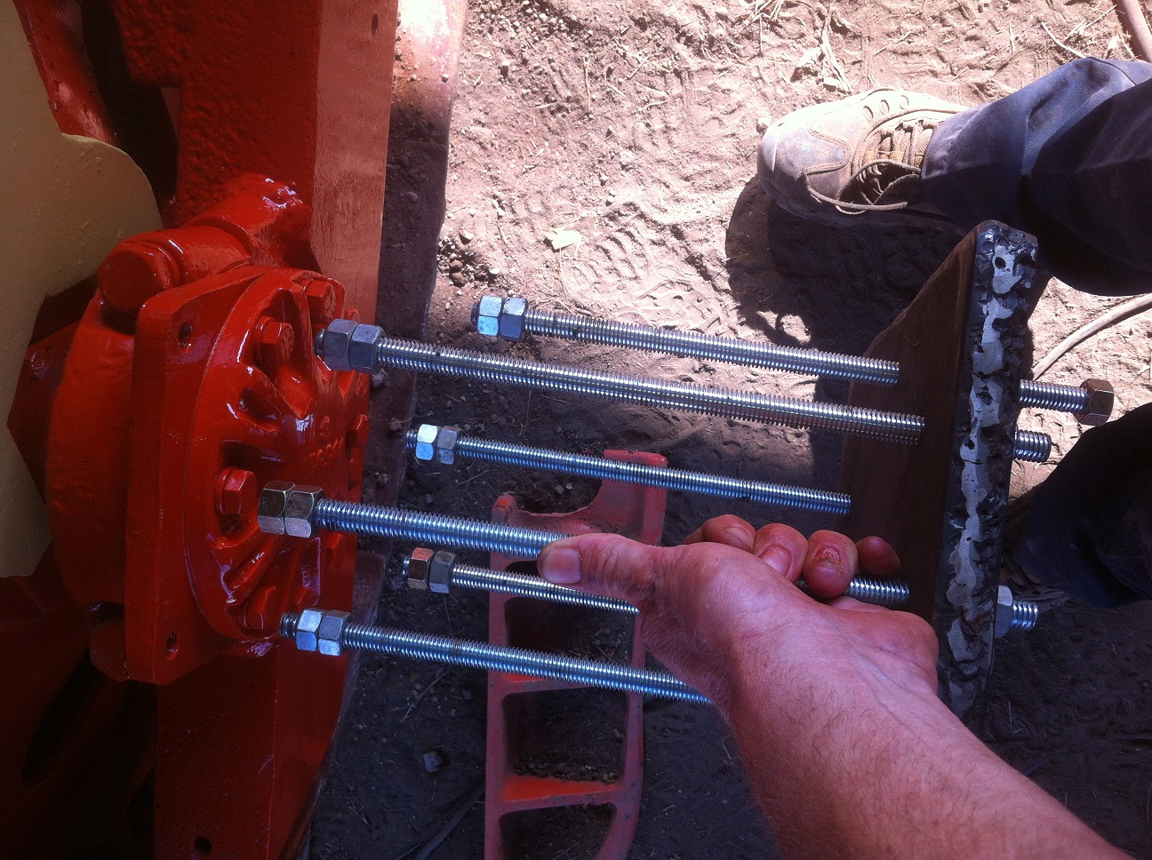

Dozer, The hard way like coke said a BFH! actually with a oxy acethylene torch to heat it also. Coke thanks for the idea i will be placing a piece of pipe on my track assembly tool to incorporate taking it off also. Here are two other tools i built for it. one is for the 4 inch nut on the center of the drive sproket and the other is used with a bottle jack to pull the outboard bearing.

by the looks of the weld on the track frame on the last pic that sprocket was changed without removing the trackframe. coke has talked about this before. nice tools, i like the pin lineup tool. we meed some pics of the whole nicely painted loader though.

Yea that is where I got the idea after several hours of messing with the pin on the track frame I went that way it seems to work pretty good , I've put the outboard bearing on after I welded it all back up and it was aligned pretty good no problems I will post a pic of the bracket I bolted up for alignment later.
