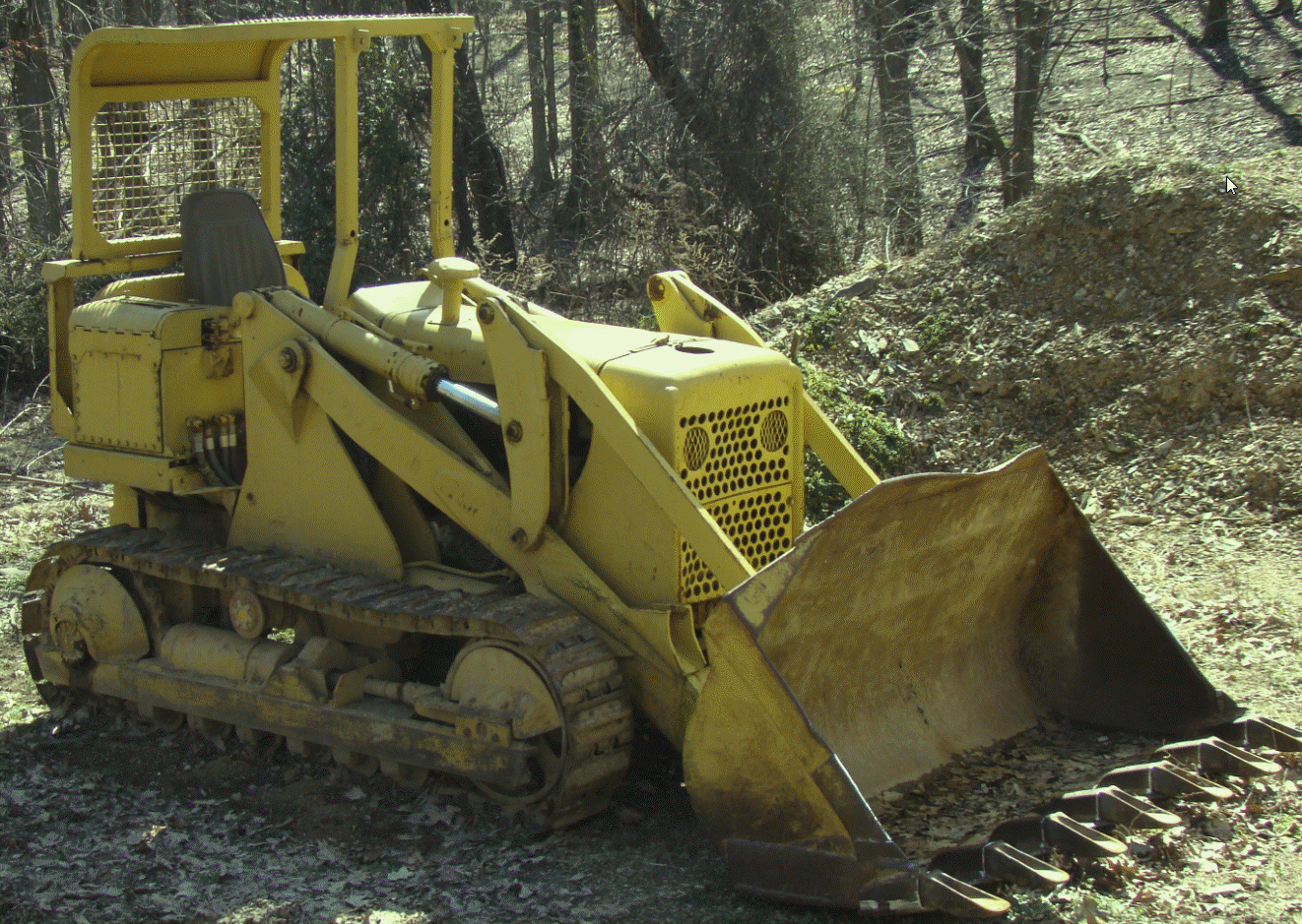

Here is a pic of my loader with cage.

that a good looking 6g.  thats sure some mean looking teeth!!

Nice machine and check your final drive oil level he is leaking.
