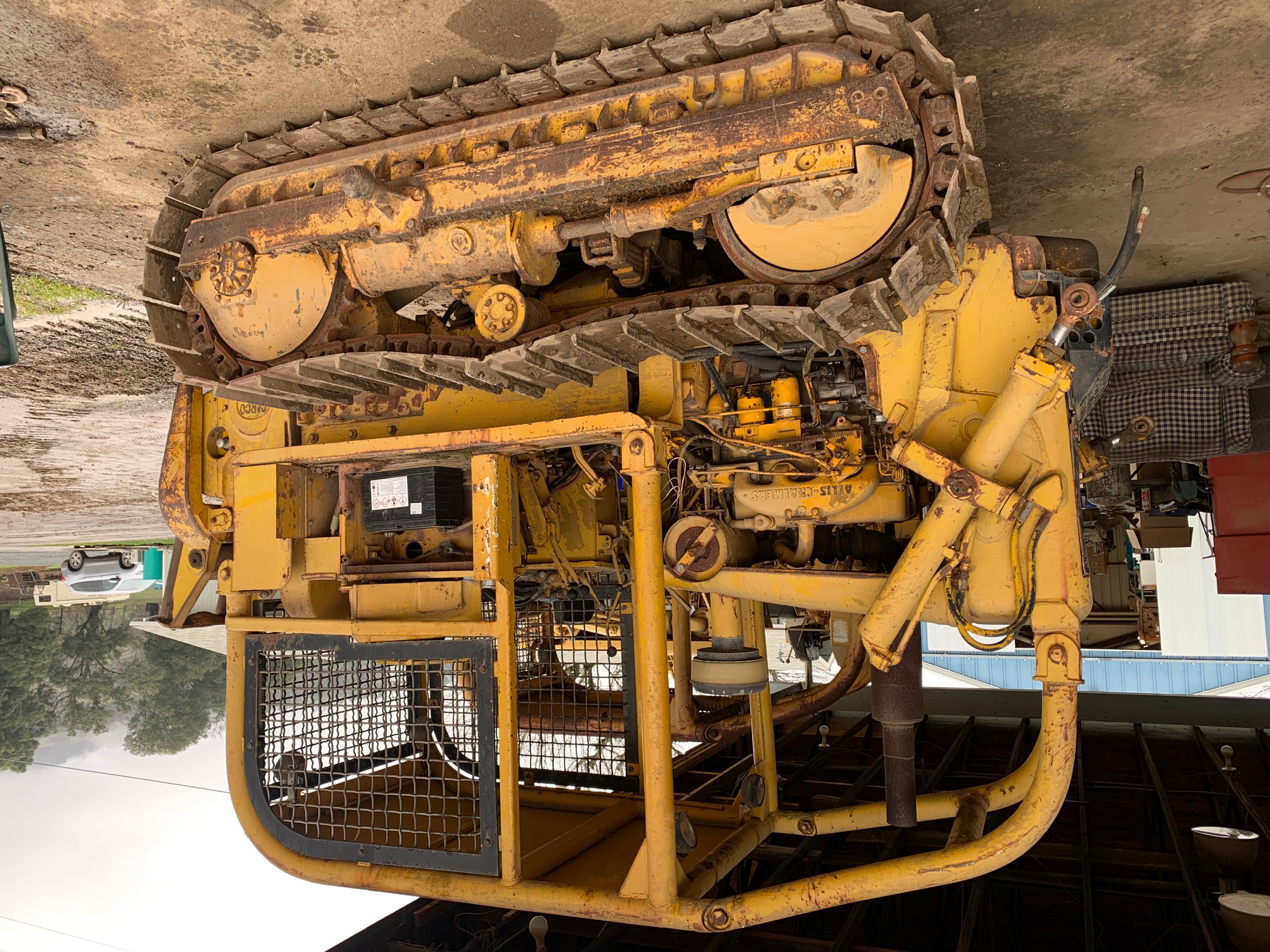

Ok...Thought I would revisit this post and appeal for help before we start this project. We will probably be doing a salvage logging job on our ranch property that became toast back on October 9th...not a lot of timber...but we'll be doing it all ourselves ...of course it will be an AC show. We have ready to go currently..1 HD11Bseries/with grapple...1 HD11EP/with winch...1 HD6B with winch....1 745C loader (way to big) waiting for repairs...1HD11B series/w grapple &winch...1HD6EP/w winch.
 So this 6EP has been sitting for some time..nothing has been done since this last post. The outboard bearing seal rings leaked after all of it was put back together. We have done a lot of these on different size tractors over the years and have never had this problem. Digging through our library I recently found a'' MODEL HD6EP TRACTOR  FIELD SERVICE INFORMATION BULLETIN"    I would like to call your attention to dimension #45 & 30. When we get this puppy back in the shop we will be trying to check these to see if this has led to our problem? Any thoughts? Any other experiences? We're listing.
We will check the swing frame dimension first #30.

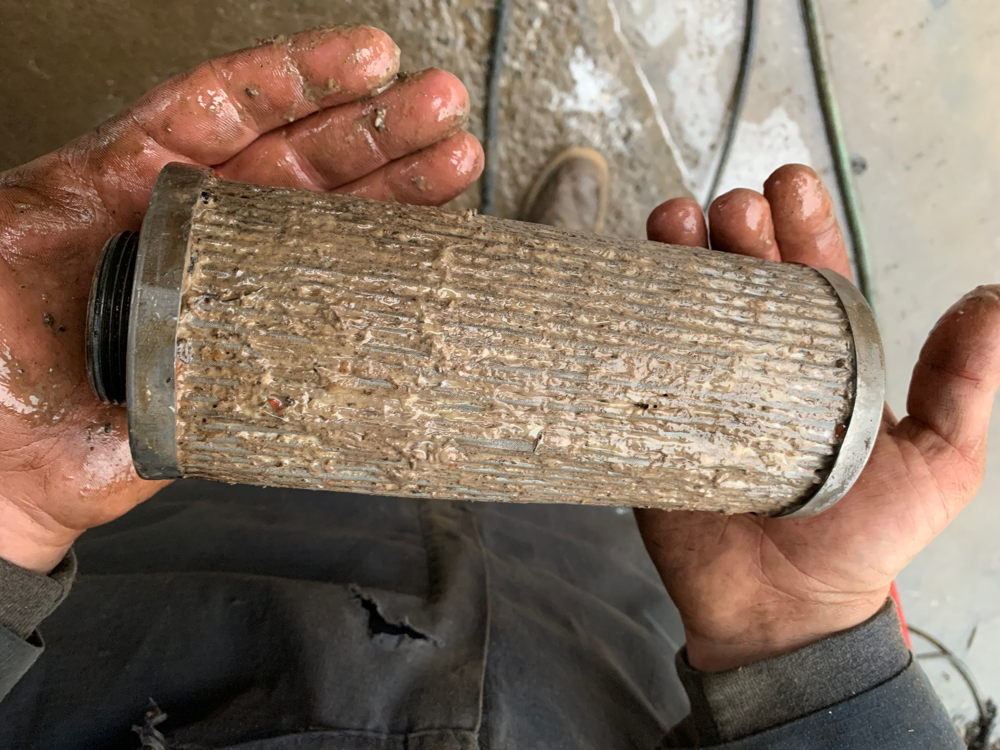

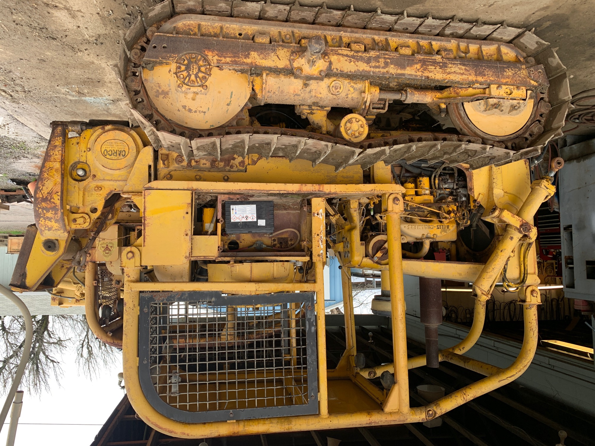

Ok....thought I would dust of this post....maybe put it to bed....with a happy ending and start a new post as this tractor travels on it's next journey.  So it was several years ago that I went back into the outboard bearing seal...replaced it....couldn't find anything wrong with it ...it quit leaking. But after that it would not steer. After we got a roof on our big shop a couple of years ago we moved it inside out of the weather...thinking we work on it. Well that didn't happen until last week...Brannen thought he would tackle the steering oil problem and get the tractor out of the shop to have the space for trailer repairs that need to be done.
   So what he learned was the suction line screen in the transmission supplys oil to both the steering pumps and the transmission charging pumps...through different ports at the strainer.   The screen was pluged so bad....yes so bad that the steering pumps could not pull oil...but the transmission charging pump would still pull oil allowing the transmission to function.
    So this picture is even after he started cleaning it. We have never run this tractor any where...so the previous owner probably was trying to operate this with those conditions.

That is really hard on those little
Steer pumps.

Yes steering and transmission both suck from same screen.
Andwe yes pumps are abit light.  Tractors after an 18000 number have a bigger steering pump. And after 19800 ??  there was an update from hydreco to cessna steering valves. Am told the cessna is a better steering valve.
Also that little drive tang that drives steering pump and winch pump can wear and break over time, something else to be aware of.
