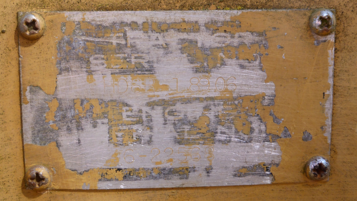

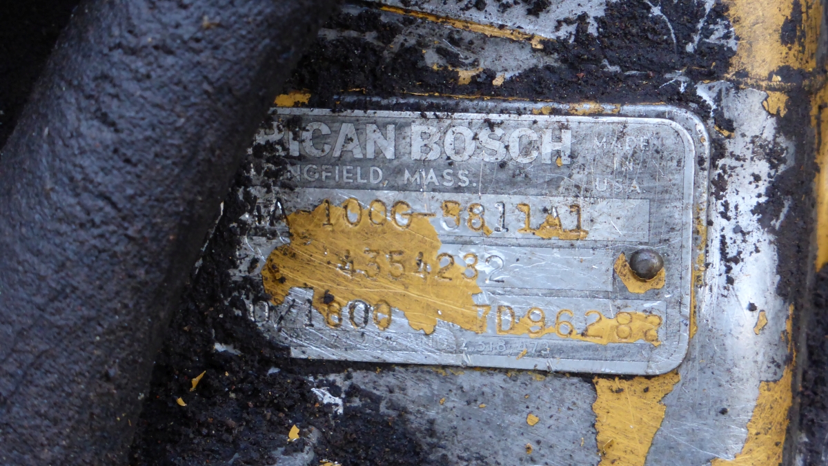

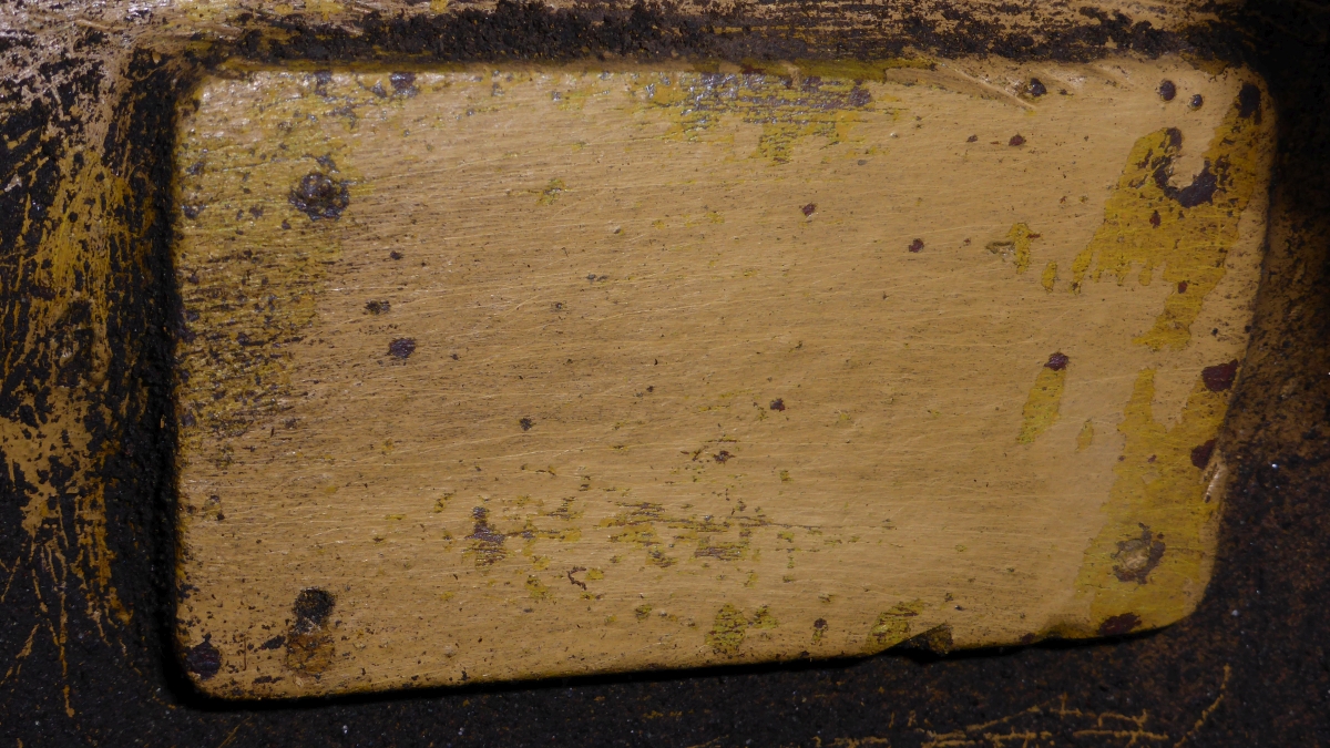

Post Options Post Options   Thanks (0) Thanks(0)   Quote kblackav8or Quote  Post ReplyReply Direct Link To This Post Posted: 26 Apr 2021 at 2:01am
Tried to figure out my engine serial number and the plate is missing off the block it appears.  Some of you more experienced guys may be better able to tell what I have from some other photos I just took before leaving the US for work overseas.  So far as I know it got repowered with a 7000 engine at some point as previously mentioned.
Points: 55248
Post Options Post Options   Thanks (0) Thanks(0)   Quote DiyDave Quote  Post ReplyReply Direct Link To This Post Posted: 26 Apr 2021 at 4:49am
Tractor # 18906 would be a 1965...   Per Swinford's book.
