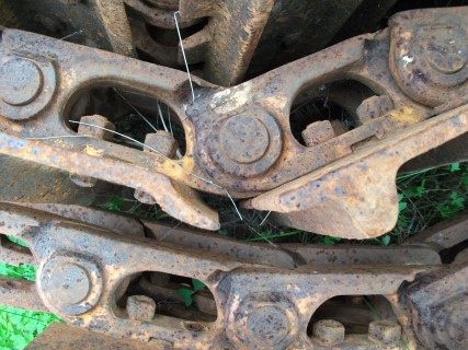

Hi All,
I'm new here & look forward to getting to know a bit about the Allis Crawlers,Loaders,etc.
I wondered if anyone has specs on HD5 or HD6 track chains?
I have a pair of chains here,which have a 6.5" pitch ,16" plates & 35 links.
Initially I thought they were IH TD9 chains,but I suspect they may be Allis.The 6.5 pitch is not too common,I think.
There is no identifying numbers on the links.
Any info is appreciated.
Thanks..
Jim

they look like Inter chains with the slot to locate the grouser plate, but 6.5 pitch is the same as  HD5/6.

Allis chains usually had quite rails even when the chains are worn

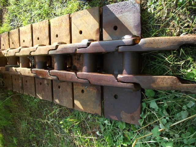

Hi Donoman,
I have the Berco specs on the TD9 chain.
Some of the specs match my chains,but others do not.
My chains might be old "aftermarket" chains,which often vary the dimensions a little.
I imagine that the 16 inch plates are not common.
I thought the arch pattern in each link might look familiar to somebody.
Edited by JimInOz - 14 Sep 2016 at 1:07am

Hi JimInOz,
 16" was an available size 13" 15" 16" 18" 20" 22" 24" and 26". my HD6G has 13" my HD6E's have 15 and 18" grousers, would be interesting to know the specs on TD9 Chains, a few years ago they went thru a stage of making those ribless chains but I think they may have stretched to much.

Another view
Happy to email the TD9 specs to you...PM me.
