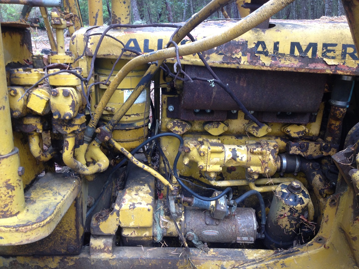

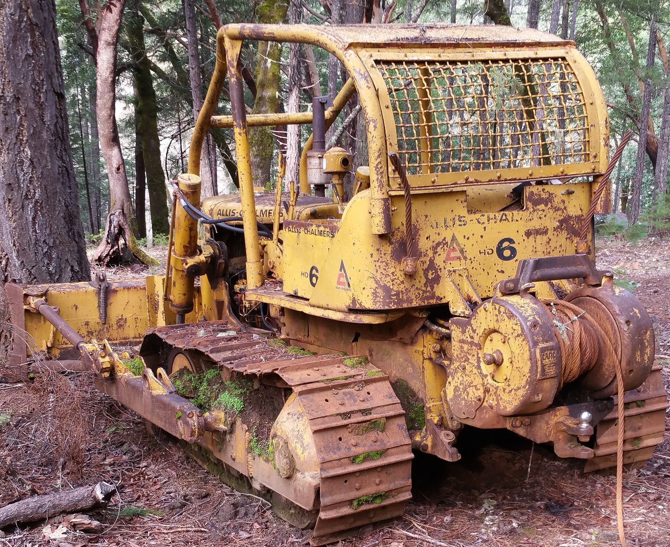

I bought a property and it included an HD6 tractor.  Upon closer inspection, there is a rod sticking through the engine block.
1.  Is this tractor worth fixing?
2. What is the right approach to fixing this....for example, get a short block, send the engine out for a complete rebuild, buy a new engine, etc.
3.  What other problems might this tractor have that I should inspect before dumping $$$ into it?
4.  What year is this tractor?

your intentions for repairing the tractor should have a bearing on how and if you decide to fix it.  if your plan is to keep it and use then maby yes.  if you plan to fix and sell your unlikely to make your money back.  depends on your skill, whether you send out for repair and your budget.
short blocks are not available. current engine could be fixed but probably cost prohibitive depending on other internal damage and lanova engine parts are getting hard to come by.  swapping in a good known engine is probably the most cost effective route but a gamble since you cant run the machine to test other functions.  likely it was functioning until it threw a rod but how long has it been sitting is anyones guess.  track pads dont look very worn but that isnt a good indication of pin and bushing/sprocket wear.  If the undercarriage is good, then possibly a good candidate to fix.
we need the serial # to know for sure what year but with lanova engine it could be 1955-1962
also you may receive more info posted in construction equipment forum
and yes.  if it was on my property i would try to fix it, but that is not an option for everyone.

Looks like a pretty handy sized crawler and seems like it hasn't sat too long.I don't know much about those crawlers and parts availability, but If it was mine, I think I would try to fix it.

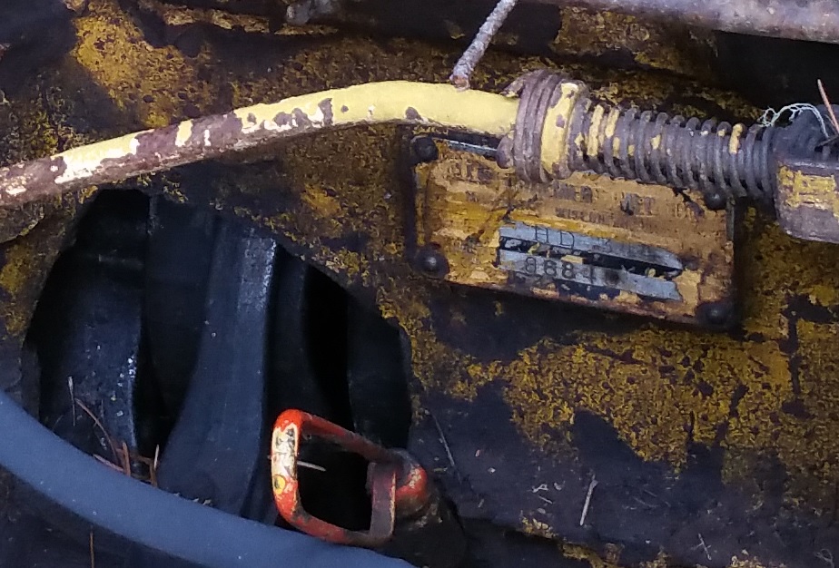

Here is an image of the plate on the block.  It is difficult to read and I'm 2000 miles away right now so I can't get a better image

I wouldn't scrap it yet. See if you can find another machine with a good engine and bad under carriage. Well I guess you need to look at your undercarriage first to see if it has life left in it also.
I see what your saying about the air conditioned engine block! Yikes. Do you have a bigger machine to move this one somewhere to work on it?
that is engine model and serial.  tractor serial is on dash on a plaque or on right rear clutch housing behind winch

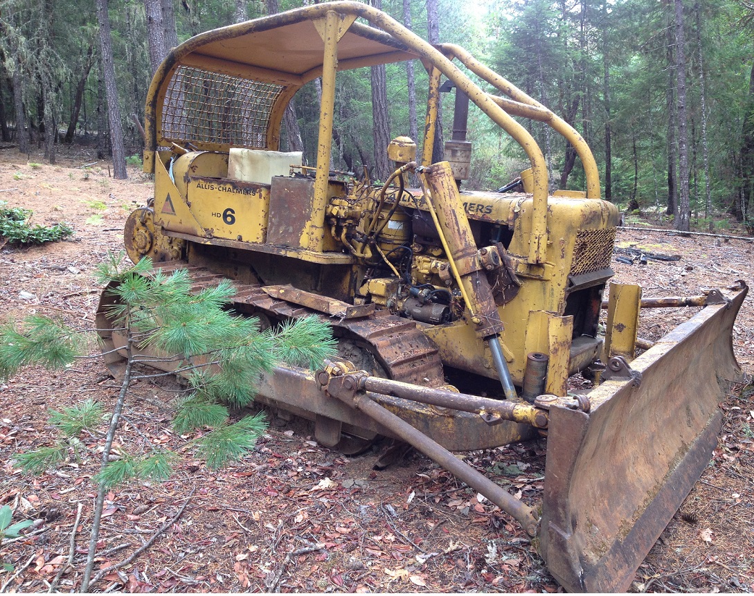

Just viewing your HD6 photos, its overall condition, tracks, & blade doesn't look too bad. One bonus is it has a rear winch. That can be very handy item. Congrats on owning an AC dozer. You should fix it or part it out to others on this site. Please don't scrap it.
According to my AC Farm Equipment 1914-1985 Norm Swinford book, the early HD dozers had a GM engine. Began in 1939 with two cycle GM diesels. WWII delayed larger & smaller dozers, so the HD5 & HD19 began in 1946. HD6 were not built in this period.
Later in 1953, AC acquired Buda diesel engines. The 1956 HD6B had a Buda D344 (4cyl CR of 15.0-1 Lanova (energy cell combustion chamber, natural aspiration). It had a max dbr 49.96hp & max pull of 12636lbs.
In early 1960's, AC diesel engines were re-designed to direct injection, open chamber, a feature that provided easier starting and improved fuel economy. These were known as the Thousand Series and the AC 6000 engine was installed in the HD6B or HD6E. The AC 6000 engine was a 344cu in 4cyl CR of 16.25-1, natural aspiration. It's max engine 75hp, max dbr 52 hp, max pull 15,485lbs. HD6E had power steering, power brakes, raised seat, multi-disk oil clutch.
In 1964, AC Ag Crawlers got a turbo, lighter weight grill & bumpers and reduced track guard equipment. So, a HD6AG had a AC 7000, 344cu in, 4 cyl, CR 16.25-1, had max engine 90hp.
Althought the 344 cu in engines saw 3 different horsepower ratings, they all were turning the same 1800 rpms. All the HD6 dozers had a 5 forward, 1 reverse transmission.

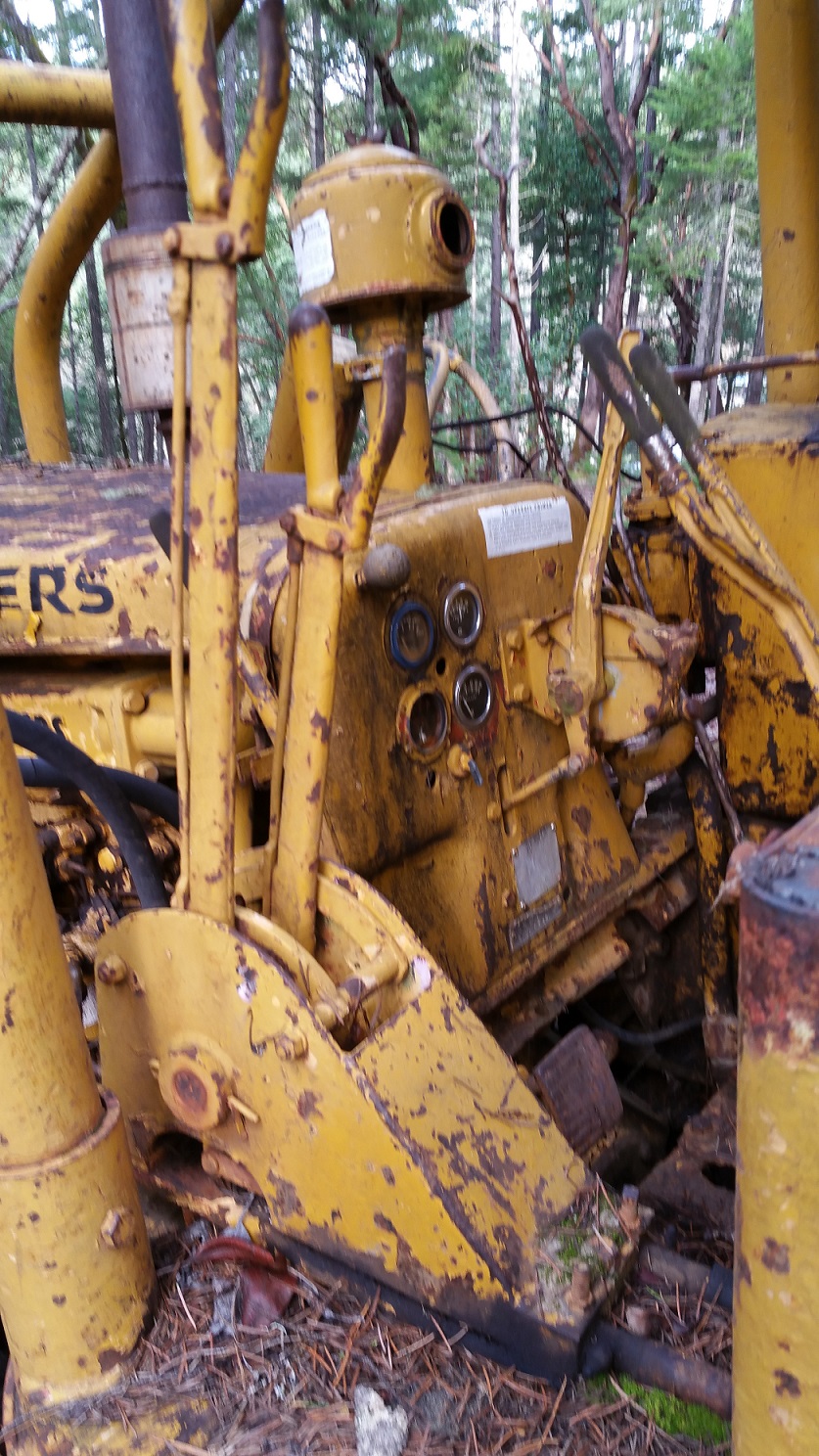

I have one picture of the dash, and I can see what looks like a plate, but its too blurry to read.

Perhaps we can't determine an exact year...yet, but from the pictures can we determine if this has a turbo or direct injection??
What is your best guess on the year?

Here is a picture of the dash, perhaps this will provide additional info for those that are familiar with this HD6.

It's a 1955 year model no later than June of 1956. Place your bets now.

Has to be an earlier one, has the push rod starter on it.

The serial number is on the bottom aluminum tag on the dash, below the hand throttle lever.  ''IF YOU POST IT ANSWERS WILL COME"   It's visible in your picture, but not readable

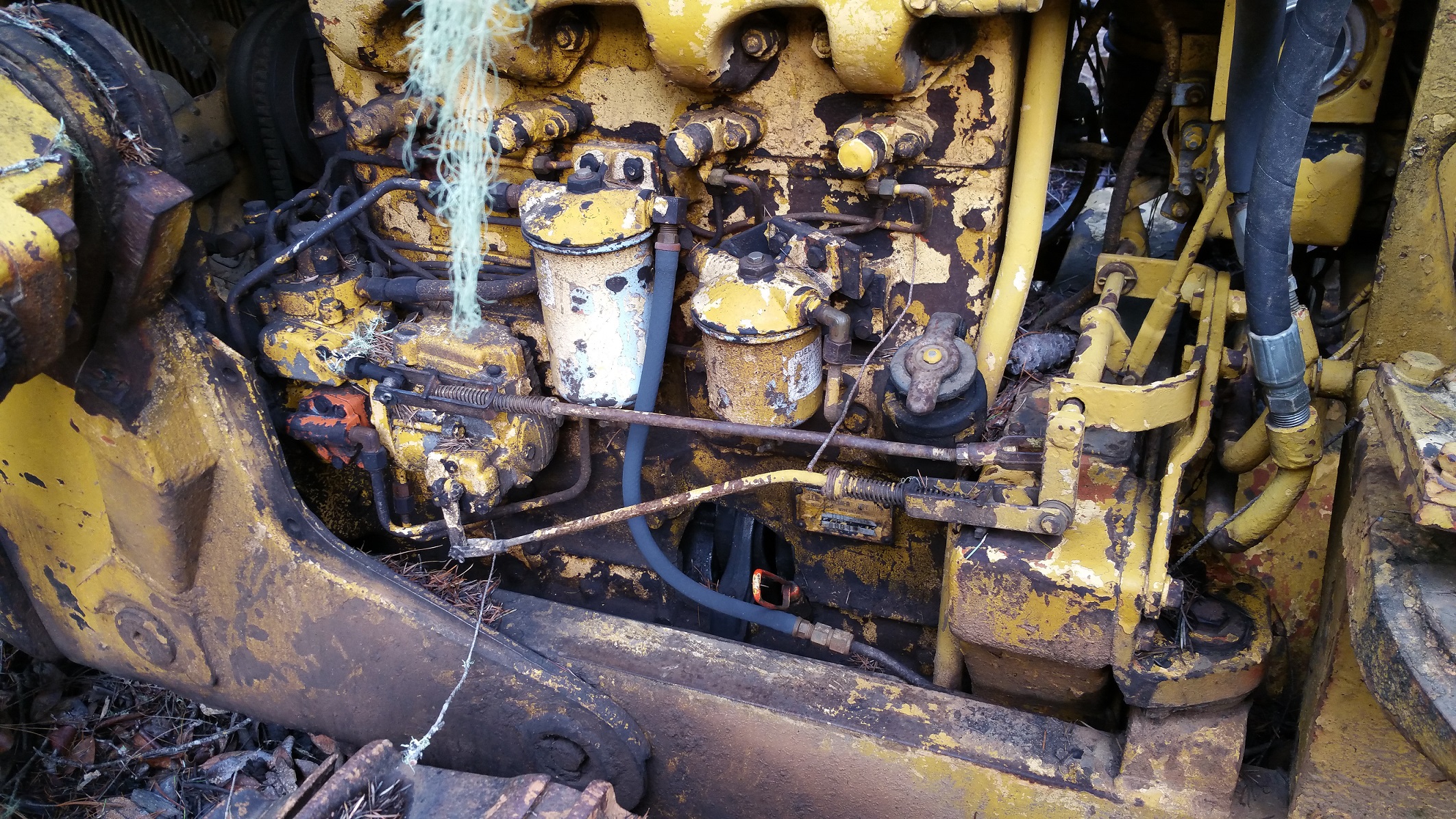

Um!
Would that fan belt in the fuel pump photo be inside out?
Not sure  what that says if so.

The hydraulic cylinders are not original AC.

I figured this was a late 60's early 70's tractor based on its appearance.  Based on the comments so far it seems that this may be a 60 year old tractor.   This is concerning as the people that owned this property, and therefore the tractor, were not the type to maintain equipment.  My bet is they ran the thing without oil or with oil so old that the rod through the block was inevitable.  This would likely also mean that the upper end of the engine has also seen abuse.   Hence a new motor is likely the only answer.
But then this brings into doubt the condition of the rest of the tractor.
What sort of transmission does this have?
Is it easy to check the fluid condition?
It may be a couple of months until I'm back there again, so I would like to come up with a plan of action so that once I'm  there I can determine how to proceed or not.
I do have someone going to the property next week.  I will have them take a few pictures of the dash.   If there are any other pictures that would help, please let me know.
