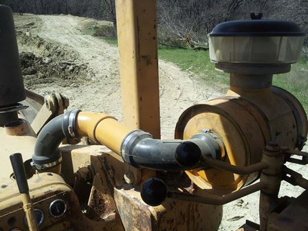

My HD6G is running AWSOME with the 7000 engine. I found a big double filter air cleader assy. off a Broce broom for 20 bucks at the local tractor salvage yard. I mounted it between the hydro tank and the loader arm and piped 3.0 in pipimg down through the hood to the turbo. The filter intake is 4.0 so I mounted a Cat precleaner on it. Its a powerfull setup.

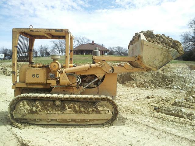

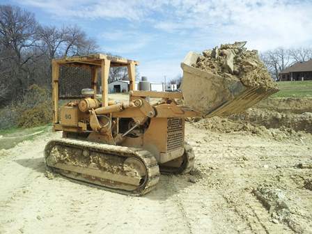

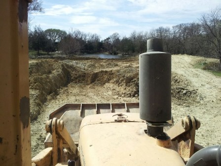

Post Options Post Options   Thanks (0) Thanks(0)   Quote Silencer223 Quote  Post ReplyReply Direct Link To This Post Posted: 07 Mar 2016 at 4:42pm
Reposting smaller pics.
Edited by Silencer223 - 07 Mar 2016 at 5:04pm
Silencer223 View Drop Down
Joined: 27 Aug 2015
Location: Anna. Tx
Points: 19
Post Options Post Options   Thanks (0) Thanks(0)   Quote Silencer223 Quote  Post ReplyReply Direct Link To This Post Posted: 07 Mar 2016 at 4:45pm
Sorry, pictures came out a little large. I can stuff a big block in a lawn mower but cant use a computer very well.
Joined: 27 Aug 2015
Location: Anna. Tx
Points: 19
Post Options Post Options   Thanks (0) Thanks(0)   Quote Silencer223 Quote  Post ReplyReply Direct Link To This Post Posted: 07 Mar 2016 at 5:09pm
Try these pictures.
Joined: 27 Aug 2015
Location: Anna. Tx
Points: 19
Post Options Post Options   Thanks (0) Thanks(0)   Quote Silencer223 Quote  Post ReplyReply Direct Link To This Post Posted: 07 Mar 2016 at 5:14pm
Just one more of the beauty queen. Im proud of her as you can tell. She just needs a little lipstick now.

I once went with a much larger dry filter on a road tractor and it made a big difference. No doubt more is better. Less makes the exhaust temp. higher, not good. If you have a truck salvage close to you, why not go there and pick up a large canister. From looking at the one in the previous post it looks like there is a convenient spot to mount it. You're on the right track and you'll be happy as a clam when you beat the system. Leon R  Cmo
LeonR2013 View Drop Down
Joined: 01 Jan 2013
Location: Fulton, Mo
Points: 3500
Post Options Post Options   Thanks (0) Thanks(0)   Quote LeonR2013 Quote  Post ReplyReply Direct Link To This Post Posted: 03 Apr 2016 at 8:15am
Silencer, you've done a good job there and you have the right to be proud. It sure looks good to me. I just wish I wasn't too old to do these things again. Well maybe not too old(75) this summer, just pretty well broke down. But I can still dream can't I? Leon R  Cmo

Air Filter up high out of the dust zone, nice selection for the air cleaner and nice location.  Keep up the good work.
