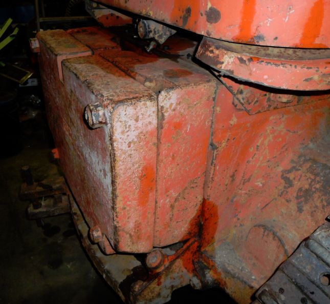

My HD5G has 2 counter weights on it - a larger thick one inside and one about 3/4 thickness next on outside - both have a rod cast into top of cutout for lifting them.
 Two weights I would say in many cases is a little light if working heavy soil - but for most use with the 1 yard bucket it's OK . Backing up in soft ground with bucker about 2 ft high it will tend to transfer weight to front idler so keeping bucket low when reversing is best .

The 2 weights on my HD5B
