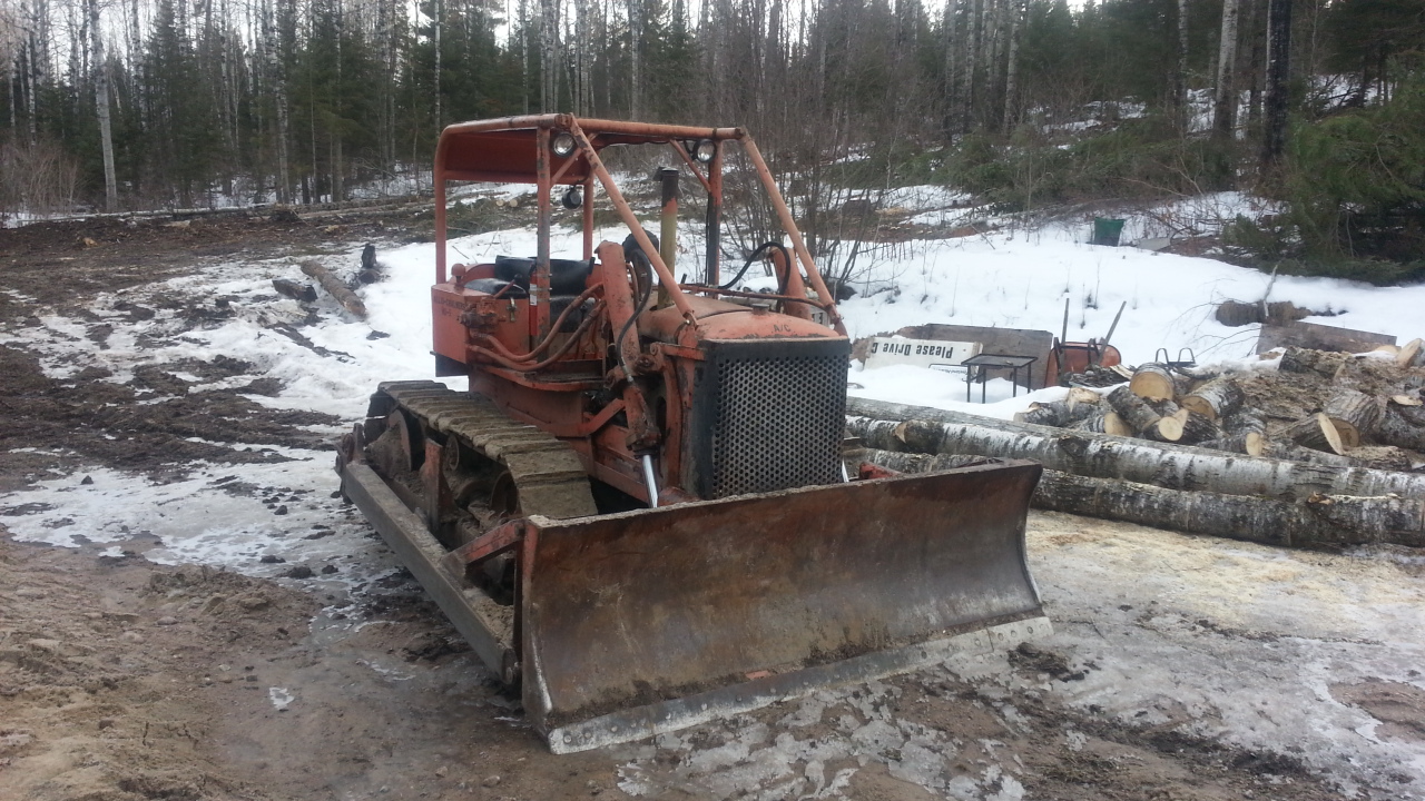

Post Options Post Options   Thanks (0) Thanks(0)   Quote serioussam Quote  Post ReplyReply Direct Link To This Post Posted: 10 Oct 2016 at 5:46pm
this is the only picture that i have on my phone.

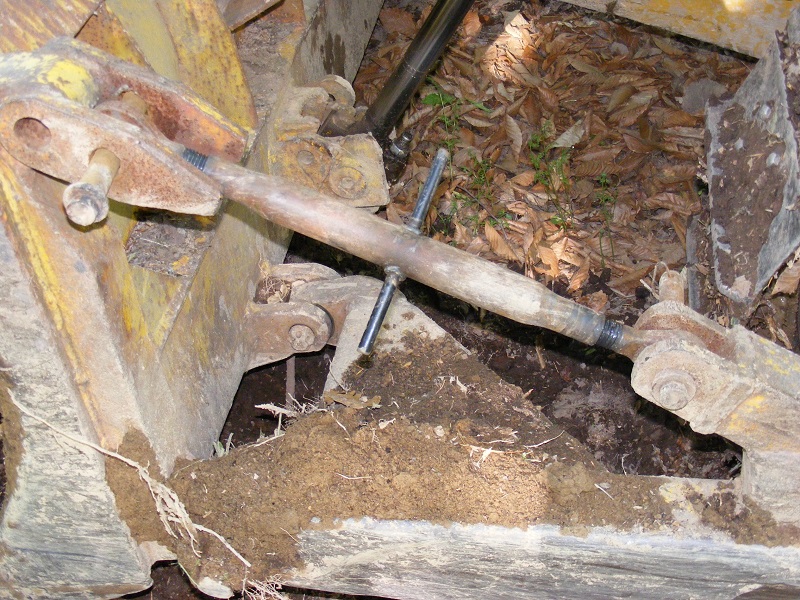

Post Options Post Options   Thanks (0) Thanks(0)   Quote dadsdozerhd5b Quote  Post ReplyReply Direct Link To This Post Posted: 10 Oct 2016 at 7:02pm
here it is, simple but effective. only takes about 2-3 turns to make a significant cut.
HD5B, HD5G, (2) FARMALL A's, CUB. DO IT RIGHT THE FIRST TIME, IGNORE THE LAUGHTER. FLANNEL IS ALWAYS IN STYLE.

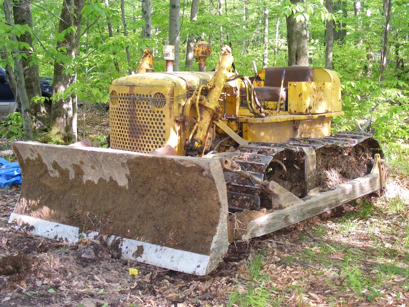

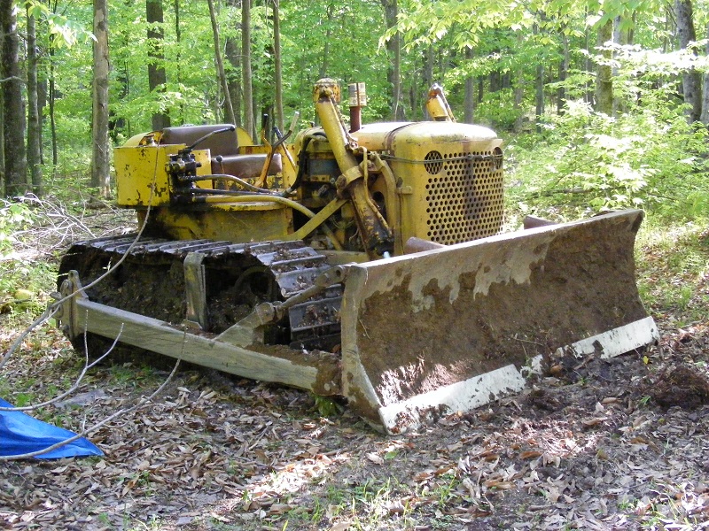

Post Options Post Options   Thanks (0) Thanks(0)   Quote dadsdozerhd5b Quote  Post ReplyReply Direct Link To This Post Posted: 10 Oct 2016 at 7:07pm
here are pics of both sides. we put the adjusters on both sides but only adjust the left as the right side froze up.

Post Options Post Options   Thanks (0) Thanks(0)   Quote Dozer Quote  Post ReplyReply Direct Link To This Post Posted: 11 Oct 2016 at 7:26am
Sorry for my reply. Your Baker bulldozer is not like the Baker I remember.

im kinda surprised  those turnbuckles are heavy enough,  the ones on my 16 are about 6 inches in diamater

Post Options Post Options   Thanks (0) Thanks(0)   Quote dadsdozerhd5b Quote  Post ReplyReply Direct Link To This Post Posted: 11 Oct 2016 at 9:19pm
We did break the end of one after about 20 years of service. They hold up well. I was going to just use one cylinder as adjusting one works great now except for having to get off and manually adjusting each time. Makes you a better operator though to figure out how to run it without many adjustments. Need a diverter valve for the main hydraulic valve or use a small electric pump. Not sure how I am doing it yet. Any suggestions?
