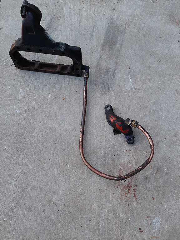

I finally got a chance to dig into the old 2-71. It looks like the former owner did some interesting repairs. This guy was very fond of orange silicone. I pulled the water pump and oil cooler housing and found gobs of of the stuff clogging almost every oil passage in the top end. He also did some kind of bypass on the oiling system for the top end. Any idea why he would have done this? Seems like this would limit the amount of lubrication getting to the top end?
Points: 35604
Post Options Post Options   Thanks (1) Thanks(1)   Quote DMiller Quote  Post ReplyReply Direct Link To This Post Posted: 23 Jul 2020 at 2:27pm
Basically not knowing he screwed up with all the Silicone and tried a bypass retrofit to fix what he could not mentally support.  Blue Glue is NOT our friend in most conditions and is not used in liberal slatherings.
