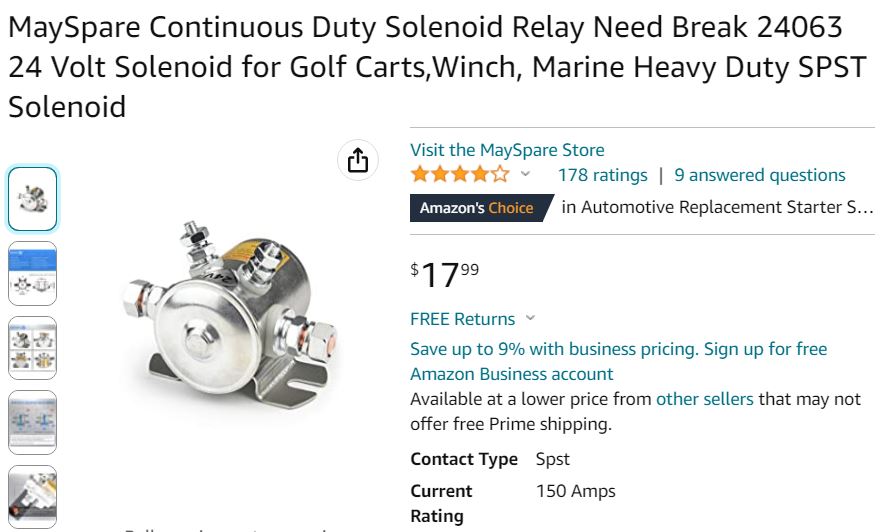

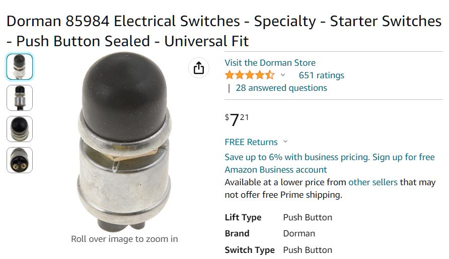

Jim... something like this... You can get a push button starter or key switch for the ignition.. It only has to be good for a few amps... The SOLENOID is what carries all the current... i took a GENERIC drawing and crossed off the coil / alternator part... what you need is the starter / solenoid / button portion..
Points: 90643
Post Options Post Options   Thanks (1) Thanks(1)   Quote steve(ill) Quote  Post ReplyReply Direct Link To This Post Posted: 15 Apr 2023 at 8:31am
most of these little guys are good for 15 amps or so.... thats probably 4 times what you need....more is better..
make sure you use a 24 v solenoid and not a 12 v.... could burn up the magnetic coil..
