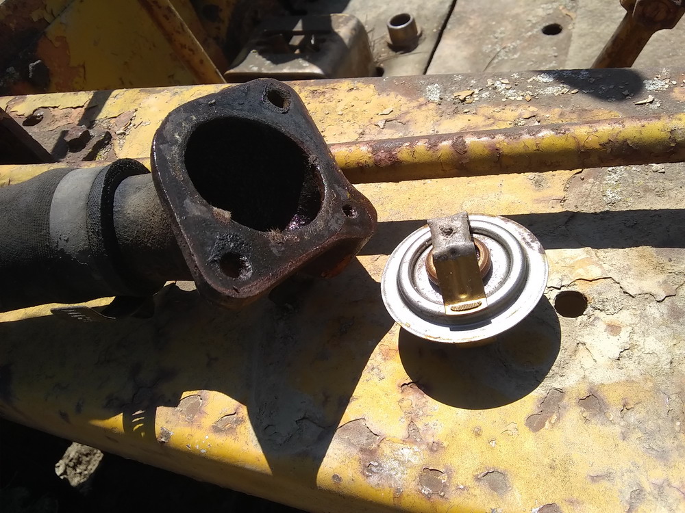

Replaced the thermostat and cut the gasket with the bleeder hole. Still not coming up to temp on the new gauge, might be bad. Will test with a infrared soon to make sure.

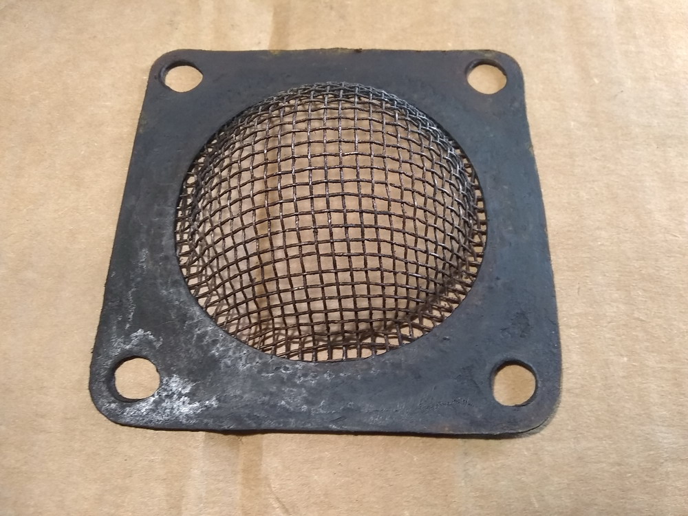

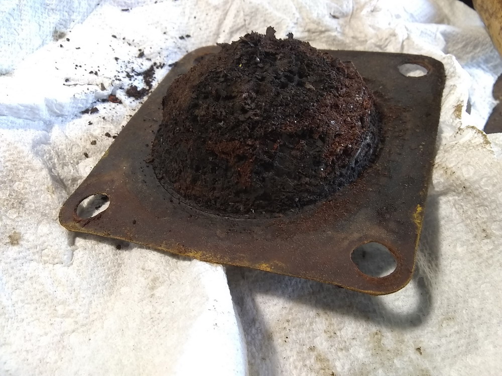

Now to the black smoke and no power. Took off the intake to the blower to check the screen that the parts manual showed. Full of junk and rust. When I was cleaning the air filter I found that the pipe from the filter to the intake was rusted inside. I cleaned and painted this. After cleaning the screen there is no black smoke and lots of power, spins the tracks now.
Now if only my tracks weren't worn out I'd be great. I'll take the wins when I can. Hope this helps someone.
Was even more on this when I took it out.
