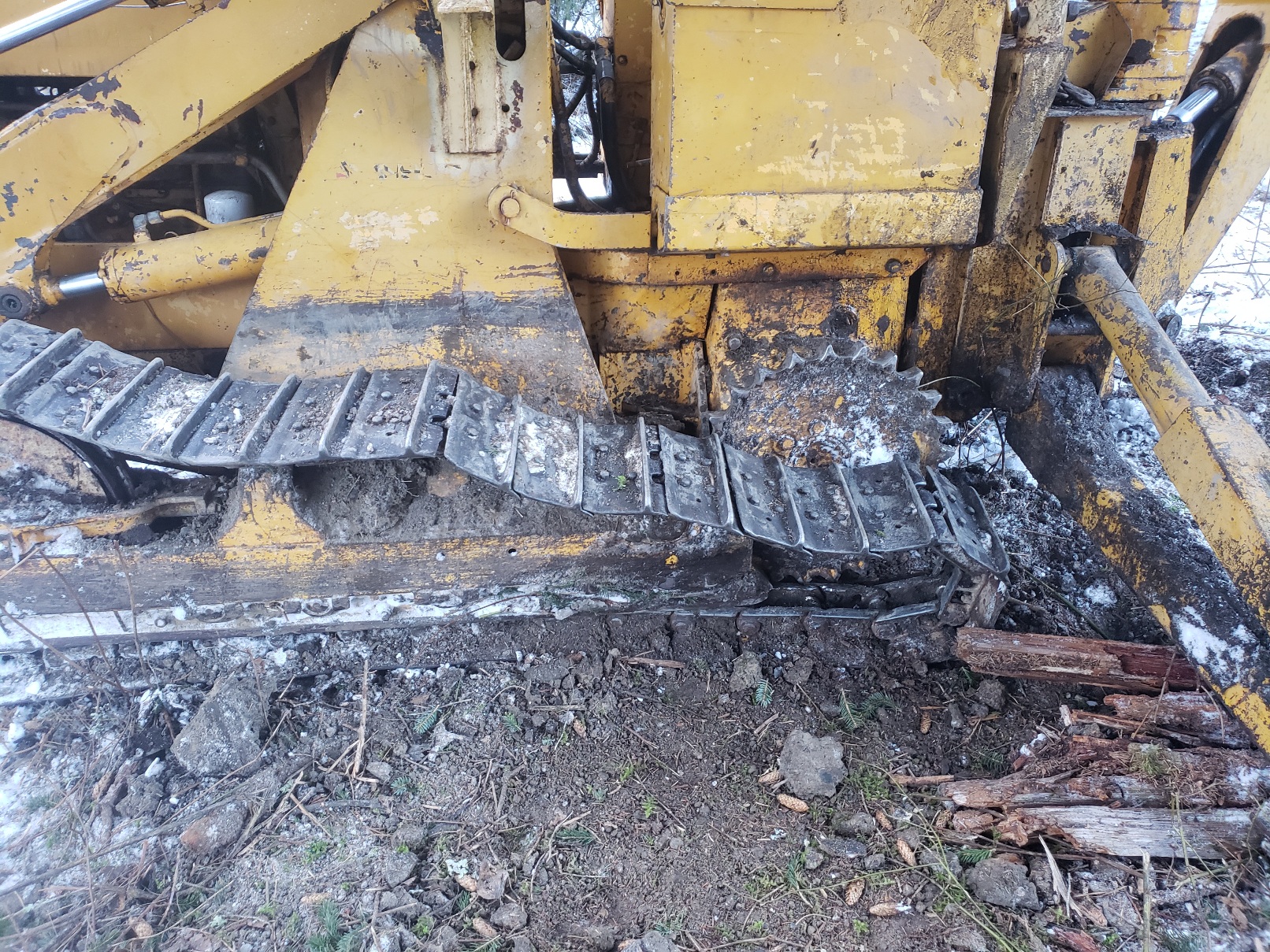

Ugh! It's only been a couple days since I finally fixed my coolant issue that put my machine out of commission for a couple months, and now this!
I was making a hard turn in place (one clutch pulled and brake applied) and about halfway through the turn I hear a loud clunk and stop turning. A quick look over the side and sure enough, the left side track popped off!!
I tried for a good couple hours, pushing and pulling, using a long pry bar, looking up videos on YouTube, trying to use a chain on the boom of the hoe to pull the track up and over... Nothing doing. I cannot for the life of me get any of the teeth into any part of the track with enough purchase to try to just drive it back on.
I'm feeling very discouraged. I could use some advice on the best way to go about getting this thing back on. Thankfully since I have the backhoe on it, I have the boom as well as the side stabilizers at my disposal for lifting.

First thing is to back off the track adjuster

Track is on (positioned) backwards, btw. Not sure what the strategy is in doing that, but have seen it done a few times...

I’ve always had better luck getting it on the front. Take it off front idler and put it on the back and walk it back over front idler. I’ve never gotten one to climb over sprocket.

If it were me, I'd remove the track from the machine and as mentioned, back the track adjuster off all the way. Use a bar, come a long, or another tractor and chain to pull the track adjuster or idler assy. towards the back of the tractor. If this doesn't move back easily I'd make the needed repair while it was apart. Get the track chain back around the drive sprocket, then the idler, and finally bring the tension back up on the track.
I don't know your tractor series at all but are the red circles with yellow arrows cracks, or breaks? Something doesn't look right to me from this vantage point:

Good info so far.  Getting track back on it pretty much "bull" work.  Sometimes you can get them to flip back on, sometimes not.
If you haven't, you might want to look at the condition of the flanges of the track rollers while you have it up.  If the roller flanges are bad/gone it will affect chain tracking to the sprocket and idler.  You also need to maintain proper track tension.  Single bar grouser pads can be harder on things when run on loaders and backhoes, than the three bar pads generally found on such machines.  And I would agree with the track is on wrong, grouser end of the pad should hit the ground first during forward travel.

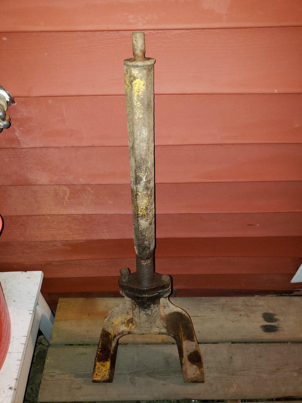

Alright. So, a buddy came over to give me a hand yesterday and we tried our best but unfortunately we couldn't manage to get the track back on. We were able to lift the machine with the backhoe stabilizer and get the track fully on the sprocket, but we just couldn't get it over the front idler.
The main reason for our lack of success was that we couldn't bring the front idler back at all. The track adjustment screw is old and rusty and might as well be welded at this point. We figured the only path towards success involves freeing up the screw somehow so that we can retract the front idler, so we spent the remainder of our day taking things apart in order to remove it.
So now I'm looking for tips and tricks to free up this screw. We already tried penetrating oil, heat from a torch, and whole lot of torquing on it, but no luck so far.

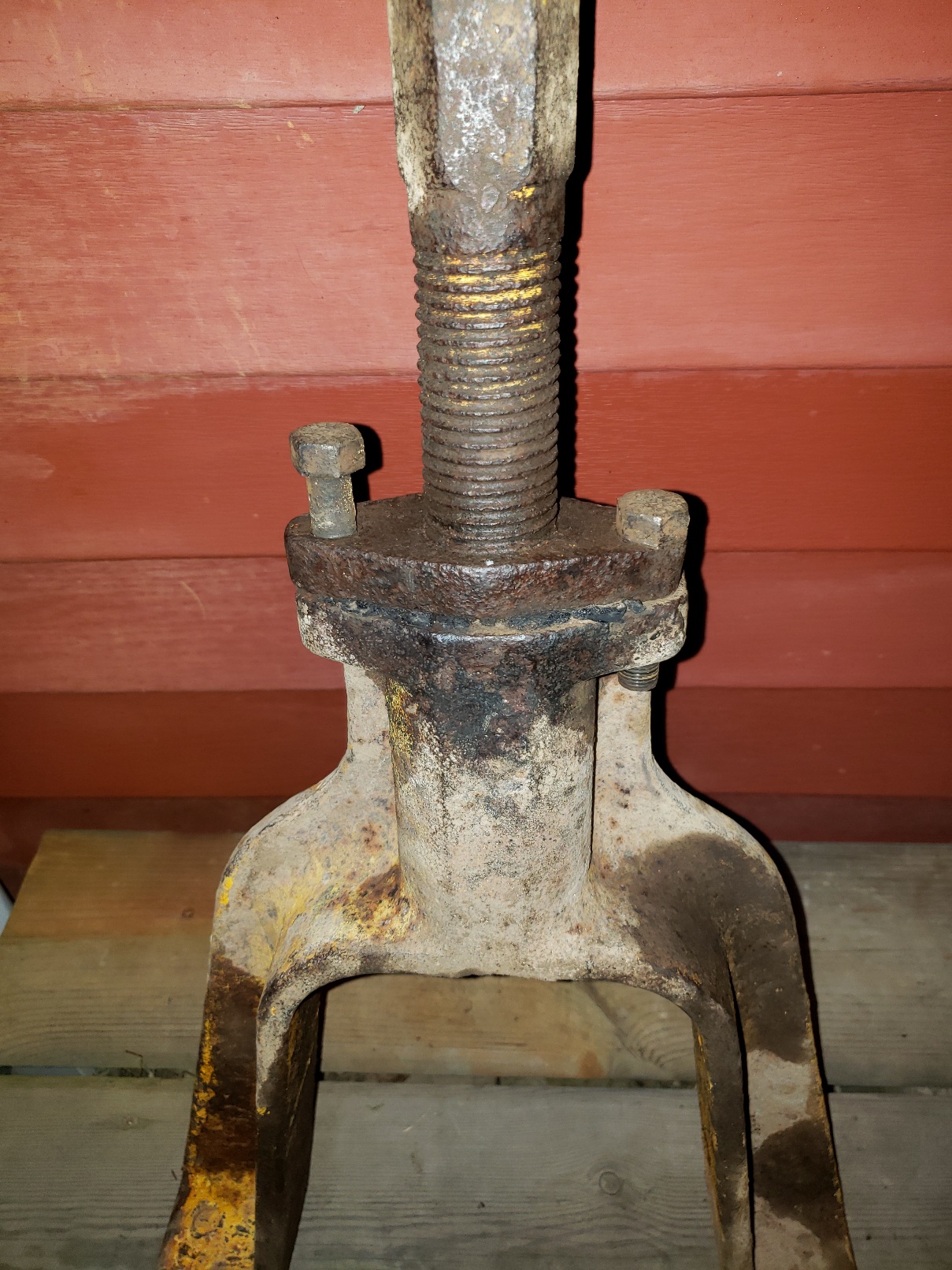

First you need to get the lock plate bolts out.

Sorry, they were fully out when we were trying... That's why one looks half out. I put them back on when we quit for the day. When the bolts were out, the plate wouldn't budge.

It doesn't look cooked enough to me. Need more heat.
Is the yoke threaded through or is it a blind hole?

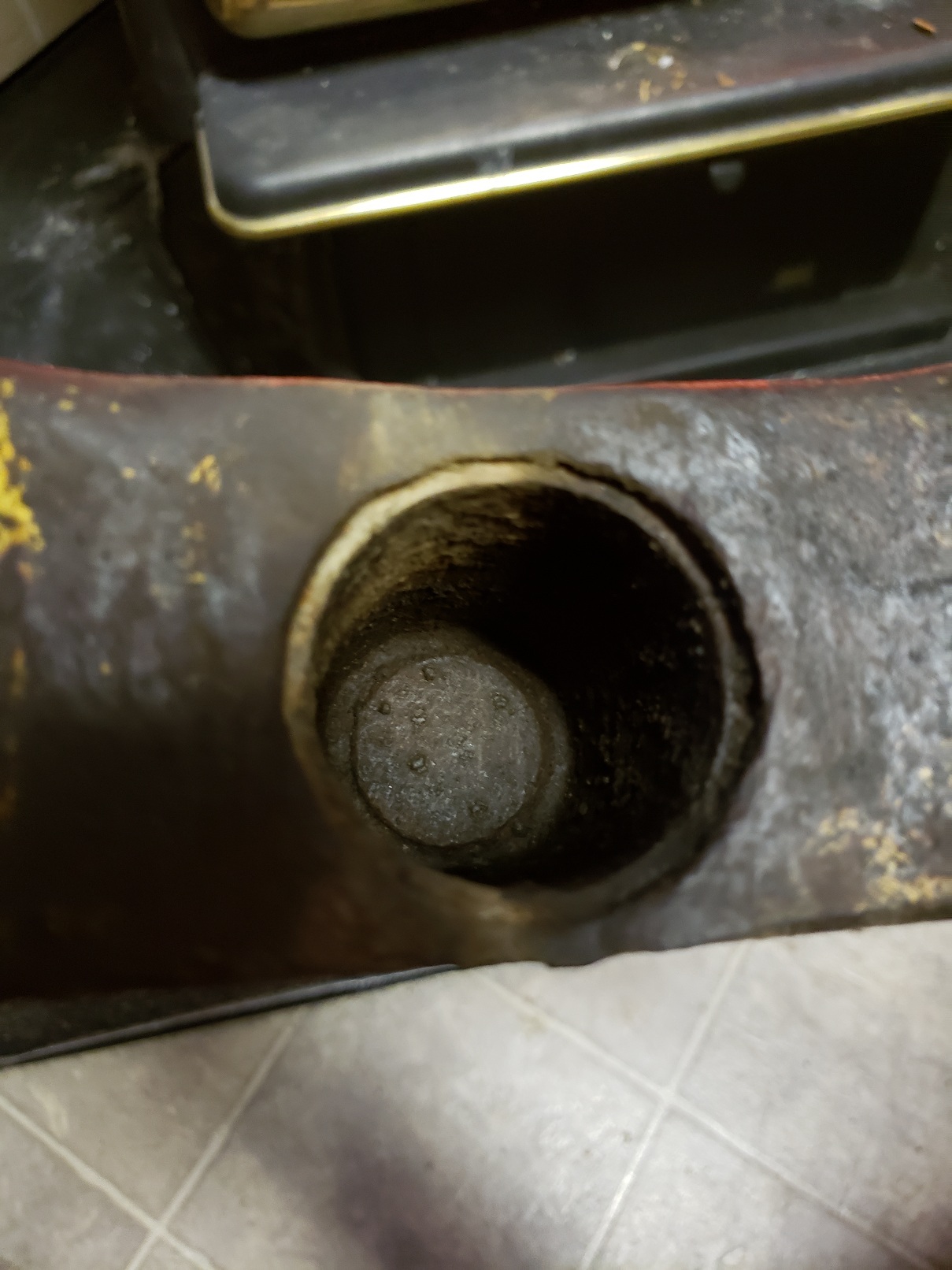

Looks to me like the shaft hole is threaded just about half way through.

What I don't know is whether or not the lock plate is threaded onto the screw as well? Also what's the point of the rubber seal between the lock plate and the yoke?

Fires thing is that collar with bolts through it needs to be loosened . Take both bolts out of it and turn it separate from the yoke - then work on getting shaft to turn in yoke .
 Heat and a lot of it might be needed - in like almost red hot .

Remove the cap screws from the adjuster.  Get a fire going in your wood stove or firepit and make sure you get a nice bed of hot coals.  Put the threaded portion  on the coals and heat till dull red.   Proceed quickly to a vat of waste oil and immerse past the threads.   Make sure you use protection to avoid spattering of oil near your face and body.   This method will cause a violent reaction but will free the adjuster for repair.
I know for a fact that this method will work!   Good Luck ~  Orangeman
I forgot to mention, those red circles aren't anything broken or cracked. They're just natural gaps and seams in the plates and frame.

SUCCESS!
A buddy came over to give me a hand again, and with his help we were able to jury-rig a "vise" of sorts to hold the yoke on the floor of my shop (just built up a frame of 2x4s around it screwed down into the floor joists for strength). With the yoke 100% immobilized, we were able to use penetrating oil and heat from a tiger torch, and broke the rust-weld of the locking plate by tapping it slowly with a hammer. Once that was free to move, we were able to use a pipe wrench with a long pipe extension over the handle for leverage, and we were able to break the main shaft screw's rust-weld as well. We worked it all up and down with copious amounts of oil to get things mobile again, then took it down to where the HD4 was stuck.
With the shaft fully retracted, getting the track back on was a piece of cake! She's back in action. As always, thanks again for all the tips and advice.

Also, with the track adjusted, how much thread is left on the screw?  No threads left, and the track on backwards is a good indicator that the UC is wore out!
There's actually lots of thread left. As you can see in the one photo where I'm looking down the hole in the yoke, the threaded rod is still fully within the threads in the yoke (what I mean is that the end of the threaded rod protrudes past the threads in the yoke and into the unthreaded part of the yoke when it's adjusted for proper tension).
