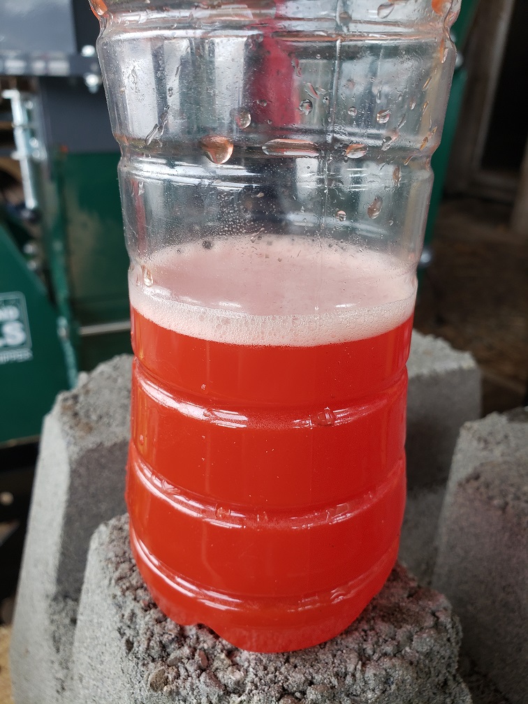

Hi Orangeman,
So I did the test in your link and after shaking the bottle, the foam/bubbles stayed for a lot longer than a minute. Here's a pic taken after 10 minutes of it sitting:
You asked if the antifreeze is reddish in colour... yes it is, straight from the bottle. It was a concentrated diesel-specific antifreeze that I diluted to about 50/50.
After doing this test with a bit of the coolant from the system, I did the test again on some leftover pure antifreeze I had left. I mixed it 50/50 with the same water I used for the mix I did for refilling the system, and that test came up with no bubbles after less than a minute.
So at this point, based on the link you provided, it would appear there's something contaminating my coolant after it's put in the machine.

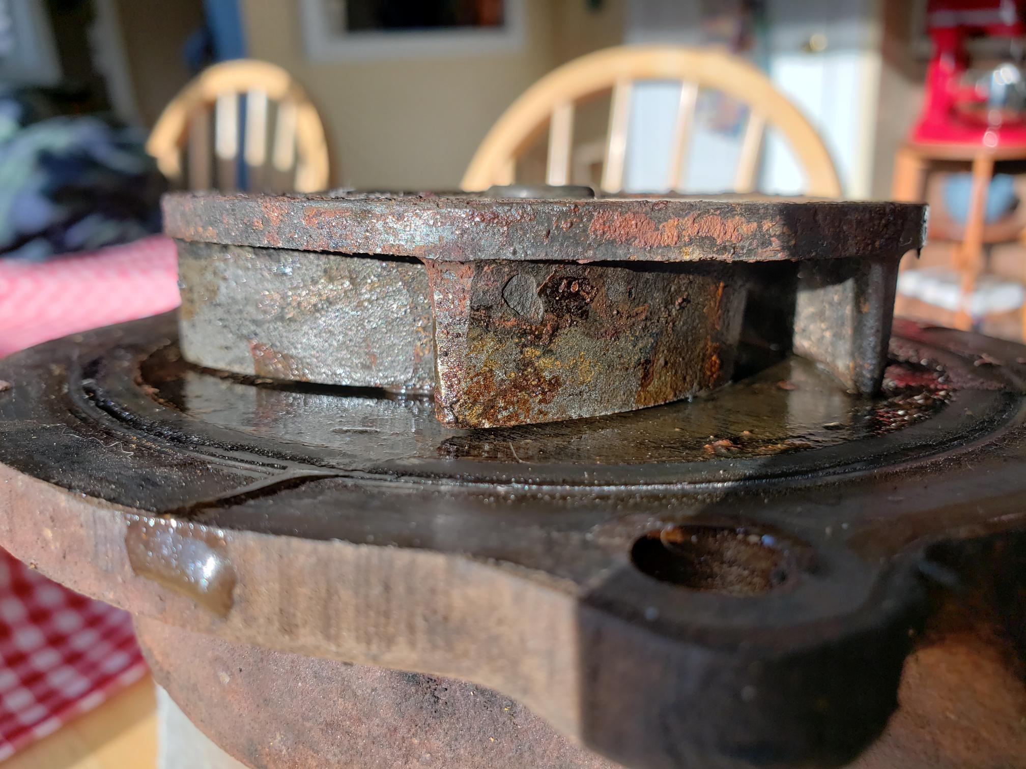

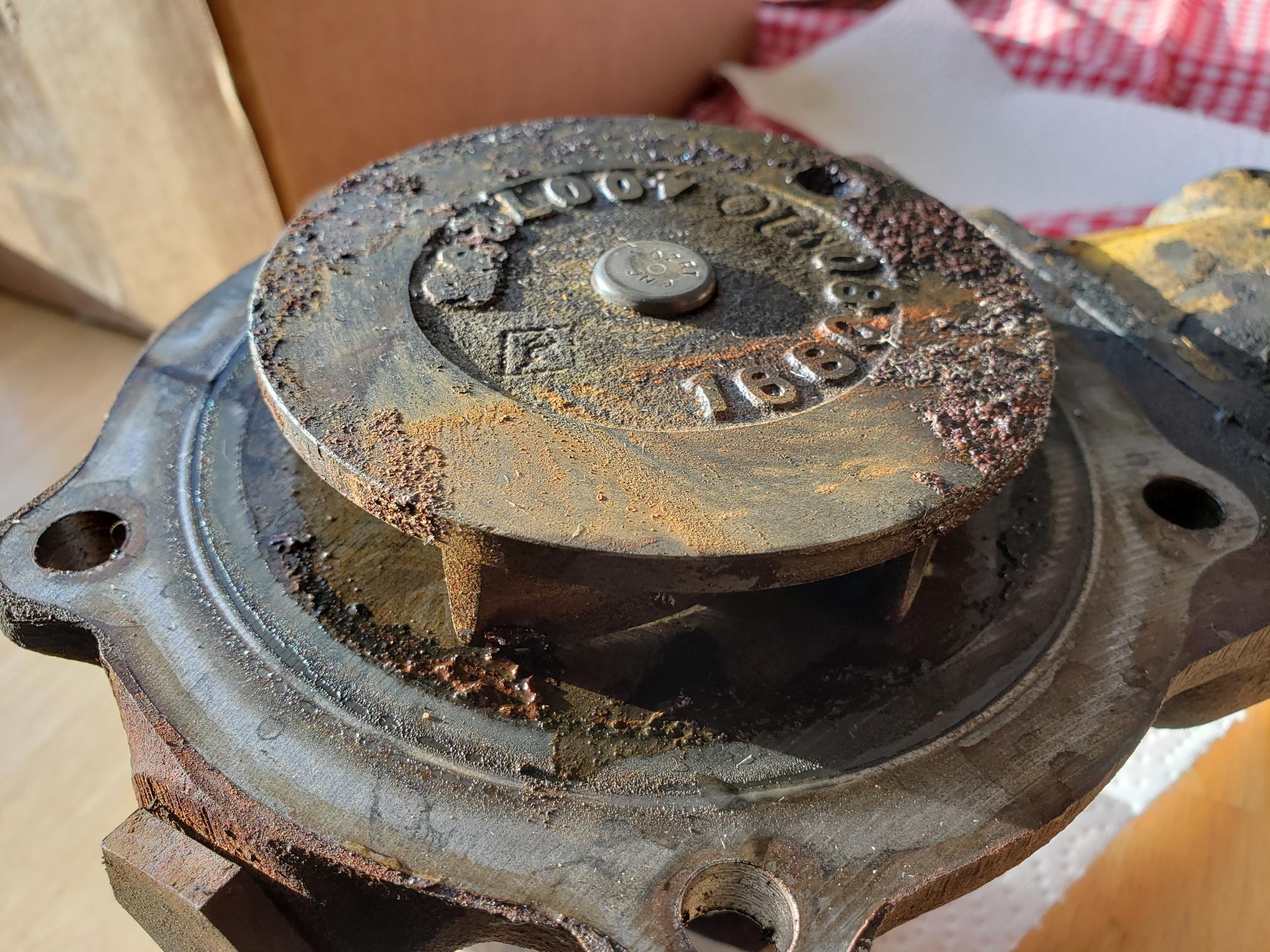

Ok, I've pulled the water pump off but I'm not 100% sure what I'm looking for here.
As you can see there is a fair amount of corrosion. When I bought this machine I knew it had been sitting for a while so I made a point of doing a fluid change on her, drained and refilled everything with fresh stuff, including the coolant. What I DID NOT do in this initial servicing, though, is completely flush the coolant system... I just drained it via the radiator petcock and added new fluids.
When this foaming issue started out of the blue, I drained the system again more than once and flushed out with water, then I TWICE ran a coolant system clean/flushing solution through before adding the new orange coolant that still foamed up as per the photo I posted earlier in this thread.
SO after looking at this water pump I can see that unfortunately there is still a lot of corrosion in there and I'm not sure what to do about it. Perhaps this foaming issue is residual corrosion/coolant system flush solution in the system because I haven't gotten all the junk out yet?
As for the pump itself, despite the corrosion it look okay? I mean the impellers all look fine to my eye, none appear to be chipped or broken. I do wonder about the gap between the impeller blades and the surface of the pump body though... is it supposed to be that wide?
Do you folks think I should still go ahead with getting a new water pump, of do you think this one still appears serviceable as long as I get the corrosion under control? Any tips for getting as much of the corrosion out of the remainder of the system as I can? If the water pump looks like this, I worry about what the coolant channels in the engine block are like.
Thanks as always for any advice!

The water pump shaft seal COULD be drawing in air and causing your problem. If there is no overheating (a working temp gauge ??) I might just replace the pump and get on with life. If you'd tie a gallon milk jug on the radiator overflow tube and actually catch what is being vomited out, maybe you are simply overfilling the radiator  !!!   You cannot have the radiator clear full when cold....must be down at least 2 quarts from full, maybe 3 quarts.  If the vomiting never stops and you get to a gallon or even more, you must be getting compression into the coolant when working the engine. There are test strips to verify this scenario.

Thank you for reporting back with your findings, and status or your repairs. It is quite annoying to attempt to help a party with troubles, and they don't follow up with closure; only to show up with the next problem.
From the looks of your water pump photos I assumed the cooling system status matched pretty closely. Seen that far too many times through the years to not consider the total package when looking at repairs.
