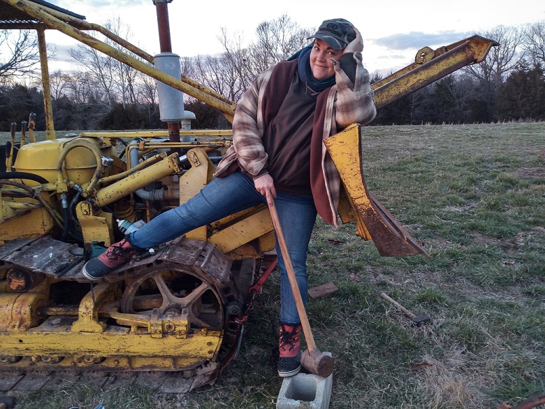

I agree on the tonnage and I won't buy one and don't want to make one
I applied some heat to see what would happen but no dice yet.
My helper even got in on the act.
I'm wondering if sawzall blade will cut this pin and I'll get another.  It's got 1.25" pins.  I'm thinking I could come up with a new pin of some sort.
