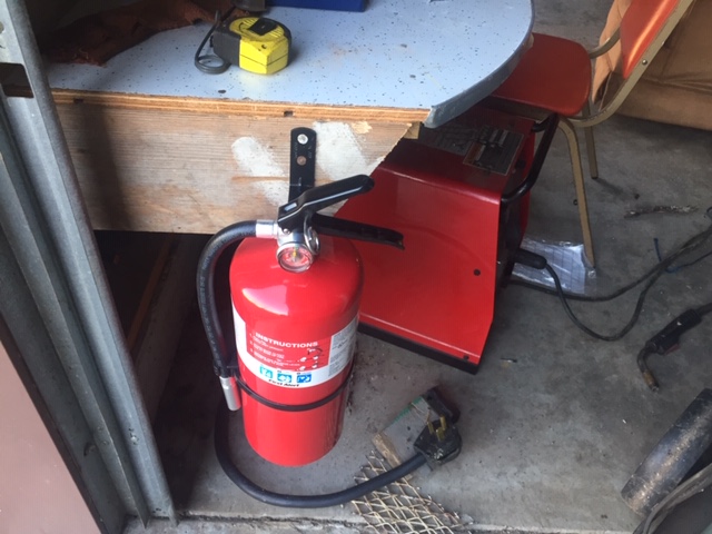

Oh Man were you lucky! Thank goodness you weren’t hurt as well as your tractor.
I almost lost my Bobcat Skidsteer a few years that way. Was out to the barn which has no running water when, while using a cut off wheel set off a grease fire in the belly pan.
Had a large extinguisher on hand and got it out but it was a crazy few minutes.

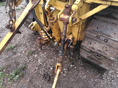

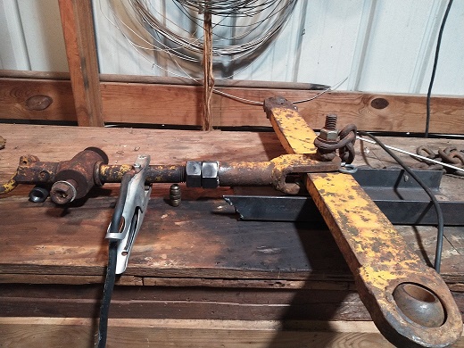

My adjuster is stripped out, was this type of three point arm used on ag tractors?
HD3
Points: 35552
Post Options Post Options   Thanks (0) Thanks(0)   Quote DMiller Quote  Post ReplyReply Direct Link To This Post Posted: 21 Apr 2019 at 12:19pm
Looks similar to those used on 170/180 series, likely S IV ag lift arm adjuster.

Take it off and wander down to a tractor place.  Probably easily replaced.  Guessing it is probably Cat 1 3 point stuff.  The idea of a crawler with a 3 point was always cool to me.  if I could put a 3 point and a 540 rpm live PTO on my HD-6, I would have a hillside flaiil mowing machine unlike any other.  Be able to mow up and down stuff no tractor could dare.  I think only International was the other company with 3 point's on the back of crawlers but I could be wrong.  But yes I suspect your adjuster is either common or a replacement can be readily adapted to work for you.  May have to play with bushings/spacers or drill a hole out here or there but it should be doable.

I pulled it apart
The male threads will clean up some but the female is toast.  I'll try hardware store nuts to see if the threads match and if so make a new bottom piece.
Or weld it all together.

Glad your machine didn't get to really burning.  I was welding a rear view mirror bracket on my JCB skid steer loader when something started burning under the floor.  Found a spark started the greasy rubber cover of the foot throttle on fire.  Got it out ok but the cable housing was bad and had to spend a hundred bucks getting a new one, expensive lesson!

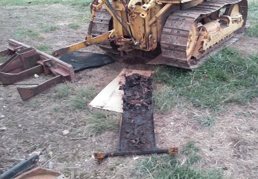

I'm going to hold off welding until I drop the pan and clean out but I got this the next trip to the farm>

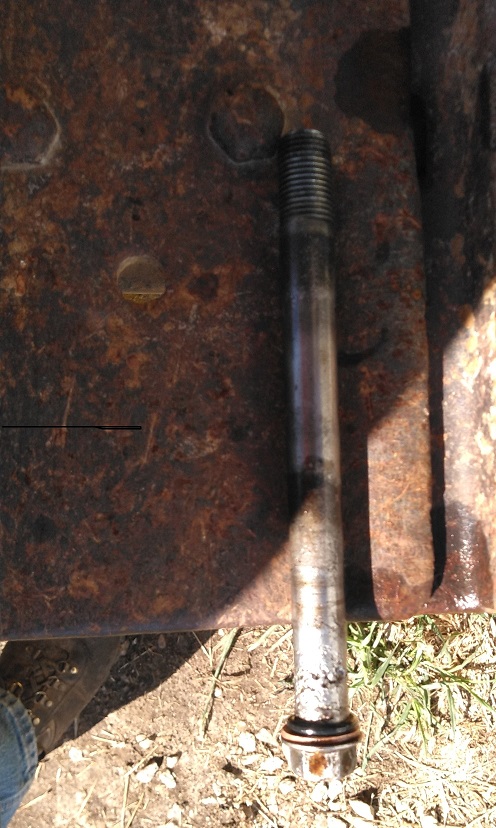

The local dealer couldn't help so I contacted Sandy Lake as they support this site but no filter parts.
Does anybody have one of these around they would part with?
This is the thru bolt of the filter
Does anybody know what kind of gasket or washer intended to go on it?

I'll clean this out and finish my welding
The PO had routed two hydraulic lines improperly causing them to get cut so I can get some new and stop the mess

That happens,, using water on a fire like that with all the flamables around could've been bad! As in spread easliy

I found 1 1/4 inch nut with 7 threads per inch to fit the adjuster arm
It works now
Previous owners had made new brackets where the arms mount to machine.  They used a torch for the holes and they were sloppy loose.  I reamed them out more with the torch and installed some bushings so they would fit the cat 2 pins.

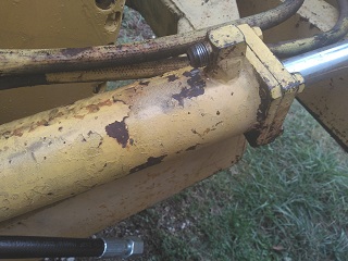

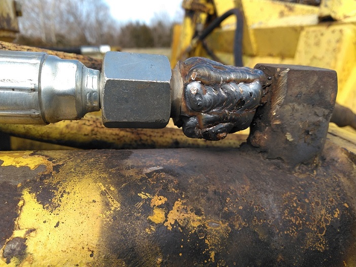

I got 2 new hoses to put on to fix the ones mentioned above.  Had to remove some others to get at them.
One wouldn't stop leaking at the fitting so I got the pipe wrench on it. Look what I did............
Flattened those threads out real good.
At least its easy to get to.

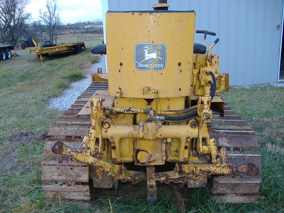

Re "I think only International was the other company with 3 point's on the back of crawlers but I could be wrong. "
The Fiat Agricultural series had both.  They are in demand here in Oz for hilly hobby farms, as they are and have still have spares backing.

I had a 1010 John Deere with 3 point.  A PO had torched the pto shaft internally to do a repair without removing so much stuff.
Here's the original nomorejohndeere
Don't walk......run

I drained the oil out since I have the belly pan off.
According to this I need about 15 gallons of oil to refill the various compartments.
They all call for 10w-30 oil.
I'm assuming motor oil?
It makes no mention of hydraulic vs engine oil in description.

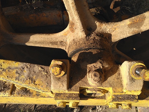

I removed guard from front sprocket and found this:
Anybody have a front sprocket with good internals?

 That front idler may have a bushing in it that can be replaced. If it doesn't, it could be bored out to take a bushing.

I've soaked the pin with juice and smacked around on it a bit but no dice yet.
Chained a ten ton jack up against the pin and stalled it with no luck.
Removed the pad on the master link for better access.
I'm thinking about cobbling up a mount and using the rear 3 pt. hydraulic cylinder to push on it.........
