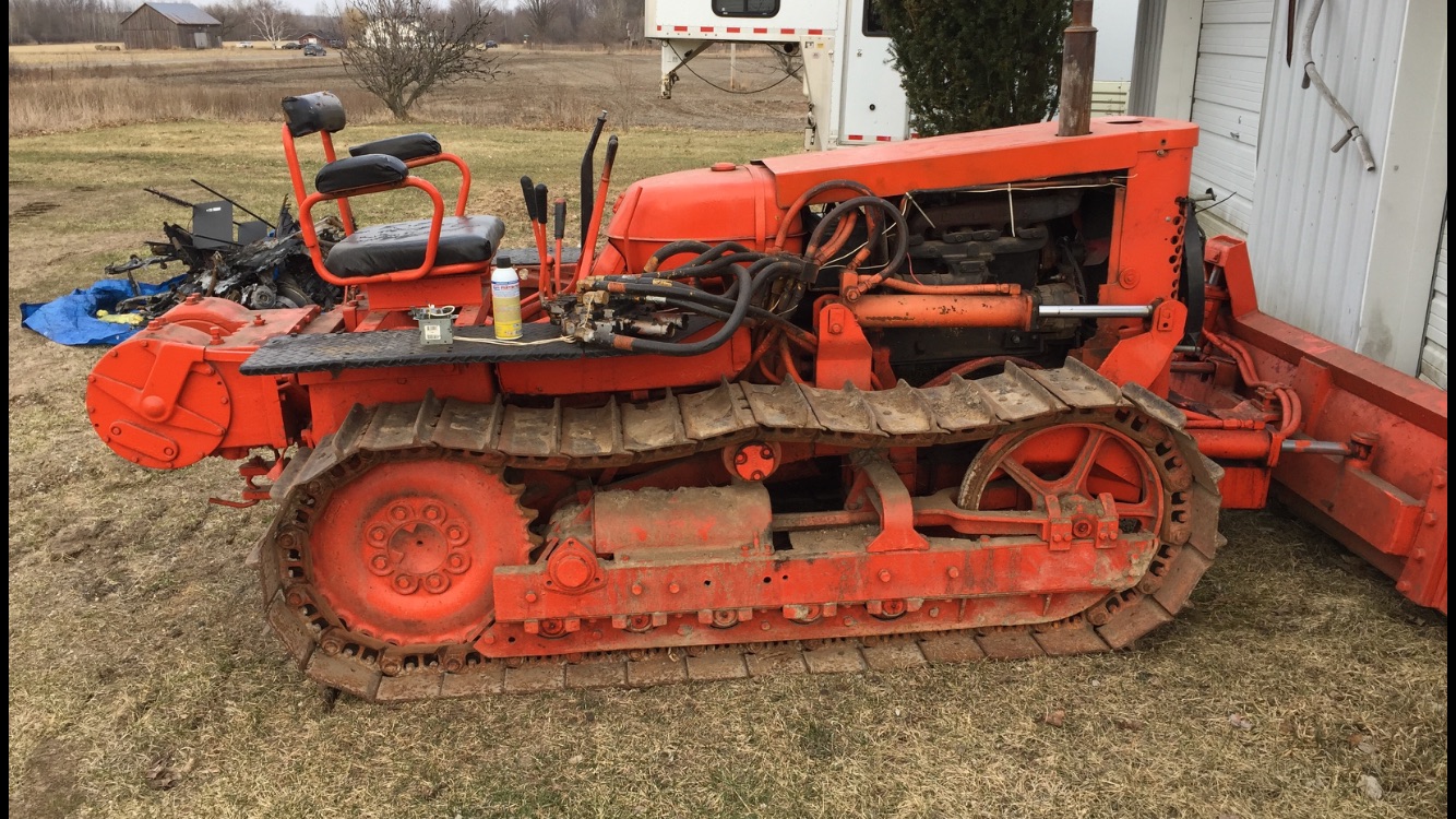

Interesting custom made hood...makes it like a bigger AC bulldozer "wannabe" :)

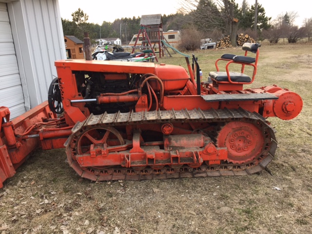

Your left track is to tight. check your manual but I think there Is suppose to be an inch and a half of slack in it. you can put a straight edge from the center roller on top of the track to the rear or front and measure the distance from the bar to the track. that will affect your left side. that side looks as though you have plenty of adjustment. to me it looks very good. right side im not sure. looks as though its a little to loose and doesn't look to be much adjustment left as the idler is almost tom the bolt that holds the sliding plate on. Oversll its a nice looking dozer. Manual will help you greatly. norm

I had a feeling the left track is too tight and the right is too loose. I also have a bad feeling that the left was tightened on purpose, like maybe it was falling off. I guess after I loosen it, I will find out.

Count the links/shoes, I'm pretty sure 1 has been removed from the left side. It's a common, temporary fix for worn chains that won't stay on and adjustment is maxed out. Wear is accelerated at this point as the track pitch is lengthened (worn pins & bushings) and doesn't match the sprocket pitch.

L= 33, R=34, by my count, but I ain't got the best eyes out there...
Your count looks good....your eyes are good :)

looks like the tracks are very worn. if you look at the bottom of each drive sprocket, the chain is coming out of the sprocket like it is out of time which indicates too much internal wear on the tracks. the chains should sit into the sprocket evenly all the way around. this will wear out the sprocket very quickly. if the top of the bushing on the track is round, have them turned and it will be back in time.
