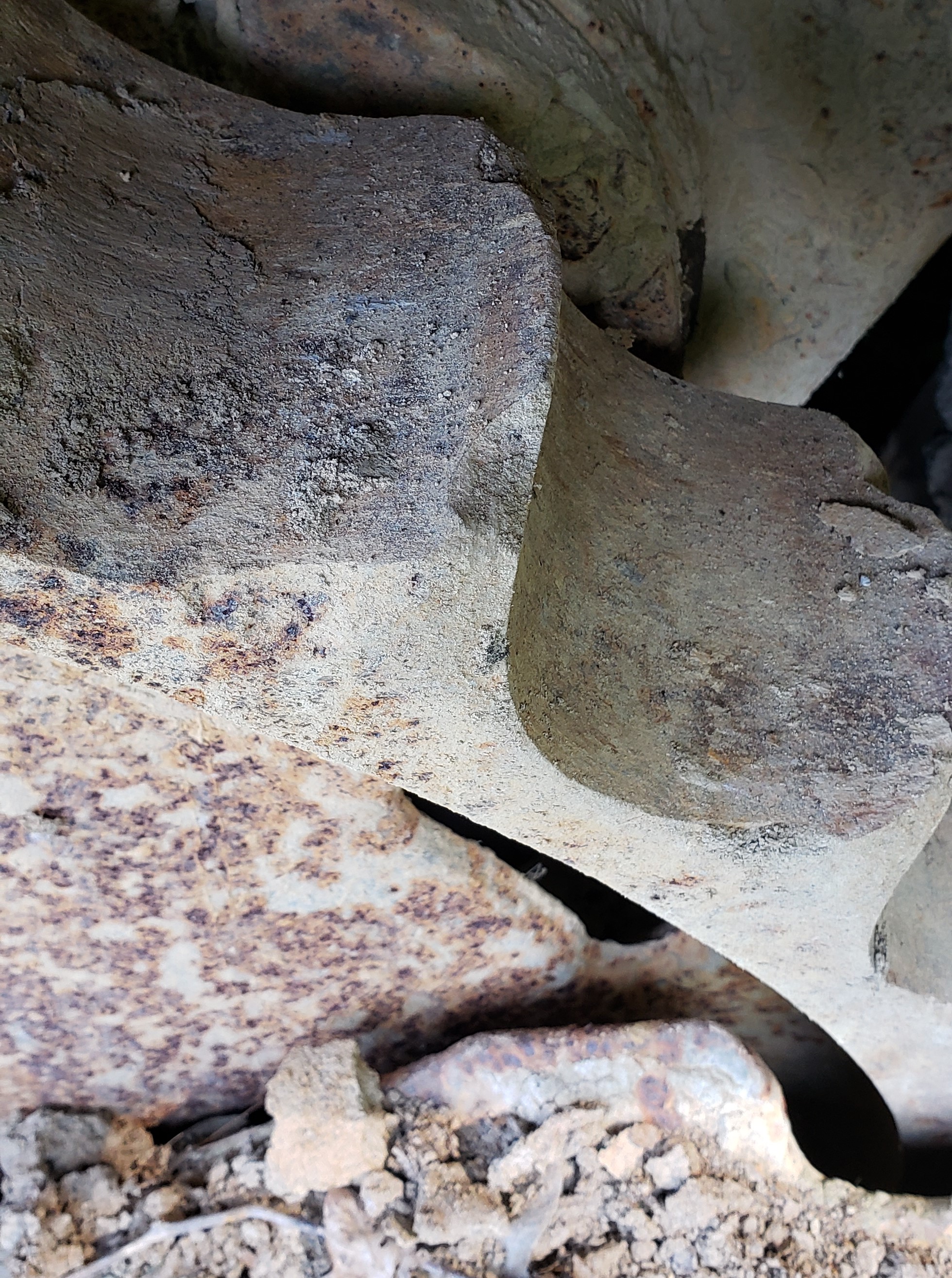

No it is not broke. Just getting wore and starting to chip on the corners.

You can build those back up but not with hardware store type welding filler metal. Post up a photo; maybe I can help.

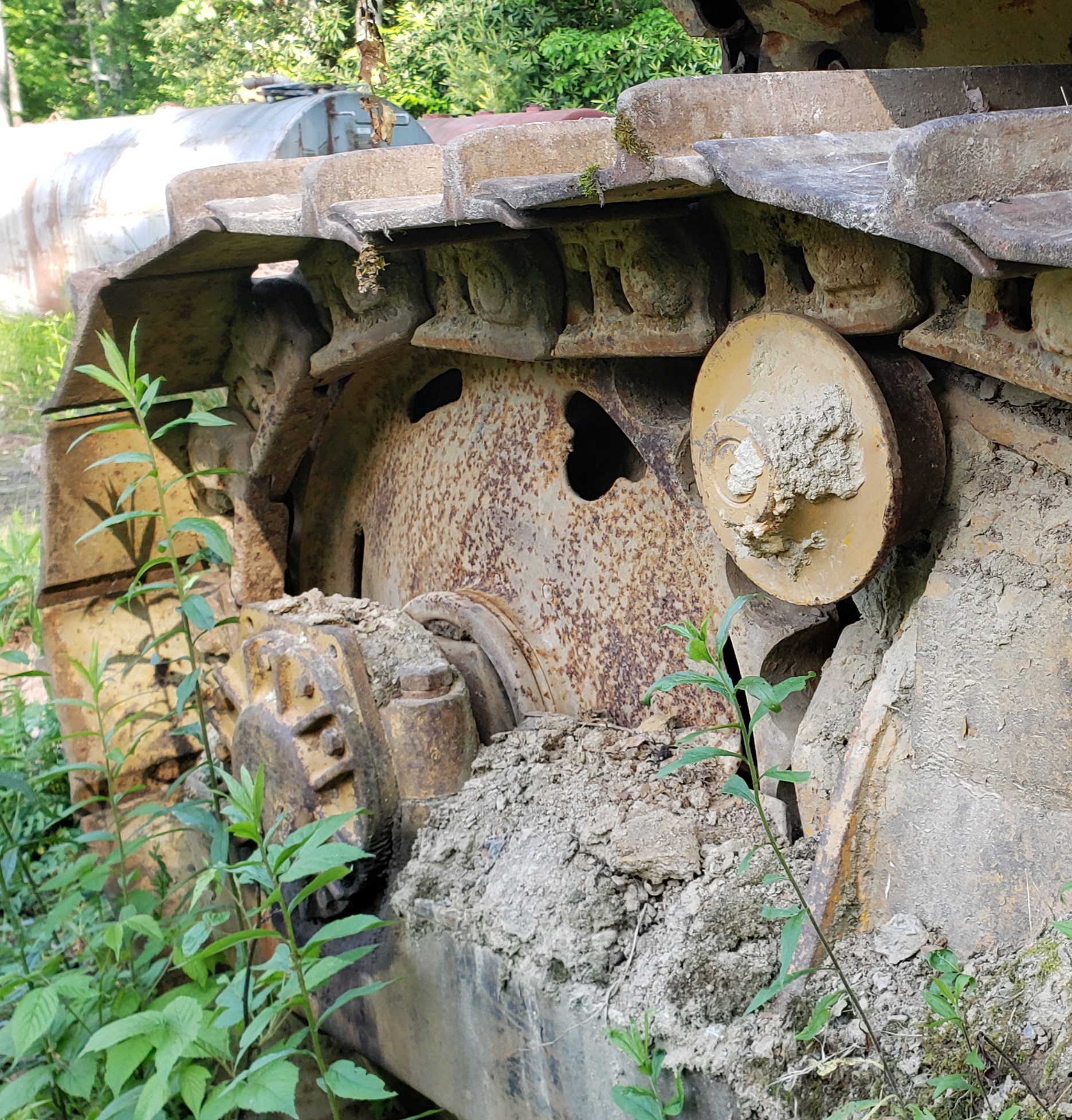

I just popped sprockets on and off of an older 21A I think they were and a couple may be surplus to the owners needs. They however are the spoke type sprockets from an earlier tractor than this one.
I would like to see photos of the worn sprocket to ascertain path. That is probably an early 70's series tractor. If so it should have bolt on segments to the rear sprockets.

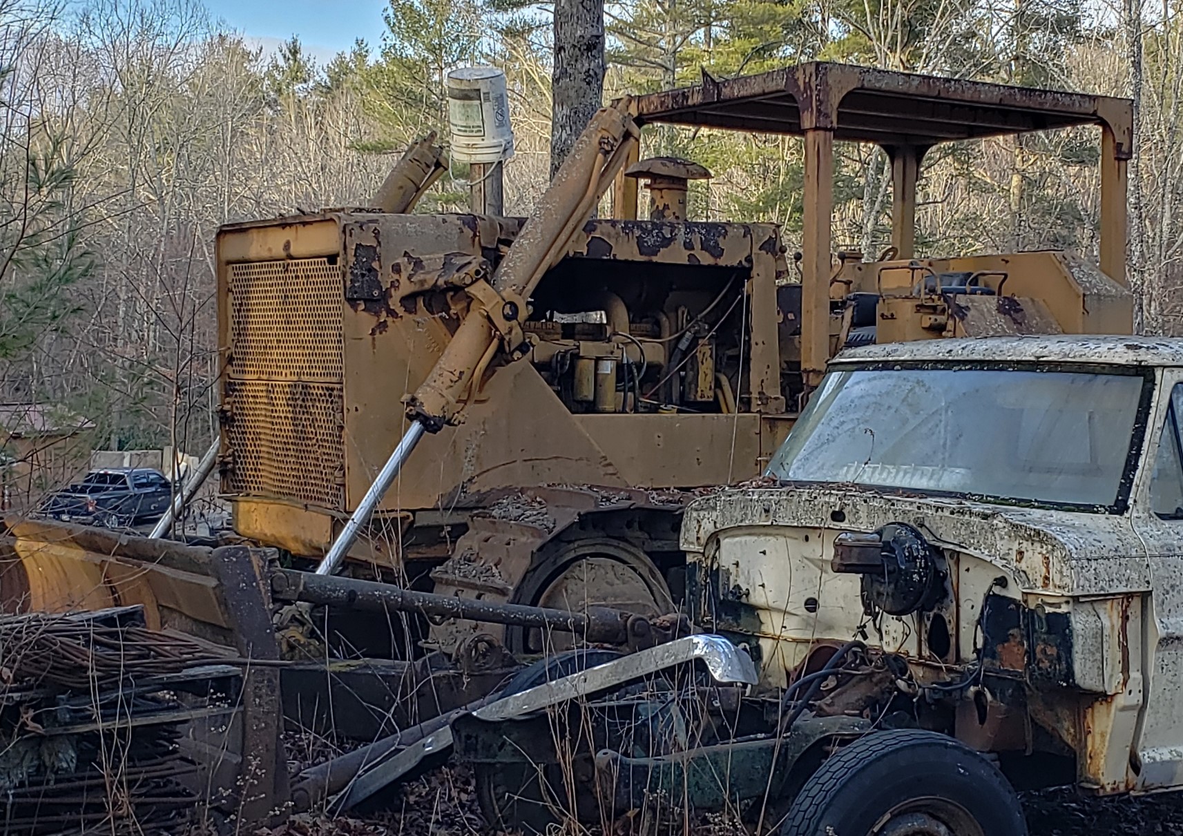

I thought the "P" models were mid 1960s and had the rounded front nose like the HD21 ?
About 1969-70 they came out with the 21B and it had the square nose.... ?  I agree, this looks like a newer model..

The owner said he thought it was about a 70. I cant tell from anything the internet has to offer. The numbers on the tag are as follows:  HD21P-16018, MODEL 2100MKII, ENGINE CATALOG 4390467,
21-10041

To me that tractor appears to be a 21B series of the early 1970's with an older undercarriage installed. Many of the parts were interchangeable between the P and B series IIRC. That top roller, and the sprocket I feel is older than the tractor.
I see the one chipped tooth on the sprocket. If this is the worse case scenario, run it some more. The gullets, remaining teeth, rail height, and shoes look to have quite a bit of service life left to them. That top roller is showing it's age however. Probably a hodge podge of parts to keep the old girl operational but that's what it takes sometimes. I'd wager it's a pretty good project and not really for the feint of heart as some of this stuff is damned expensive to work with if you cannot perform many of the tasks yourself.
Tractor serial number should be on a tag riveted to the firewall and stamped into the right side finals casting, or one the rear of the finals casting, (still on the right side). That would start to drill down to what the tractor actually is.

I am not much of a welder but I can see now that I am going to have to take it up and learn it well. A fellow that messes with older machines and keeps them going said he thought putting weld in the sprockets would give it plenty of life. I am pretty ignorant about these types of things and have trying to get the right ideas from the right people

A good machine shop can fix the sprocket if not bolt on teeth.. They just need the pitch and chain bushing size. Weld it up and hard cut it. Not that hard of a job. HTH Tracy
