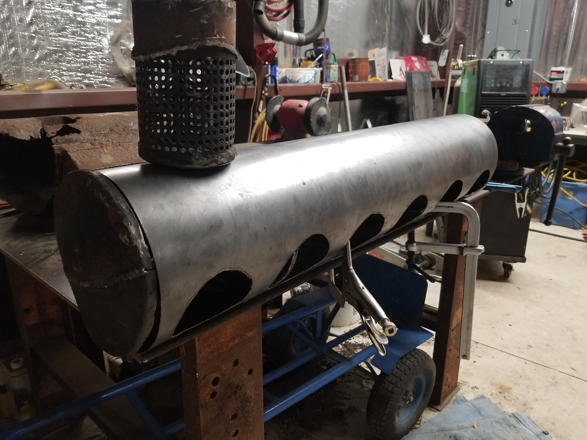

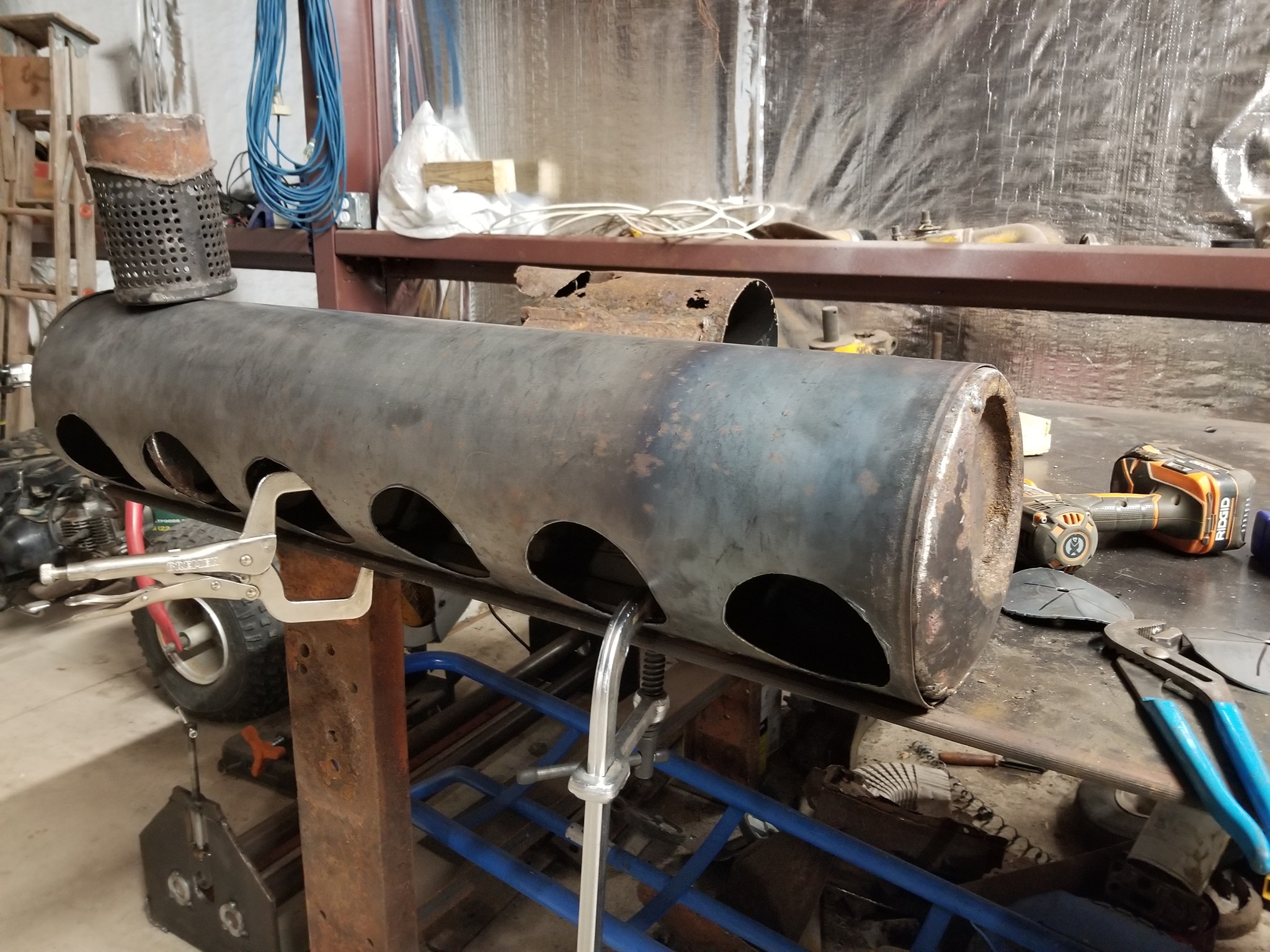

I have finally gotten something accomplished after having to put this crawler on the backburner for a few months.  I got my home made metal roller done and promptly tested it out.  I made some reinforcement rings for my air cleaners as they had been impacted in the past (falling tree?  hood is dented up also)  and had a few rust holes i had to braze shut then pound out some wrinkles and dents.  This way i can clamp them and not worry about crushing them.  I also rolled out the new tube for the exhaust manifold.  Now i can cut the ports out and start laying out the runners.  The inner tube i was able to reuse as the 6-110 left some rust protection.  The rest was shot, some remnants on the far left.  I am also working on some new steel mesh as this is the best piece of the 3 installed.  One was completely gone and replace with stainless dish scrubbing pads.  I have shared a few things on the FB  AC crawler page as its so much easier to deal with pictures.    I am also looking for 2 liner kits for the 6-110.  I have 4 would like to complete the set, just in case.  DD#  5195662  And a set of liner sealing rings (fire ring).  the rubber parts are available.  Edit.  Forgot to say this is 16 gauge sheet.
