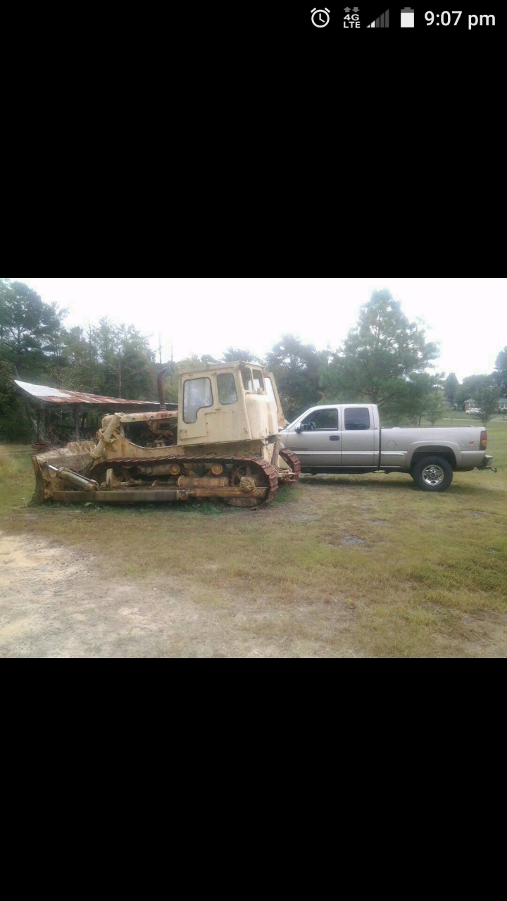

Hi, I am new here and would like to ask if someone could give me an idea of when my dozer was built. The serial number on the back right side reads...HD11 B 10257. I was told it was a 1964 but would like to confirm that for ordering parts. It has the AC 10000 engine, and hydraulic assist steering. This one is a little different. It has a full cab with no a/c or heat. Any help would be greatly appreciated. Thanks.

if the 0 in the 10257, is a 6, then, its a 1971.  If it really is a 0, then it's a 1964, and not a B series...Wink

will be 64.  AC used letter serial numbers after about 1969/70 .   If it was  a  HD11 series B powershift it would be stamped 25L 16257.  My HD11ep is 46Y 14812.  And HD6ep is 88Y24869. Other late HD6s were 40M and 70C.

The B in the model name means its full width track gauge and built for industrial rather than agricultral use. Not to be confused with the series B tractors.

B in the serial number after 10, 000 also denotes dry steering clutches, and 7 roller track frame, with pre- 10,000 style track chains I think... and no turbo

Thanks for the replys.. This unit was purchased in concord Nc, and from the grandson of the owner, who had passed away. I was told it had been on the property for over 30 years. There are a few things that time has taken its toll on, that need repair, but she runs strong. It is a non turbo six speed. Is it fairly easy to find outer seal kits for the final drives?
