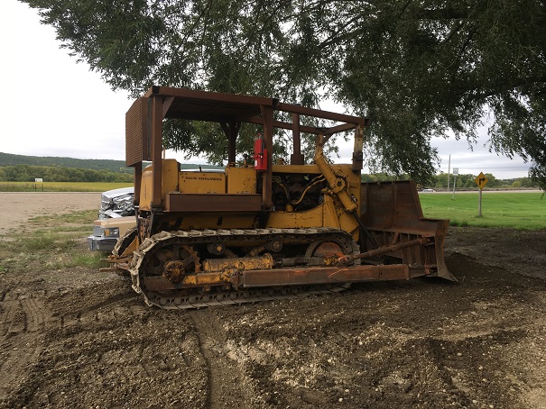

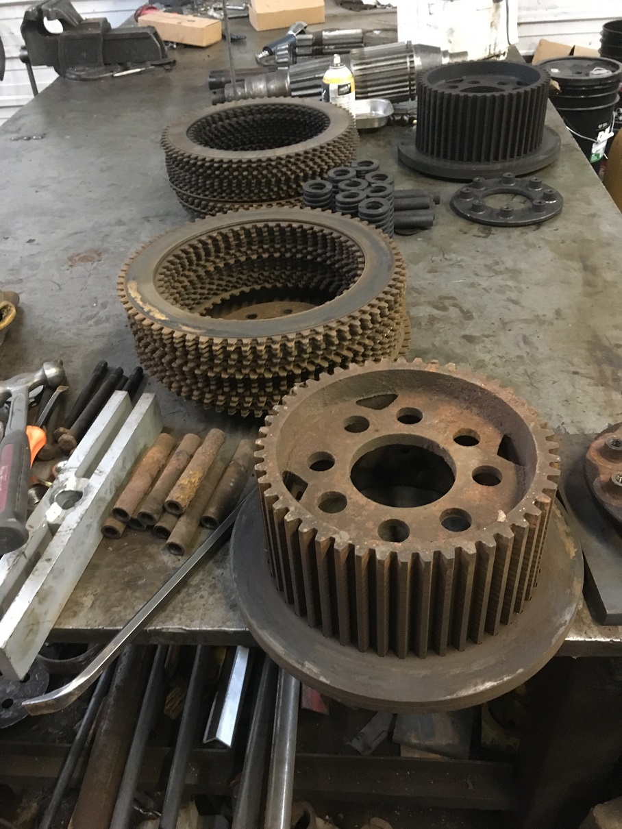

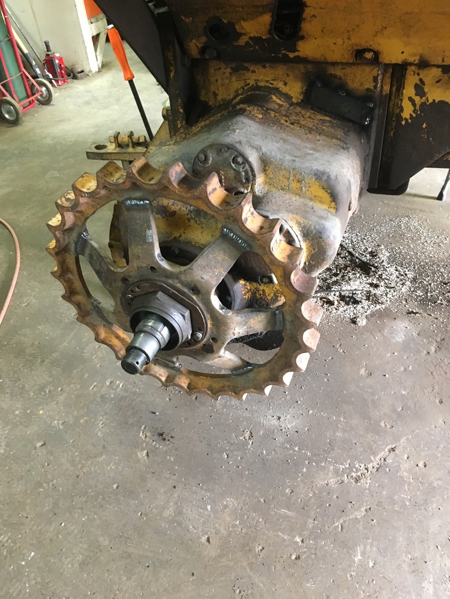

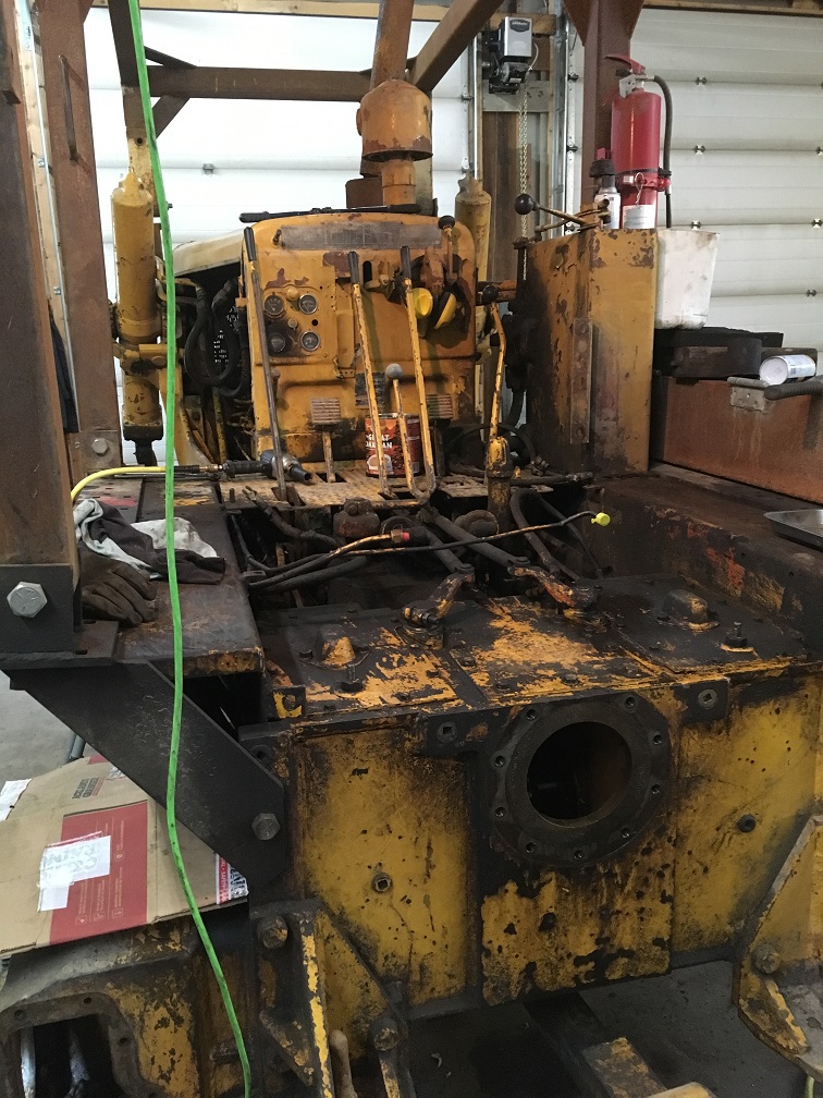

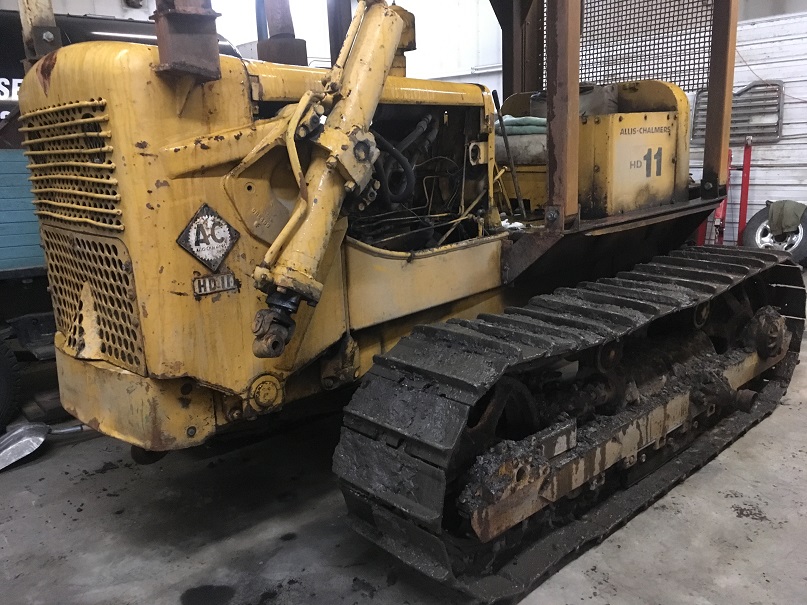

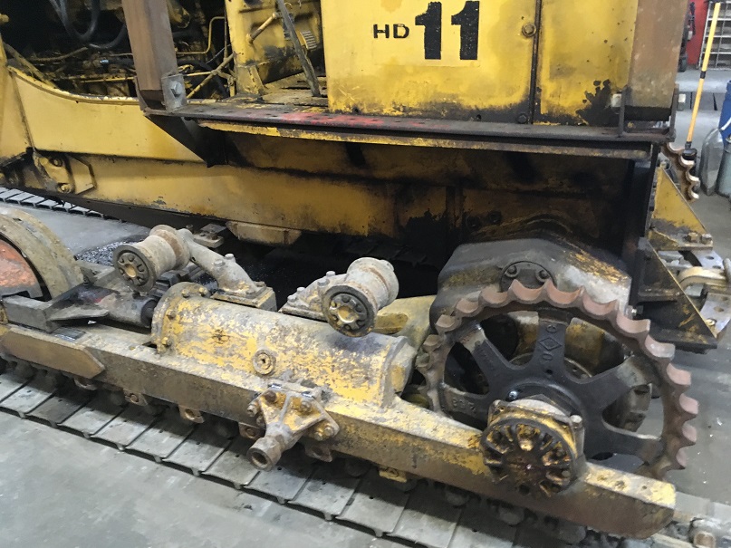

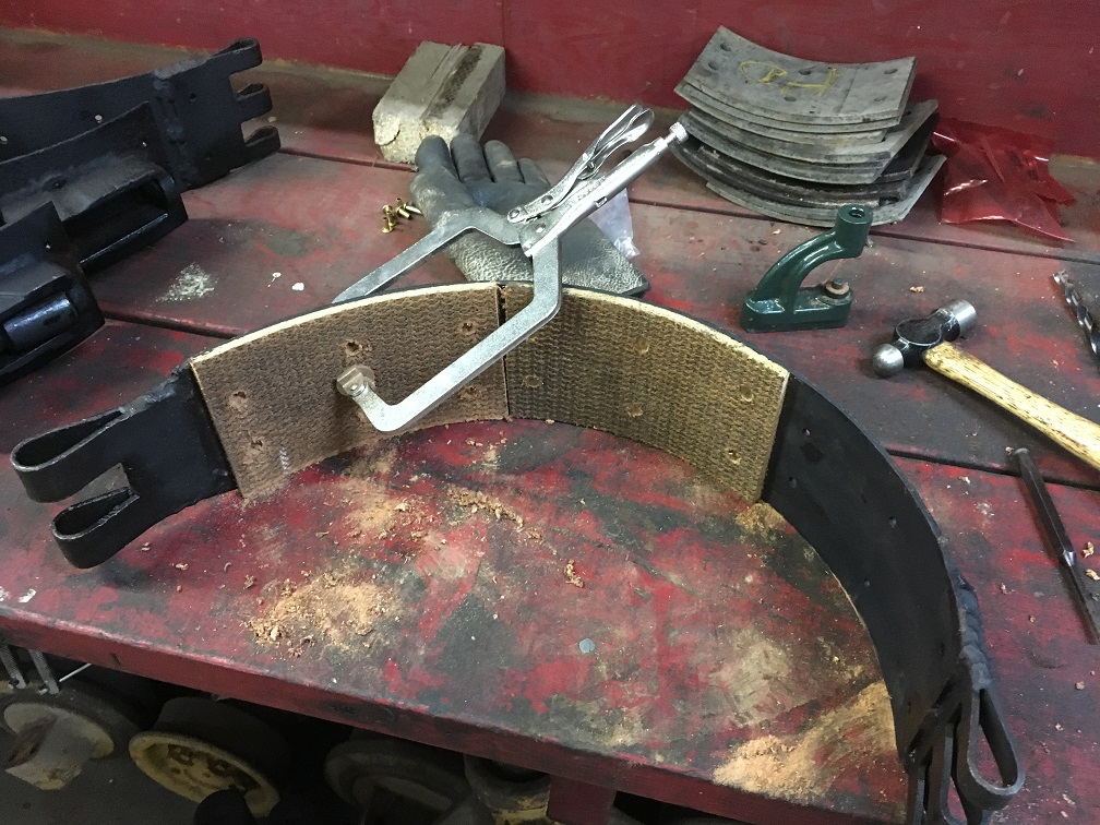

Thought I'd share a few photos of my latest project for a friend..

Looks like woven brake lining, no offense, but I see that as a mistake, it won't last very long and is extremely grabby, the hard lining behind the band is much much better. Be sure to check you rivets with a magnet unless you specify tubular brass modern rivets are  brass plated steel and they will destroy your drums
Lazyts View Drop Down
Joined: 05 Feb 2012
Location: Manitoba
Points: 632
Post Options Post Options   Thanks (0) Thanks(0)   Quote Lazyts Quote  Post ReplyReply Direct Link To This Post Posted: 12 Sep 2019 at 11:53am
Good to know Tad- I'll keep that in mind if I ever do one again.  First time for me doing brake linings- I don't know what those linings are made of, but you want to wear gloves, I got my hands full of tiny slivers! Ermm Honestly, I don't think it's going to matter much- I'd be very surprised if this machine gets more than a couple hundred hours on it, mostly done through nostalgia- if you know what I mean.
