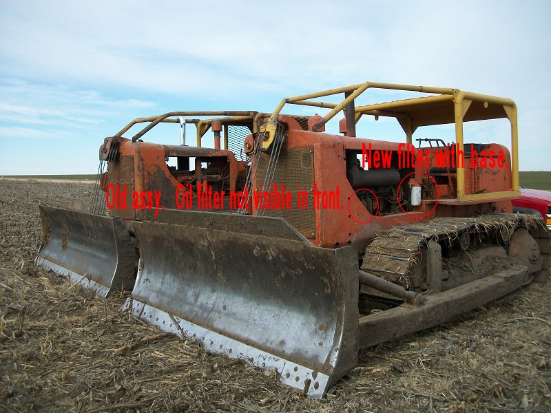

we could not get an element for dads 6-71 in his HD15 as it was part of the fuel filter housing assy.   since it was a bypass filter anyway we just order a spin on filter with a mount assy and just made hoses to connect where the original lines did.

Well finally got an old original manual for the 10. Now I see the problem. In the manual there is a photo and diagram showing that there is a primary cartridge type filter on the right side in front of the fuel pump housing and just behind the rad complete with an oil cooler. Mine has a little plate bolted over the hole painted with the original color. It almost appears it never had a primary filter. The other side is where the secondary filter is bolted to the motor in the same spot as the one on the pictured HD15. The problem with this is that according to the manual this supply of oil is not the same as what was routed to the primary filter. Having said that the unit is older than me and still has good oil pressure. Those motors must be some tuff stuff.
I am going to do the same and install a spin on on the secondary side. I am now looking for a primary housing assembly complete or build an adapter to fit another spin on with an oil cooler for the primary circuit. Any done this or know where I can get the original housing assembly for the primary filter?
