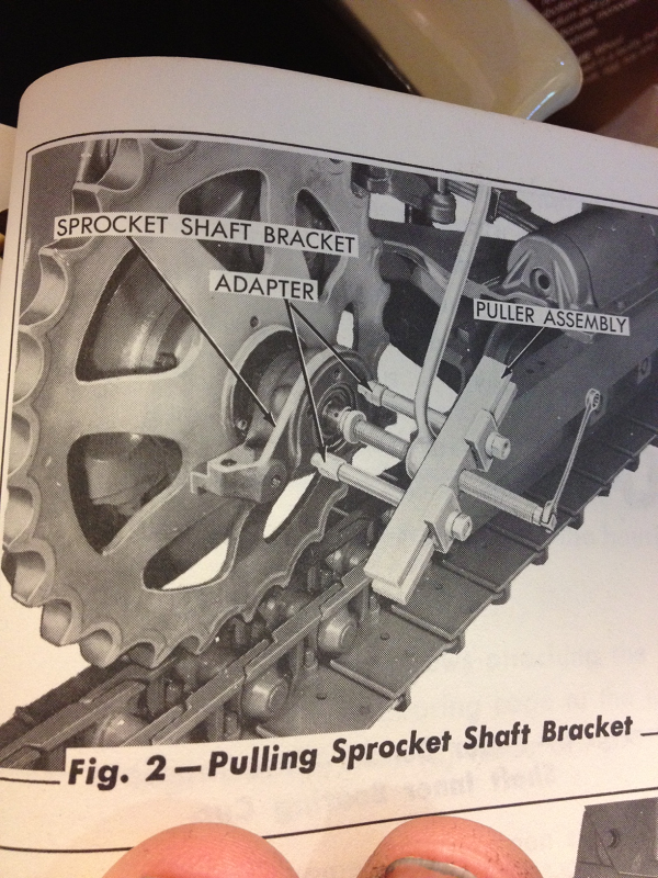

Does anyone have a picture of the puller used to get the outdrive bearing off of the shaft on the final drive? the one mounted to the truck frame outside the sproket. Thanks

my dad use to cut the truck frame  with a torch   and knock the bearings out and reweld it back to the frame.

i hope this helps. it is from a hd5 service manual burt they are the same bearing and housing. good luck

The two bolts on the outside screw into the housing and the center bolt pushes it off  We use a 10 ton hyd puler kit for all those jobs
