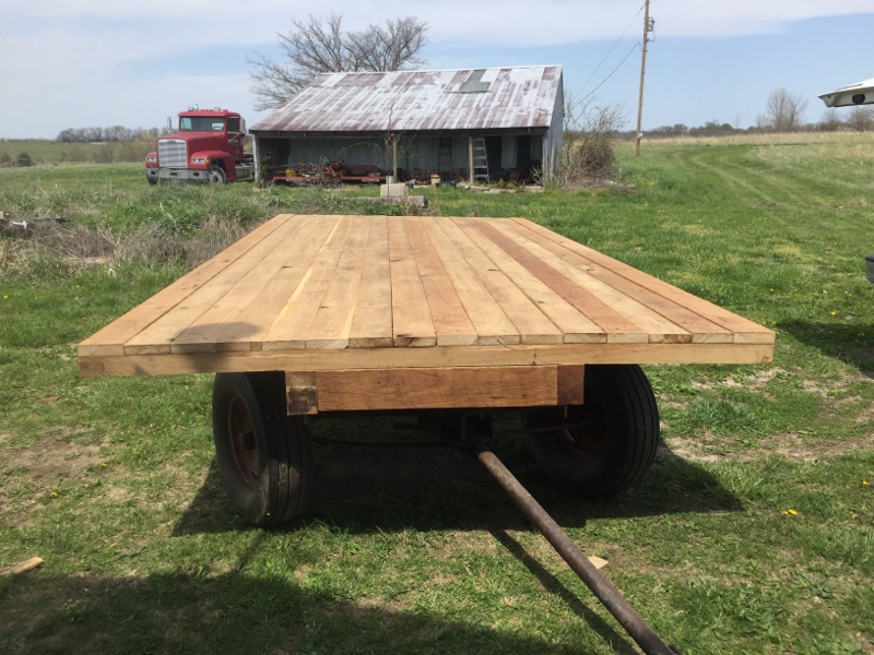

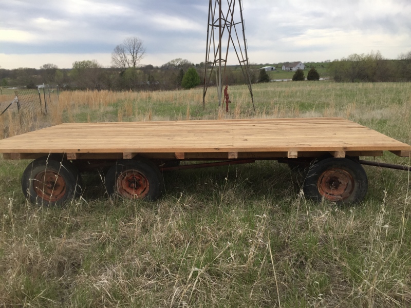

I just did a new idea three axel running gear. I used rough sawn white oak. 4” x 6” x 16’ stringers, 3” x 4” x 8’ cross members and 1.5” x 6” x 16’ tip boards. If you search this site for new idea the post with pics should come up

Here is a link to Michael Crowe's thread,
 Michael, your wagon is looking good, have you got pictures of it finished?

I don’t know how to use the quote function but I just bet my post on my wagon completed pics in the farm section

I’ll see if this link works. It’s in the farm section in case not.
http://www.allischalmers.com/forum/new-idea-wagon-project_topic150009.html

When I built the wagon, I used pipe clamps to hold the top boards snug against each other, and now that they have dried and shrunk a bit they have maybe 3/16” gap between them. I’m taking both my wagons to shoes this summer.

Michael the link worked and the hay bed turned out awesome. That’s the first tandem running gear I’ve seen. 👍

Dave H, Michael has three coats of linseed oil on it now.  I know when we built our white oak rack, there was several gallons of dieel oilt that got soaked in and had that treatment done many times over the years and it lasted close to 40 years...but it finally got to old out in the elements.
Mike's wagon...

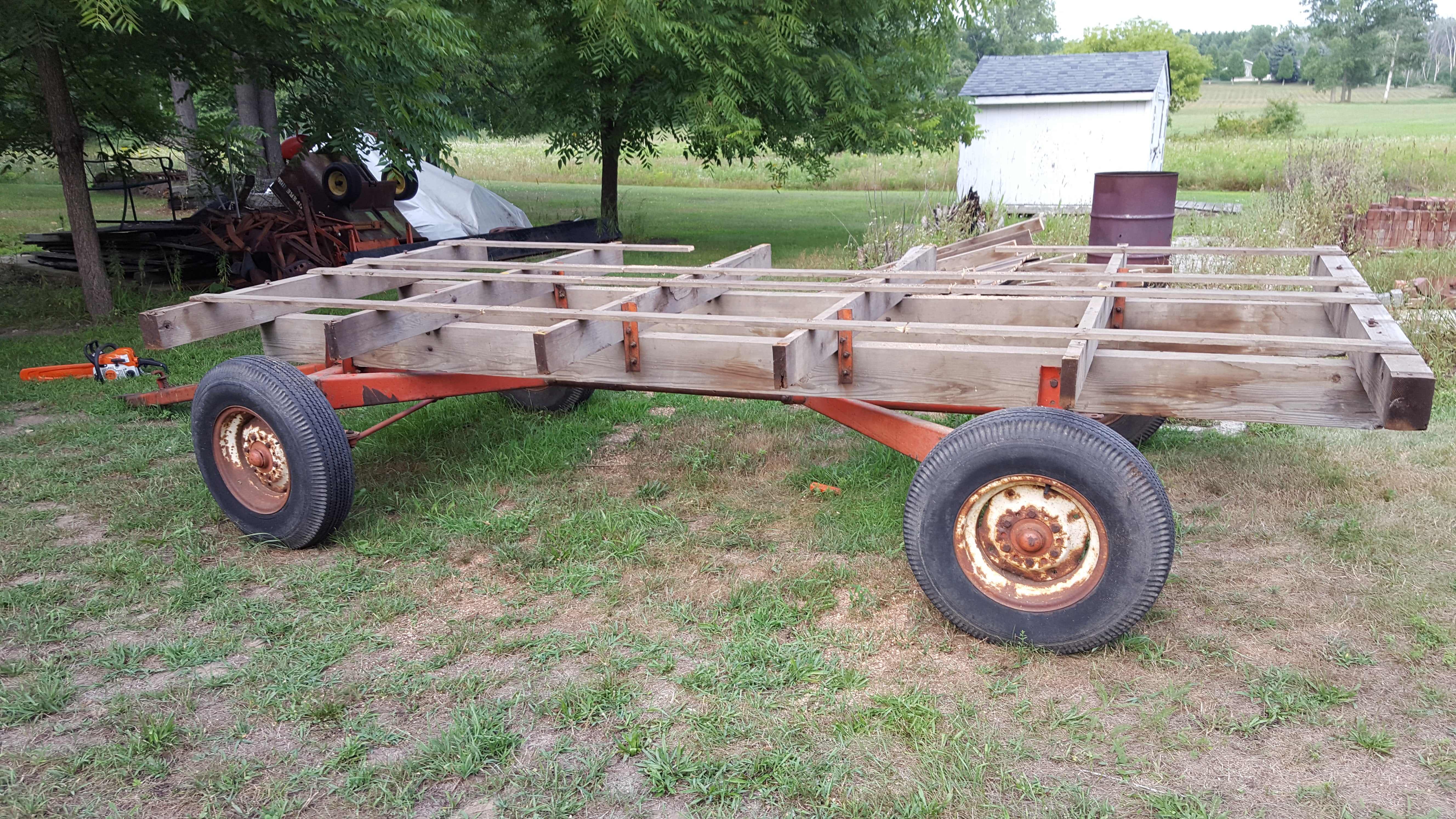

So I made some progress on my project, stripped the old wagon deck boards tonight. Just have to take off the 1x3" strip boards off the 2x6s in the pictures, then redeck it all.
Thanks again for all the help and will try to take pics when its done!
Posting pictures anymore drives me crazy! Ha
Help!!!
https://www.michigan-sportsman.com/forum/media/20180801_190602.119568/full
https://www.michigan-sportsman.com/forum/media/20180801_190549.119567/full

I was wondering where you was on that project.  The other day I saw some rough cut oak on Flint CL.  I think it was Flint!  I believe he said they were 5/4" boards.
