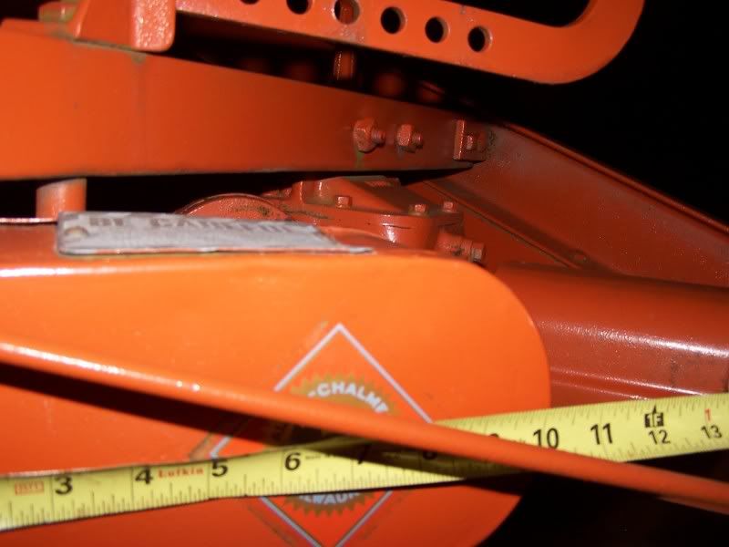

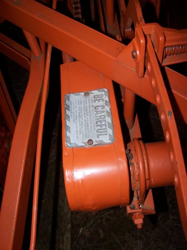

do any of your rakes  have a sheet metal guard over the chain drive. mine doesnt but it has brackets like one is supposed to be there.

Yes, there is sheet metal.
I think this is what your talking about.

that looks like what it should be according to the mounting brackets. i may need to get some measurements from you to make a pattern and fabricat one for mine. thanks don

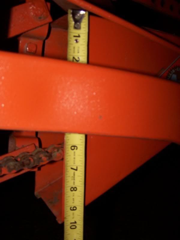

Took some pics out in the dark tonight, hope they turn out.

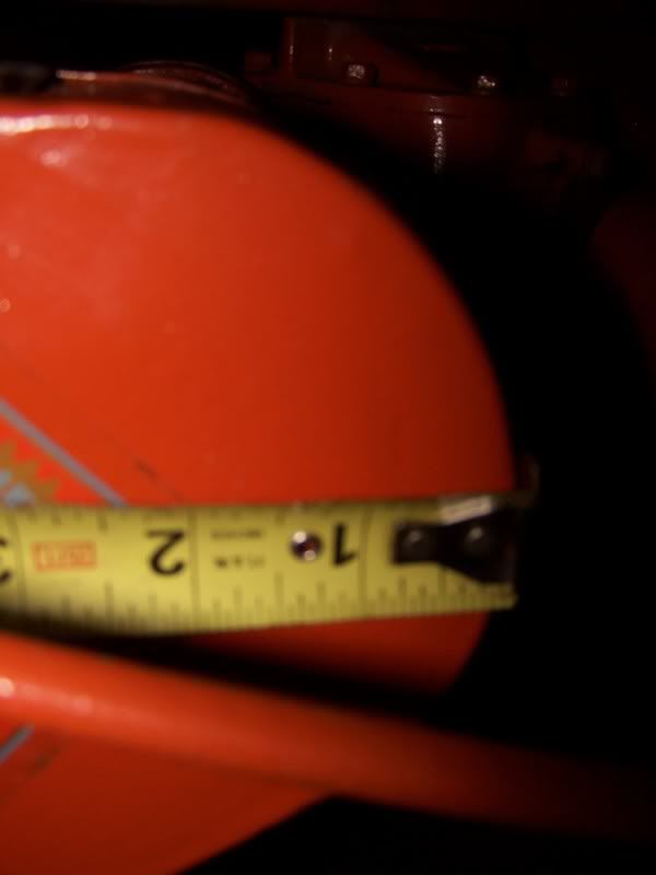

Overall, it should not be too hard to make. Its basically an enclosed "V" shape, with the end rounded over with a 2" or 2 1/4" radius.

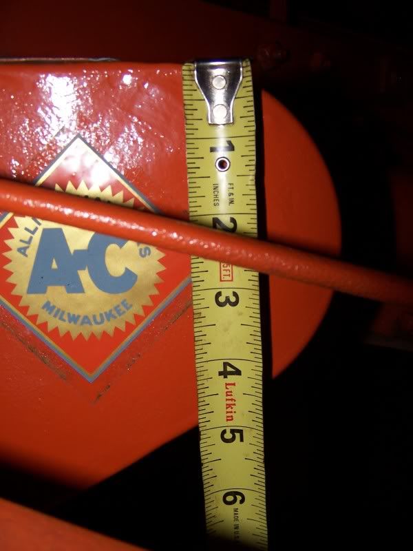

This is a measurement of the total height of the open trough end.

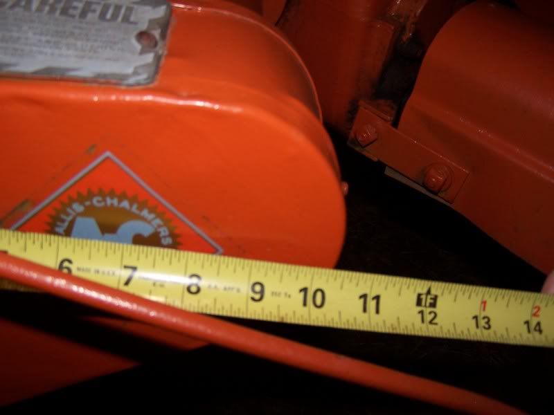

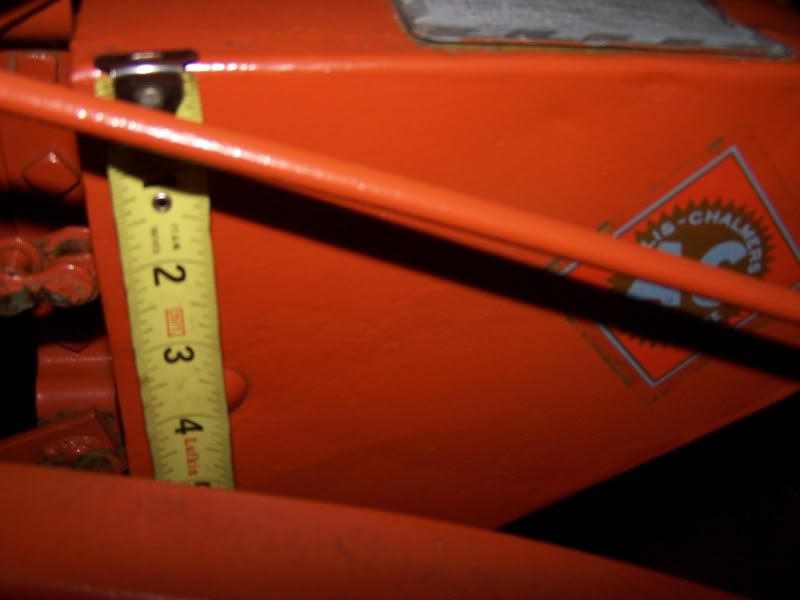

Total length
Radii end, and the radius

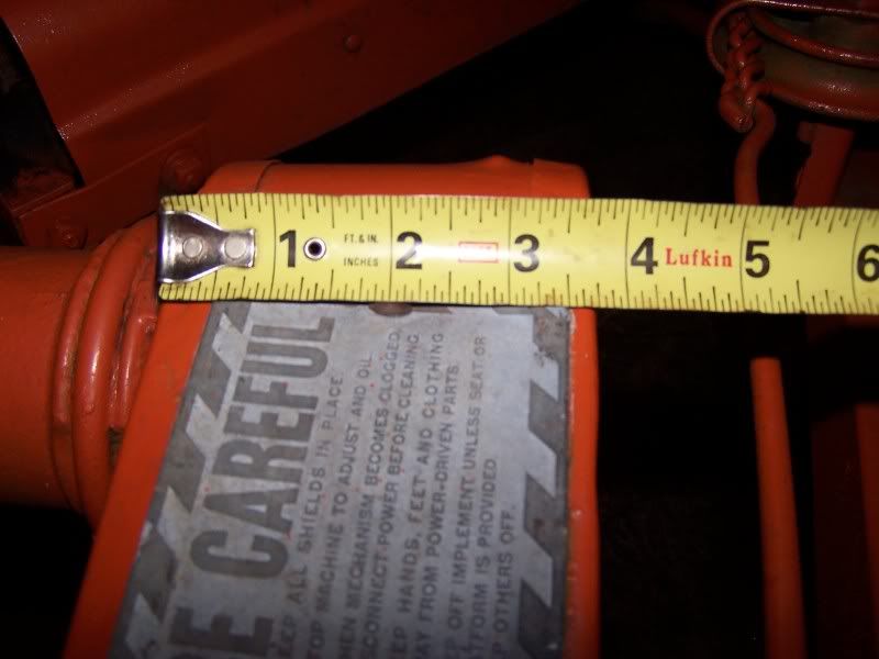

Width of the trough O.D.

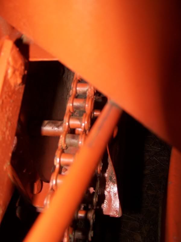

There is one bracket inside the metal sheild, about mid way up.
You can see the chain, resting on the round bracket. Its about 3 3/4" down from the top (See the first picture again).
