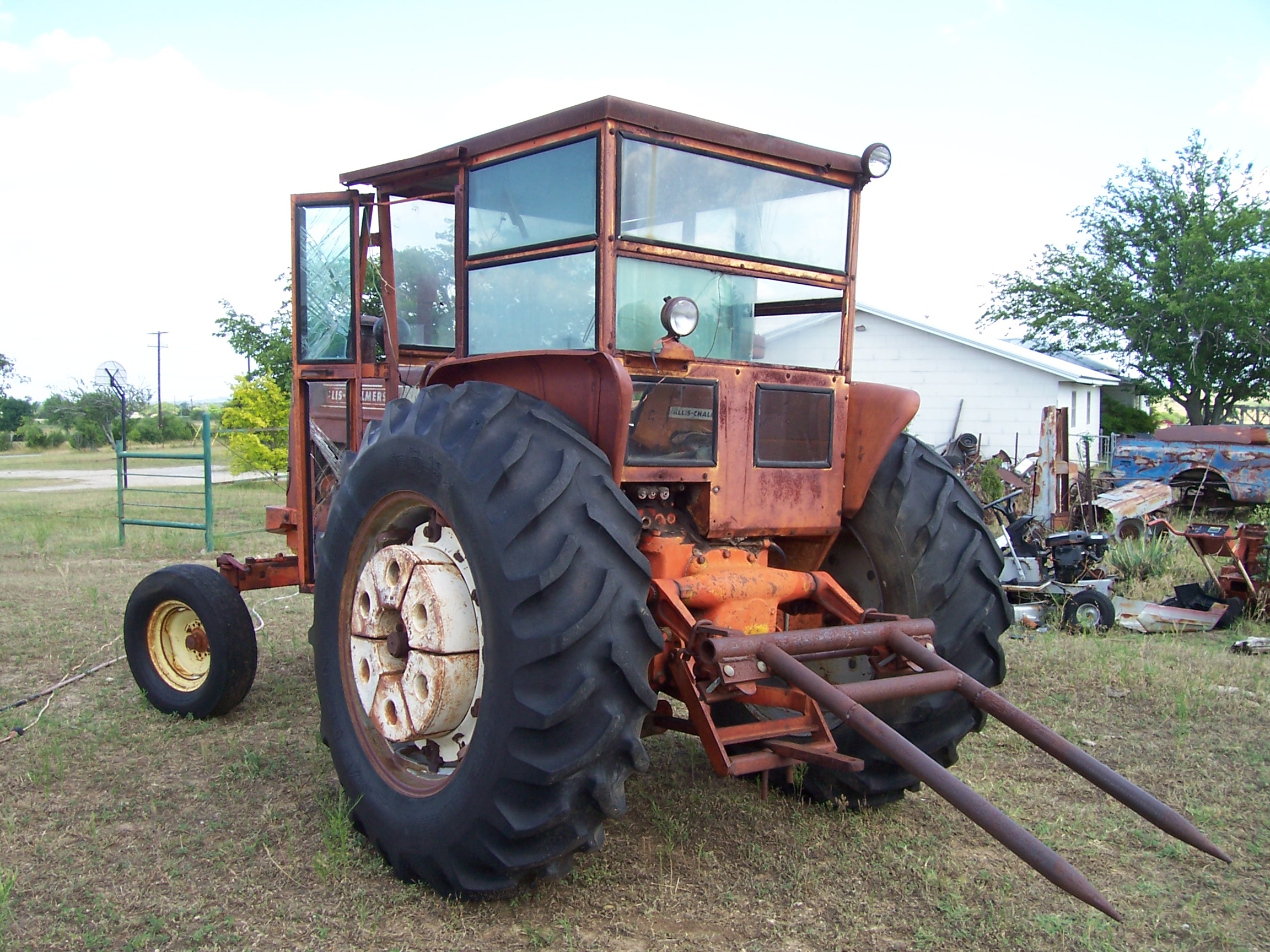

I need some help. I would like to come up with a way to use a hay fork on my D 14
I have some 4 X 4 rolls of hay that this tractor would handle fine.
My question is has anyone converted a fork to fit the snap couple lift if so how did you do this.
I thank you for your help and time
Rodd

One of the D19's I bought had a hay spike clamped directly onto the snap coupler lift arms.
