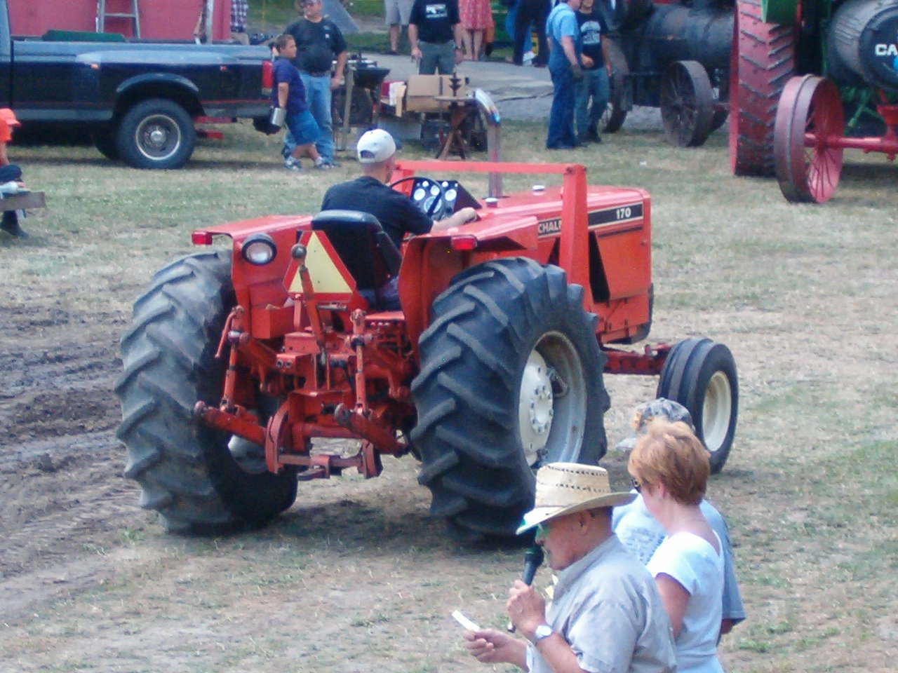

Here's the pic of that hammerstrap on the 175D that became the 170....it has extra holes in the drawbar, so maybe it isn't original AC.....tires and rims now belong to Chuck Luedtke (sp?) in WI, fender are for sale....

There is something weird with one of the fenders as it doesn't line up with the other...wouldn't notice it on the tractor, but it was obvious in my 4 tractor lineup. This fender was tilted forward. I posted this pic before with no reply...you can see the fender on the left the "dirt line" isn't parallel to the mouting holes....

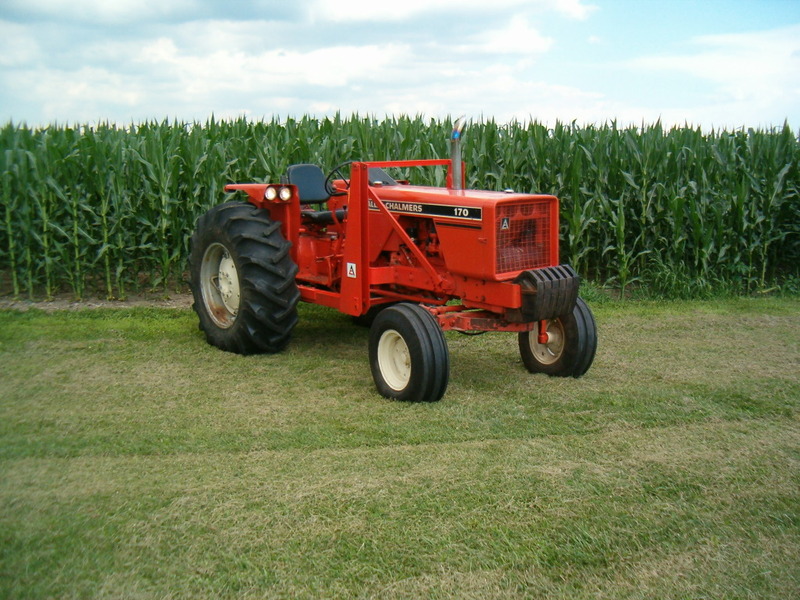

The fenders on my 170 had an Allis Chalmers heat houser mounted to them at one time, so there is extra holes in the tops of them.  It's not a huge deal but it annoys me.  Also when my Dad and I went and looked at the tractor the guy selling it had it used it for snowblowing.  The right fender is slightly bent, I always figured He must have had chains on the tires and something got hooked in them and went around the wheel to bend the fender, again not a big deal but I wish it was straight.
