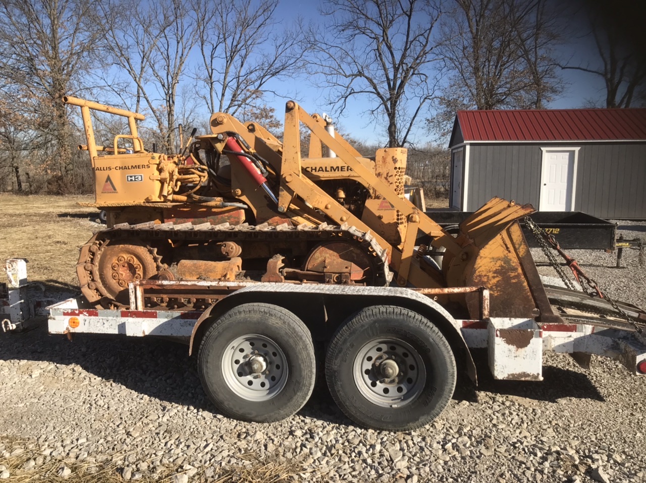

Got my new to me h3 home the other day. Waiting on some hydraulic fittings to come in so I can replace some hoses. Blew a lift cylinder hose loading it. Gonna service it and go over everything, new seat and some other stuff. Has pto and 3 point but someone turned the 3 point into a rop. I plan on changing that back. While using my tree puller on my skid steer yesterday I wondered if anyone had ever fabbed up a skid steer quick attach setup for the front so they could run something other than the bucket? I could use the 3 point cylinder rear hydraulics and run lines to the front to power my tree puller. And best I could tell from online pics maybe I have dozer tracks and not loader smooth tracks? I’m probably wrong but I thought loader tracks were smooth and didn’t have the raised traction bars.

sniff,sniif... I've always wanted an H3.....it'd look GREAT nesxt to my D14s....sniff, sniff....
yes SSQA should be a NICE upgrade ! Not that hard to do, several mfrs make 'kits' + plates, easy enough to bodge onto the loader pins.
I'd make a 'mockup' out of plywood,2x4s,etc. to get the dimensions juuuuuust right THEN fab the steel pieces. I did that for one of my D-14s 2-3 years ago.

Dozer tracks on a loader can wear out finals quickly as a loader is always making short shape turns, often with a bucket full of material compared to mainly straight line pushes with a dozer. I company that I worked for had a small IHC loader with dozer tracks and we were always repairing the finals until I suggested that we torch to the grousers down to about 1/2 the height. We never had any more trouble with the finals after that. The sprocket and what I can see of the rails look good so you might find some old loader tracks and replace the pads.

What Don is saying is true but if your work involves a lot of straight pushing you accomplish much more with the tracks you have as loader tracks are short of positive traction especially on a light machine like an H3. Because you don't have a rear counterweight the backend will be very light with a bucket full of material, this in turn keeps a lot of side torsion away from the finals with a loaded bucket off the ground. I notice the track seems to be adjusted too tight, this is hard on the sprockets, bearings and front idlers. The tracks won't derail very easily but at a price. Interesting to see an old Allis hood on your machine. Have fun with it :-) !!

It came with all the original manuals so I’ll look up what the droop should be for the tracks. Didn’t think about em being too tight. Did they have a different hood?

The side profile of an H3 hood is the same look as that of a D14/D15 tractor. The way the hood on yours curves down coming up to the radiator identifies it as that of WD, WC, WF and model B, C & CA tractors.
