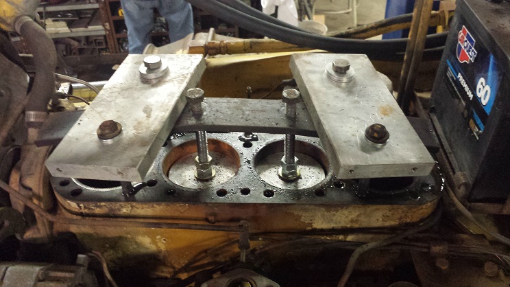

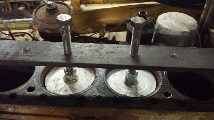

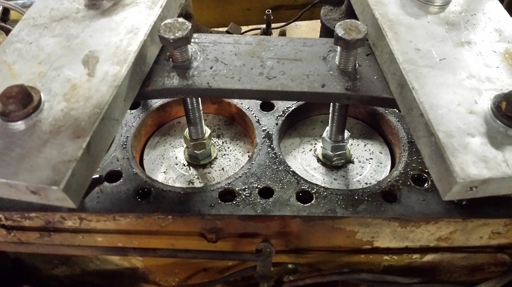

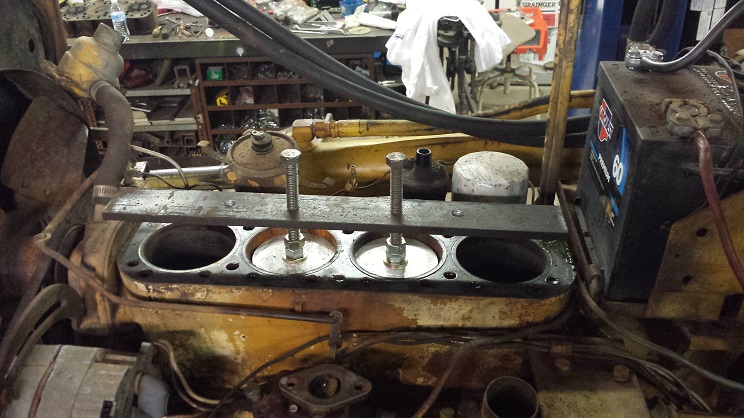

Contraption I built to move two stuck pistons.  Well the bar stock wasnt strong enough, but did put a little tension on the slugs.  Couple raps with a hammer moved both pistons about a half an inch down.
I locked the sleeves down with bolts and washers.  But the starter wont move them yet, so I am soaking them some 50/50 acetone/transmission fluid.

You are well on your way. You do have the advantage of the pistons being high up in the sleeves...will be easy to hone out the deposits of crud once you're down a bit more. We'll look forward to your next report.

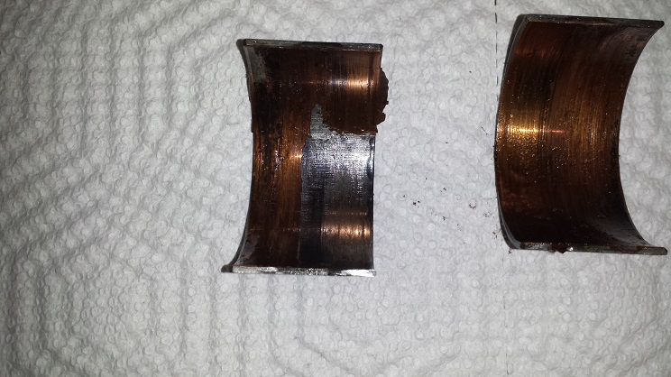

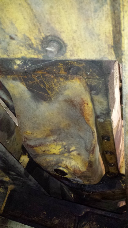

Ok, Arhggg, had to pull the sleeve as I could not get the piston to move freely enought, i.e. with the starter, etc.
Glad I did as it looks like the rod bearing(s) are wiped out.  Looks like a complete now.
Pressed the piston out of the sleeve, yuk..

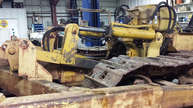

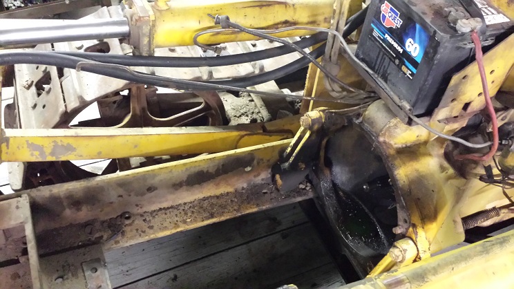

Oh, and I think I solved the riddle.  They (???) left the skid pan off and put a whopper of a dent in the oil pan, which in turn lifted the oil pickup out of the oil and walla, no oil, wiped bearings.  Then left out in the rain.
The good news is I really like this machine and how its put together.  Simple enough for even me.  And it doesnt look as bad as the pictures.
Now, pull the motor and put on a stand and the dozer on trailer back outside until the motor is dun.

Well, I didn't count on pistons running dry before the bearings got wiped out... and then the rust formed on that dry steel...
 you are right, your in for a full overhaul... and get that block cooked.  Check the oil pump too, see if theres rust in it and make sure the little springs that hold the vanes apart are good. Hope the pistons are salvageable.

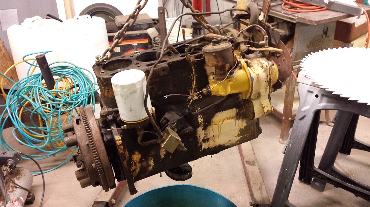

Got the motor out.  Took all of about an hour.

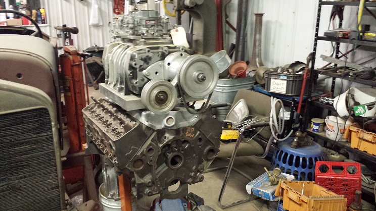

New motor getting ready to go in!!
Points: 8661
Post Options Post Options   Thanks (0) Thanks(0)   Quote Sugarmaker Quote  Post ReplyReply Direct Link To This Post Posted: 25 Nov 2015 at 8:11am
Looks like a little more power!?
good shots! Maybe this will get me going on some of my projects:)

Sugarmaker, It looks like he's yanking that old model A motor out to put in his crawler. Wink LOL
