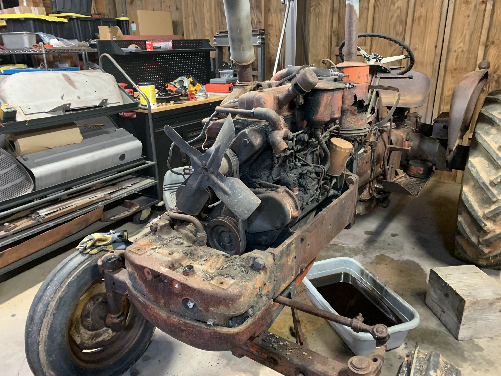

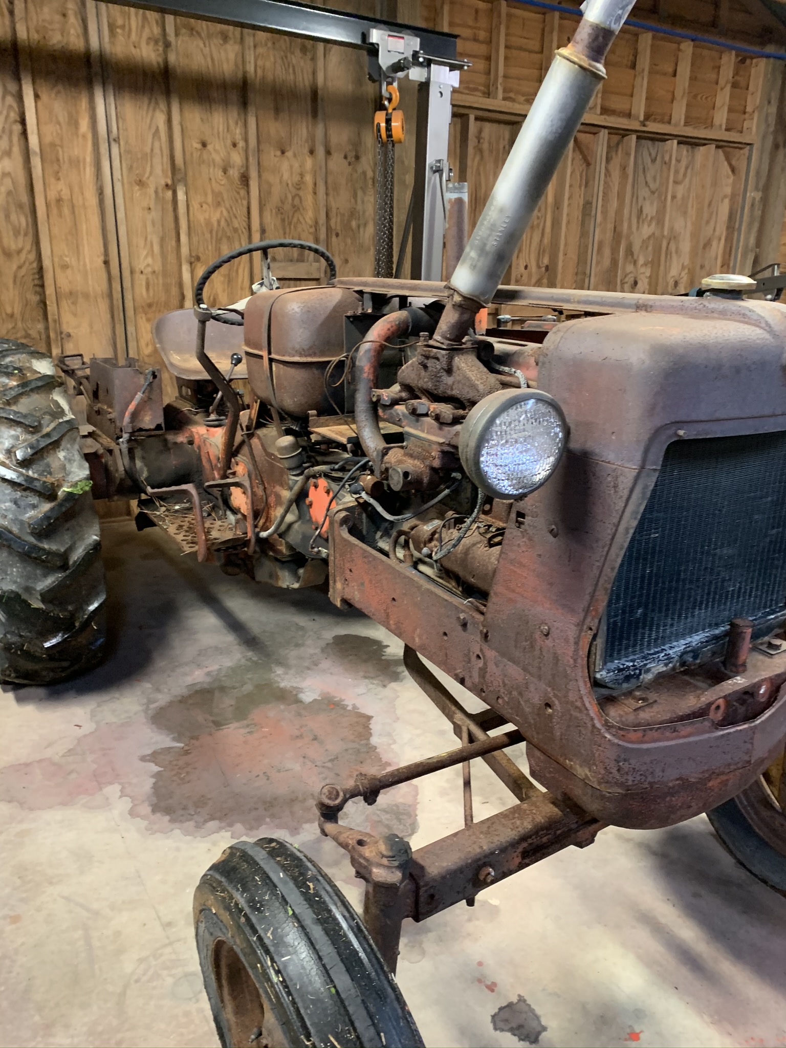

Finally started the work on my grandfathers D15 diesel series I. She looks like a boat anchor now.
Removed the 20 year old diesel from the tank....wow that was disgusting. Found three mice nests one in the bolster, one in the radiator and one in the battery box. The black stuff in the tub is the diesel fuel.
Any tips on removing the stuck injectors? Let the fun begin!

Is the engine stuck?? or free ??

Post Options Post Options   Thanks (0) Thanks(0)   Quote jollymon68 Quote  Post ReplyReply Direct Link To This Post Posted: 21 Jan 2020 at 8:57am
Oh the engine is stuck, was free and running when she was parked, but that was some time ago.

I'm thinking yo'll find a 4th 'mouse house' int he bell housing !! Mine was STUFFED ! took 3 HOURS to remove the 'condo'...starter was JAMMED from 'donations'.....
NICE project, family tractor.
 Take LOTS of pictures along the way and relax..have fun with it !!

The injectors should come straight out, a tire-mans "J-bar" (its used to separate the lock rings on multi piece rims) is about the right shape to get behind them if they need a little help.

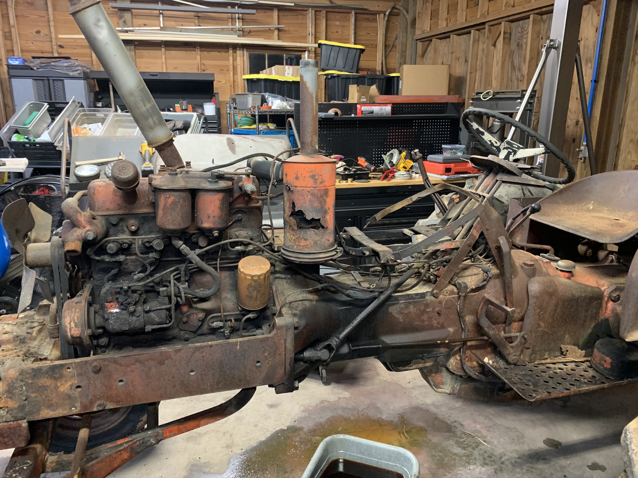

I have never seen a air box rusted out like that.

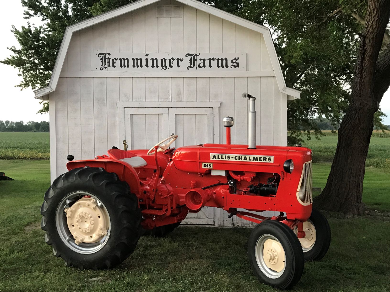

I will keep everyone updated. The air cleaner rusted out because grandpa lost the top to it and let it fill with water. Here is a picture of one of my restored D15's

You did a great job on that tractor ! I'll be following this as we have two series 1 D 15s . One of which is a diesel . Thanks for the pictures

Must comment on your beautiful D15 D! Almost make you want to run out and buy one of those! I think if that were still made they would sell!
I can see you have the skills to get this next family tractor in like new condition too!

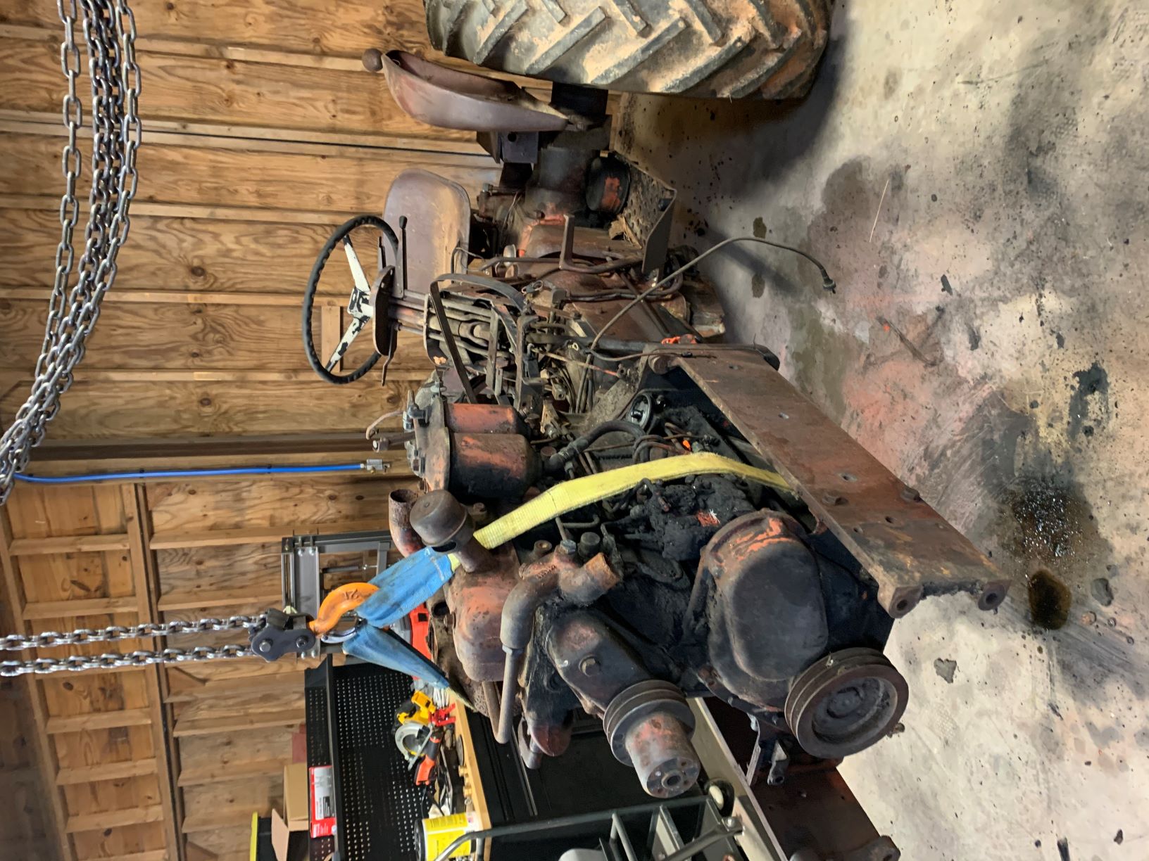

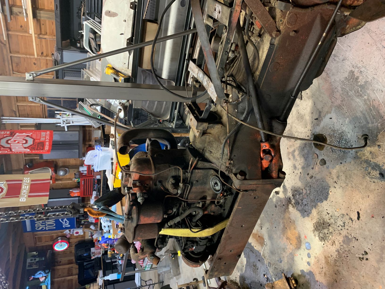

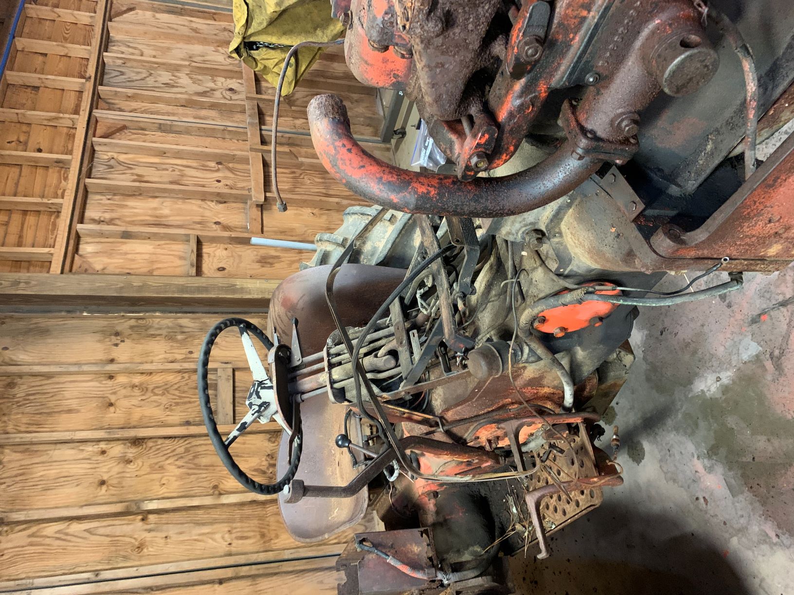

The tear down continues... So far only two broken bolts

That rack you have to store parts is a great idea!
