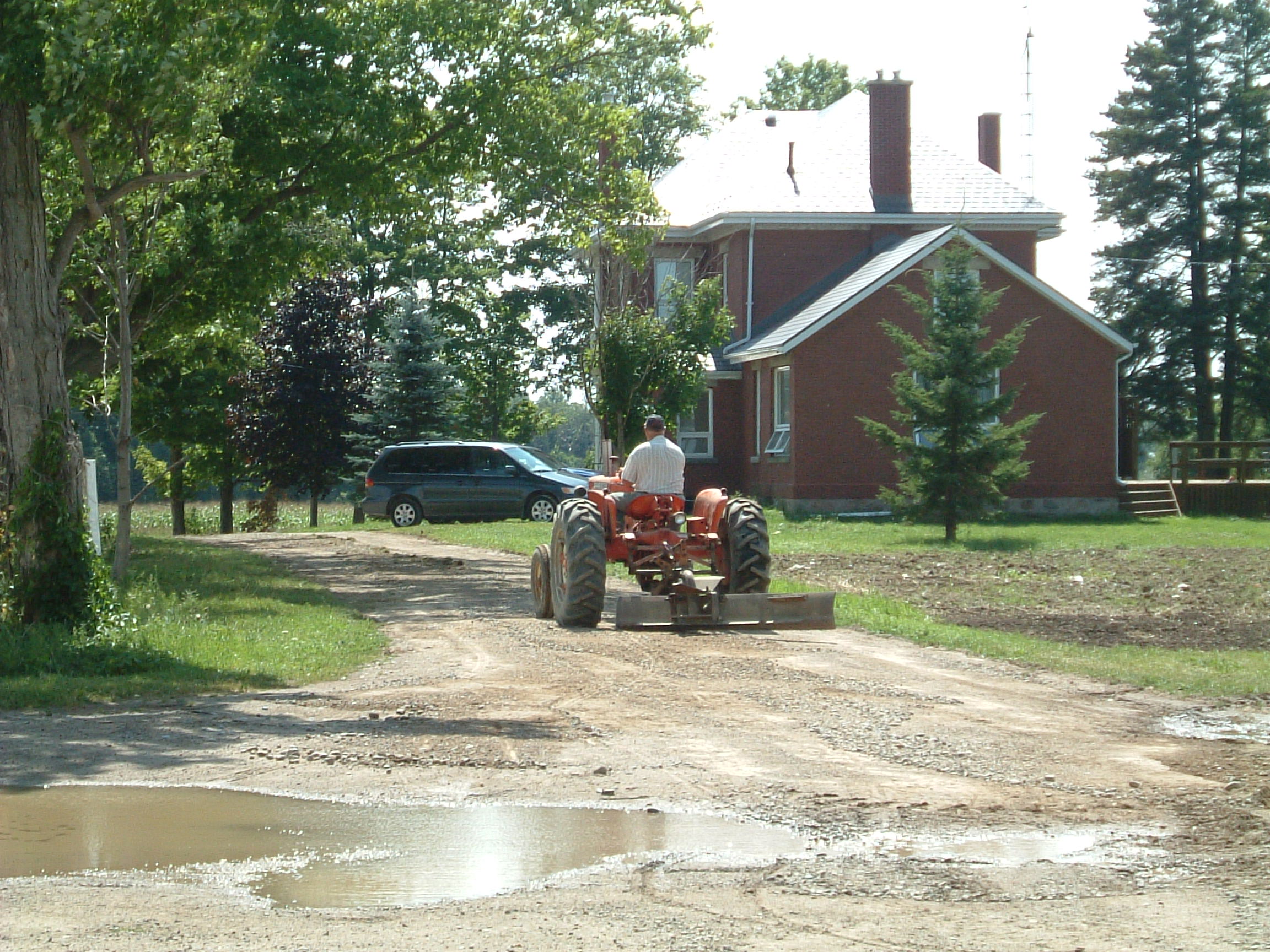

    Having been in and out of a lot of laneways in the forty years of constructing farm buildings, I believe that the second best grading system is the A C scraper blade. Here is the Georgetown farmer George Bird, doing his newly acquired farm lane in Rockwood, Ontario.
    The drag behind boxes, upside down spike harrows, 6ft. wide fencing, etc., seem to make a mess by taking off the centre ridge and flipping the larger stones to the top. Larger stones do not appear to be friendly to car and truck tires.

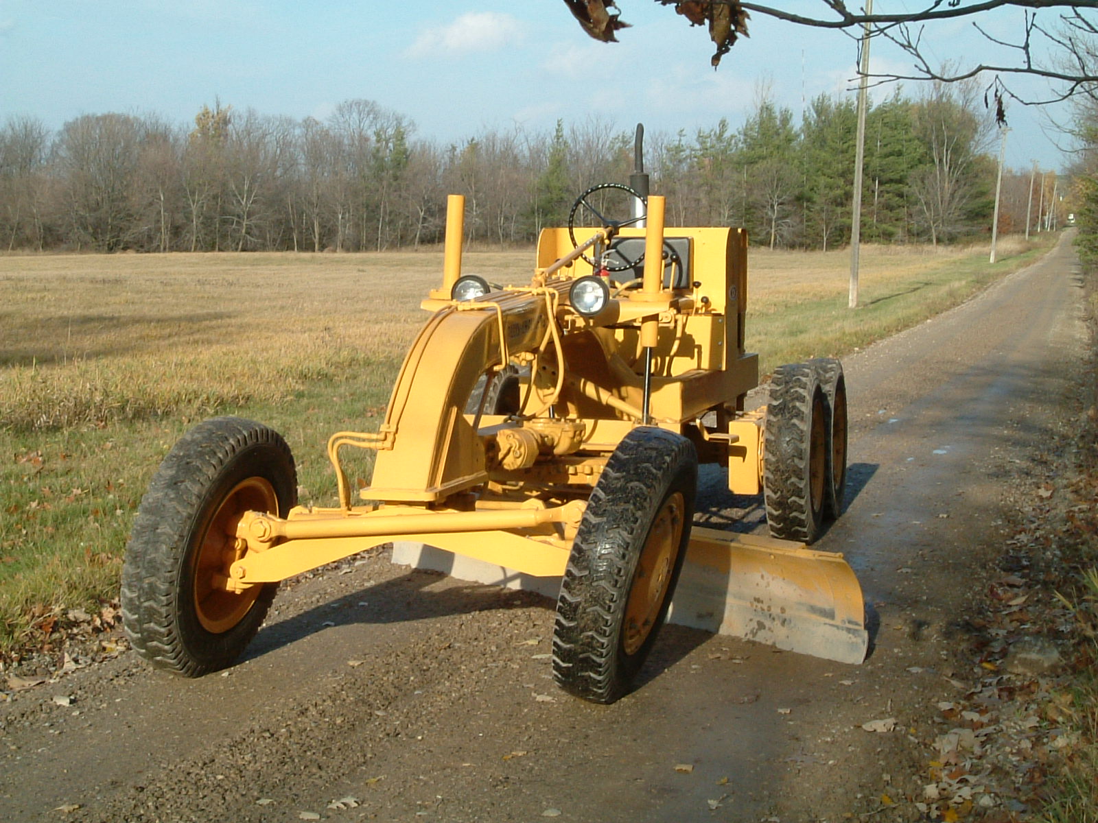

   The best way to grade is with the 'D Special' grader. Here is my grader doing a 1/2 mile laneway in Georgetown, Ont.. You can control the gravel for side ditch clean out, slope grading for the sides and centre crowning.

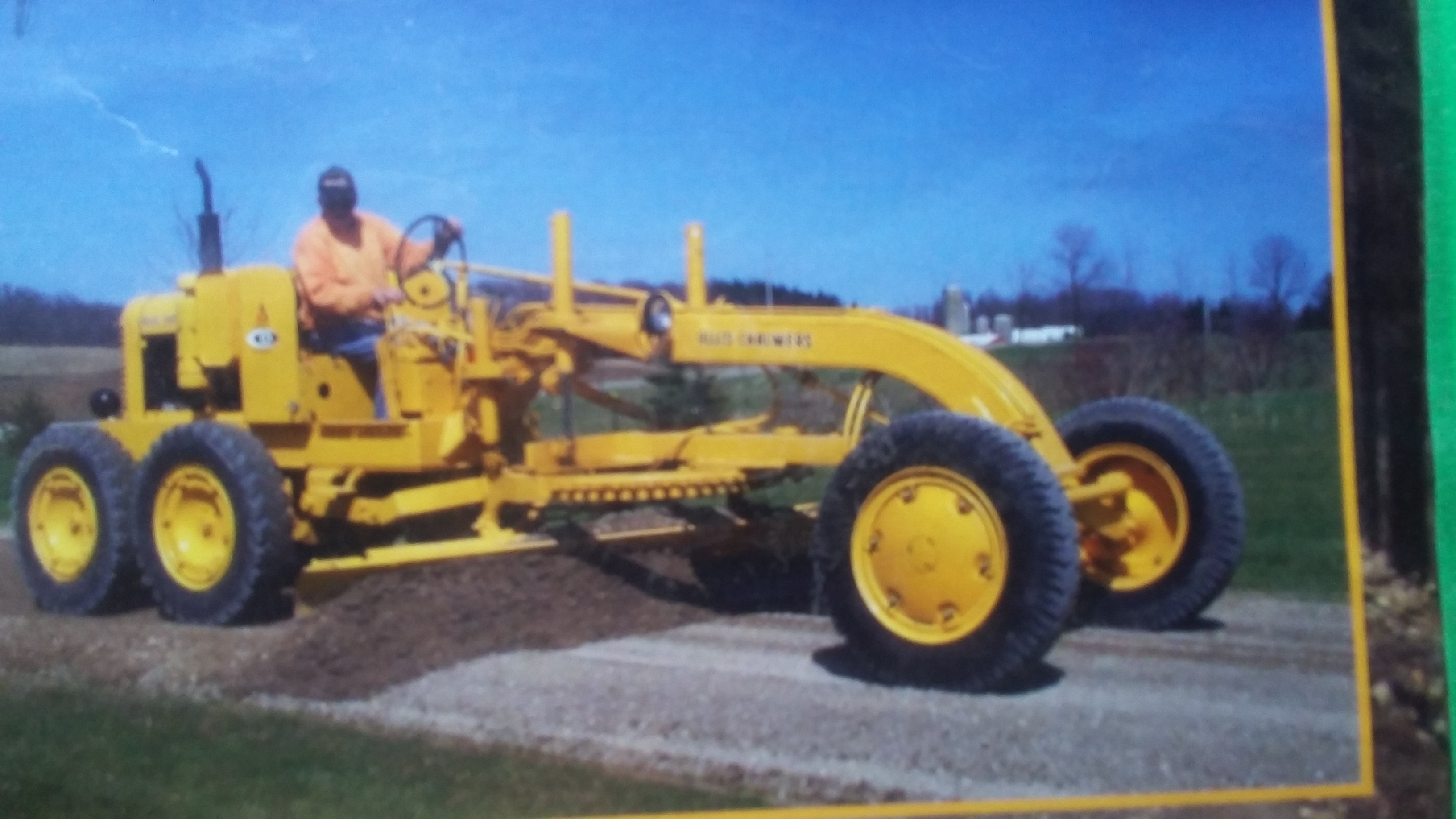

   Here is a picture of Calvin Schmidt, using my 'D Special' to place gravel in a laneway of a house that is now owned by Justine Bieber, near Stratford, Ont..

Sorry about the picture sizing. (Oh, Justin, not Justine). I am trouble loading the picture of Calvin.
   Ross.

Hi. Here is the picture of Calvin that I tried to send yesterday. Again, sorry for the sizing.   Ross D.
