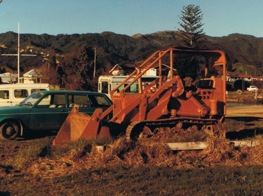

Post Options Post Options   Thanks (0) Thanks(0)   Quote HD6 Merv Quote  Post ReplyReply Direct Link To This Post Posted: 29 Jan 2017 at 10:40pm
My old 933G with how a 4 in 1 bucket should be

Points: 35661
Post Options Post Options   Thanks (0) Thanks(0)   Quote DMiller Quote  Post ReplyReply Direct Link To This Post Posted: 30 Jan 2017 at 4:10am
Had found a older 4/1 off another brand last year, had considered buying it and converting to fit the Allis but just could not bring myself there. Will manage with these two as I get the GP repaired it will be a good light on her toes machine for general work, will have the MP for when I choose to use the heavy beast.
