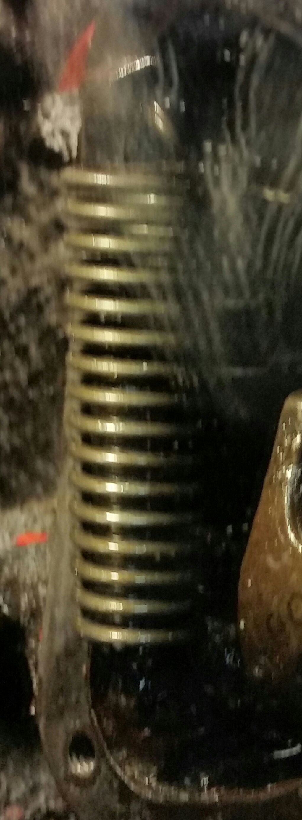

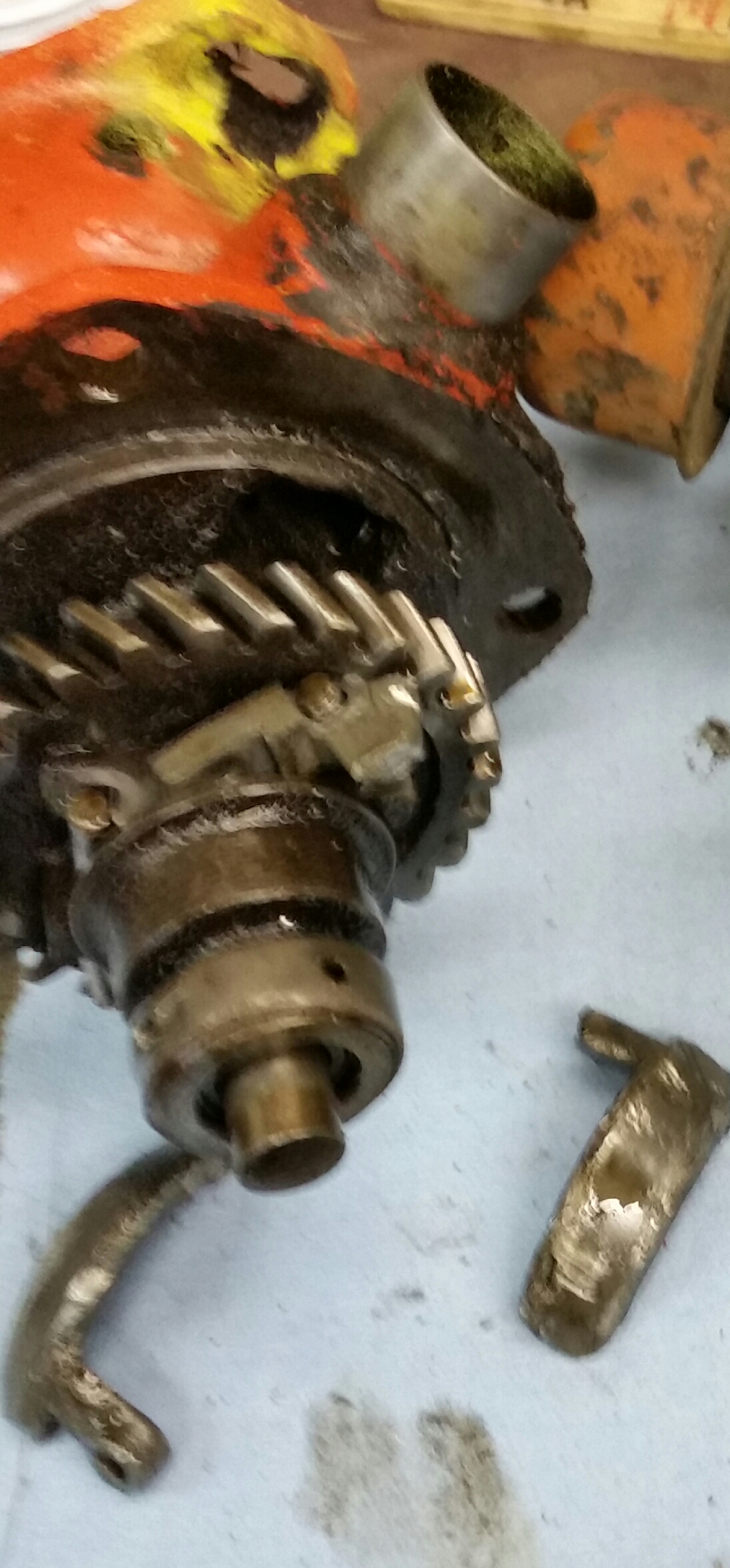

Was mowing with AC WD tractor and throttle went wide open. I quickly shut engine off. Pulled governor out. It was mutilated(see pic). Installed replacement governor(see pic). Spring looks good(see pic). Started tractor and still run at wide open. What should I be looking for next?

http://allis01.com/fossto/44WC/ac-wc-gov.html
This is a link to when I did mine on a WC, they should be the same.  Is there any play in the fork mounted on the cross shaft?

Tom, There is approx. 1/16 inch horizontal movement.

What about any camshaft gear teeth damage and small governor weight pieces down inside ????

Dr.Allis.....Teeth looked good on cam gear and original governor mating gear. Found most of damaged parts in governor housing when disassembling.     one pin clip unaccounted for and it's possible some small weight pieces and that clip may have found their way to the oil pan. Tractor runs well if I manually control linkage from governor on left side of engine. Still at a loss in figuring out way it wants to run wide open.

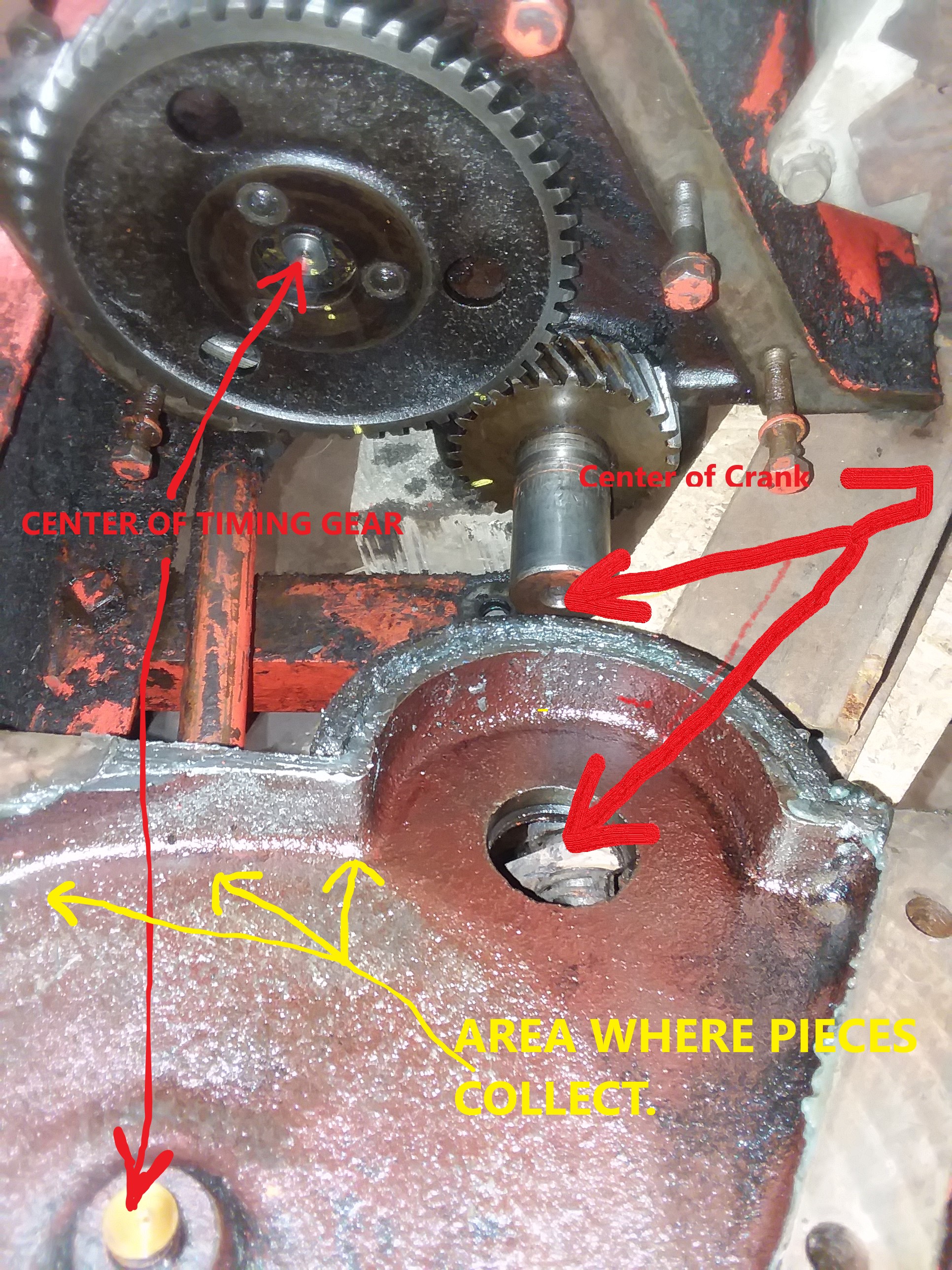

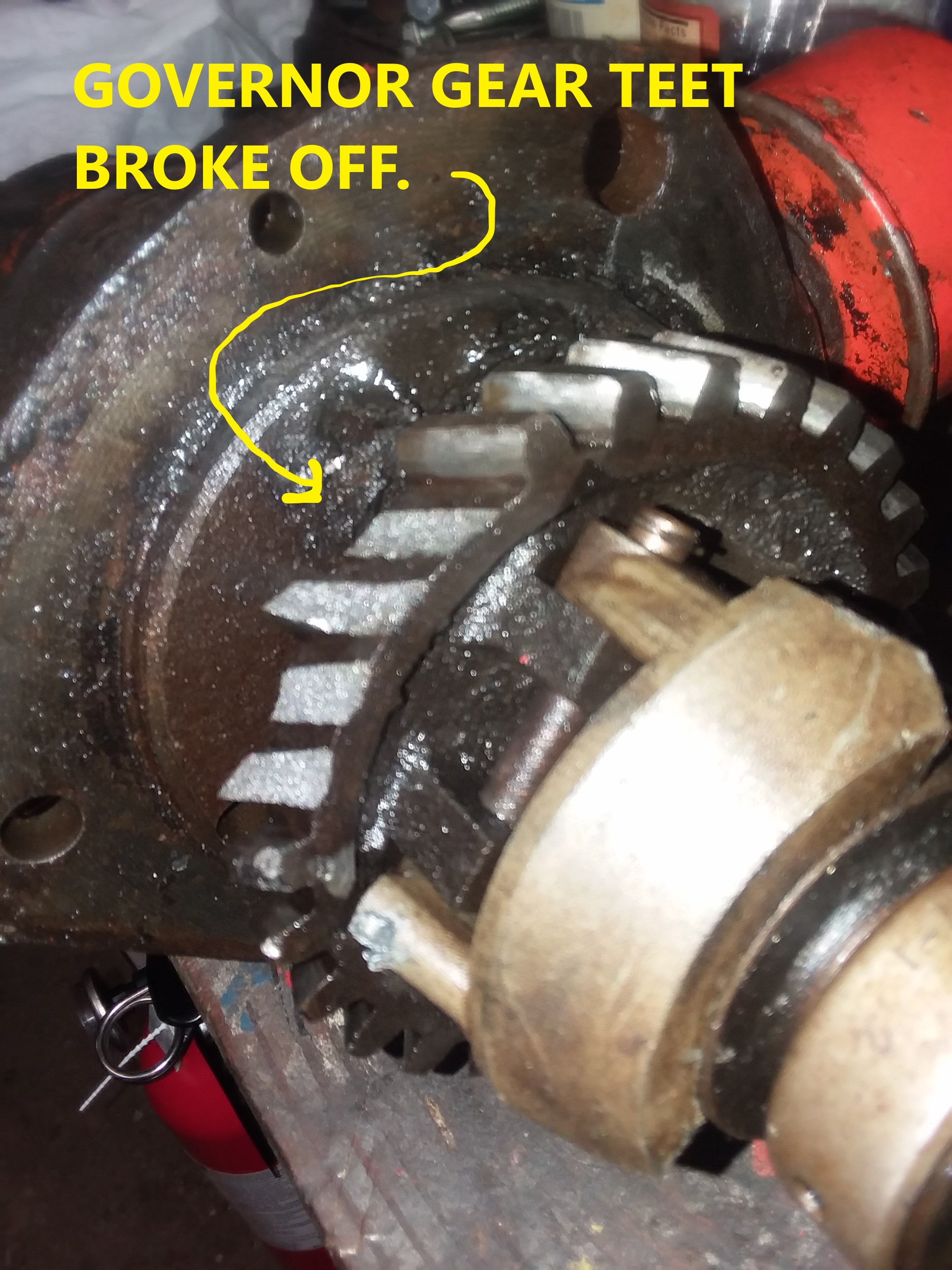

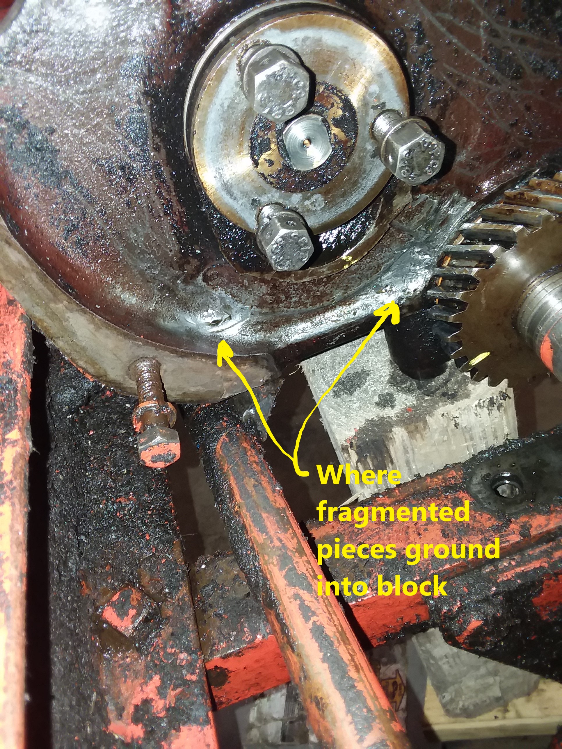

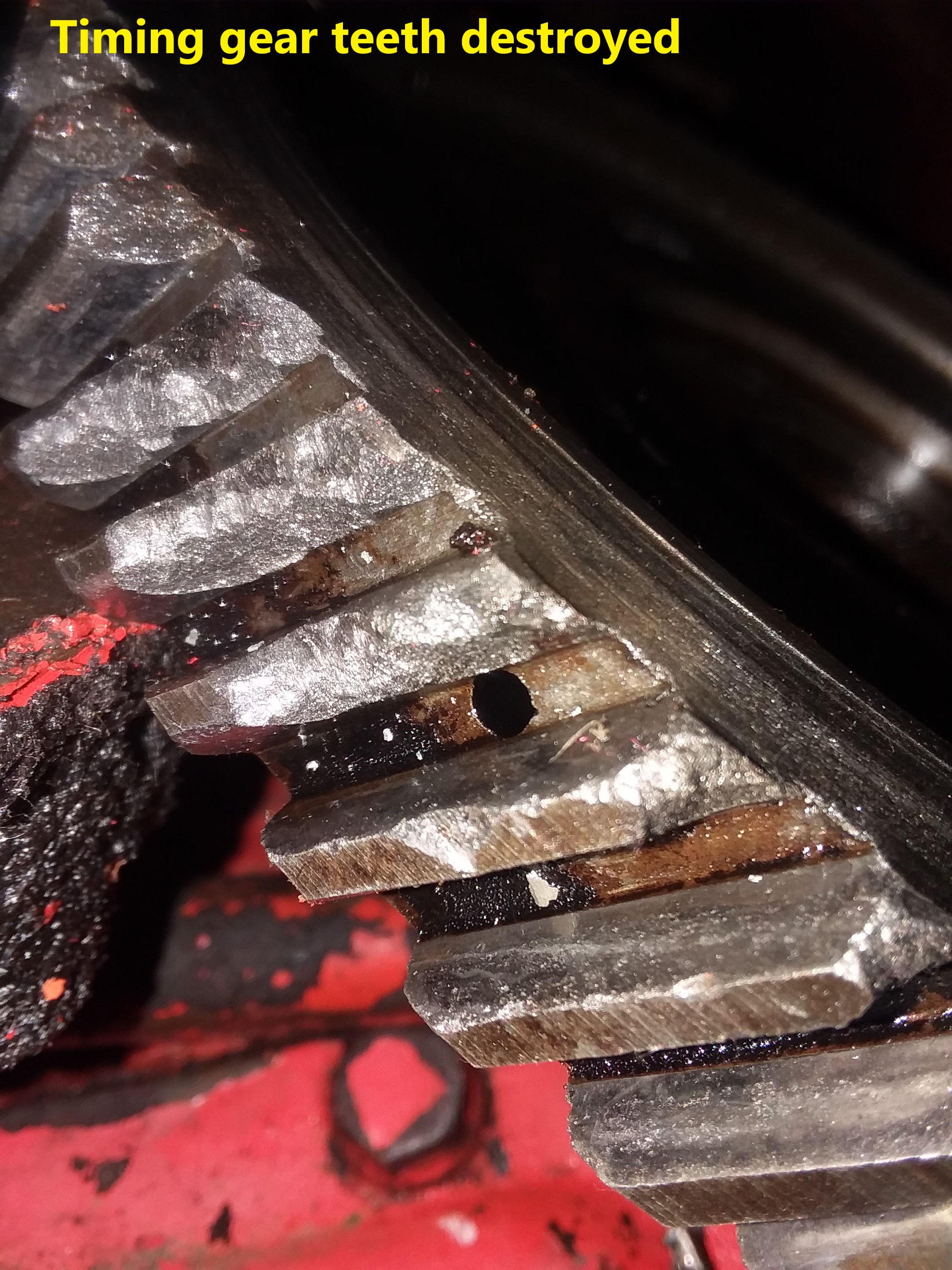

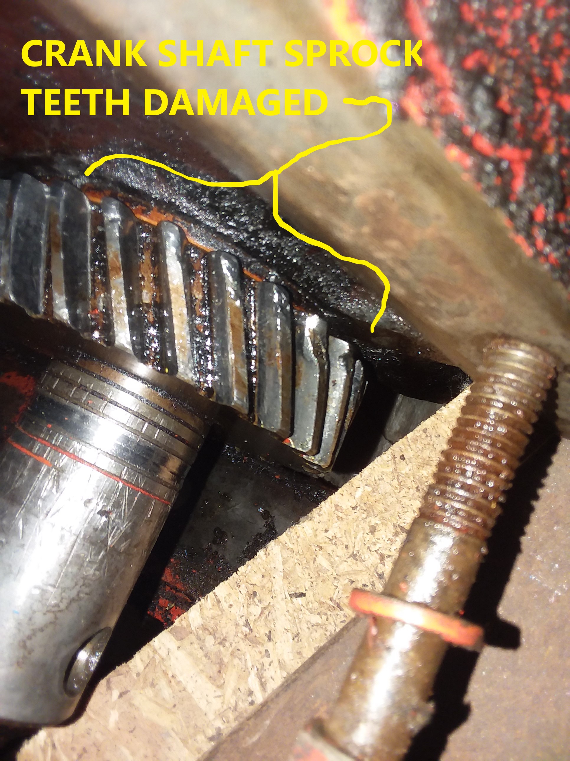

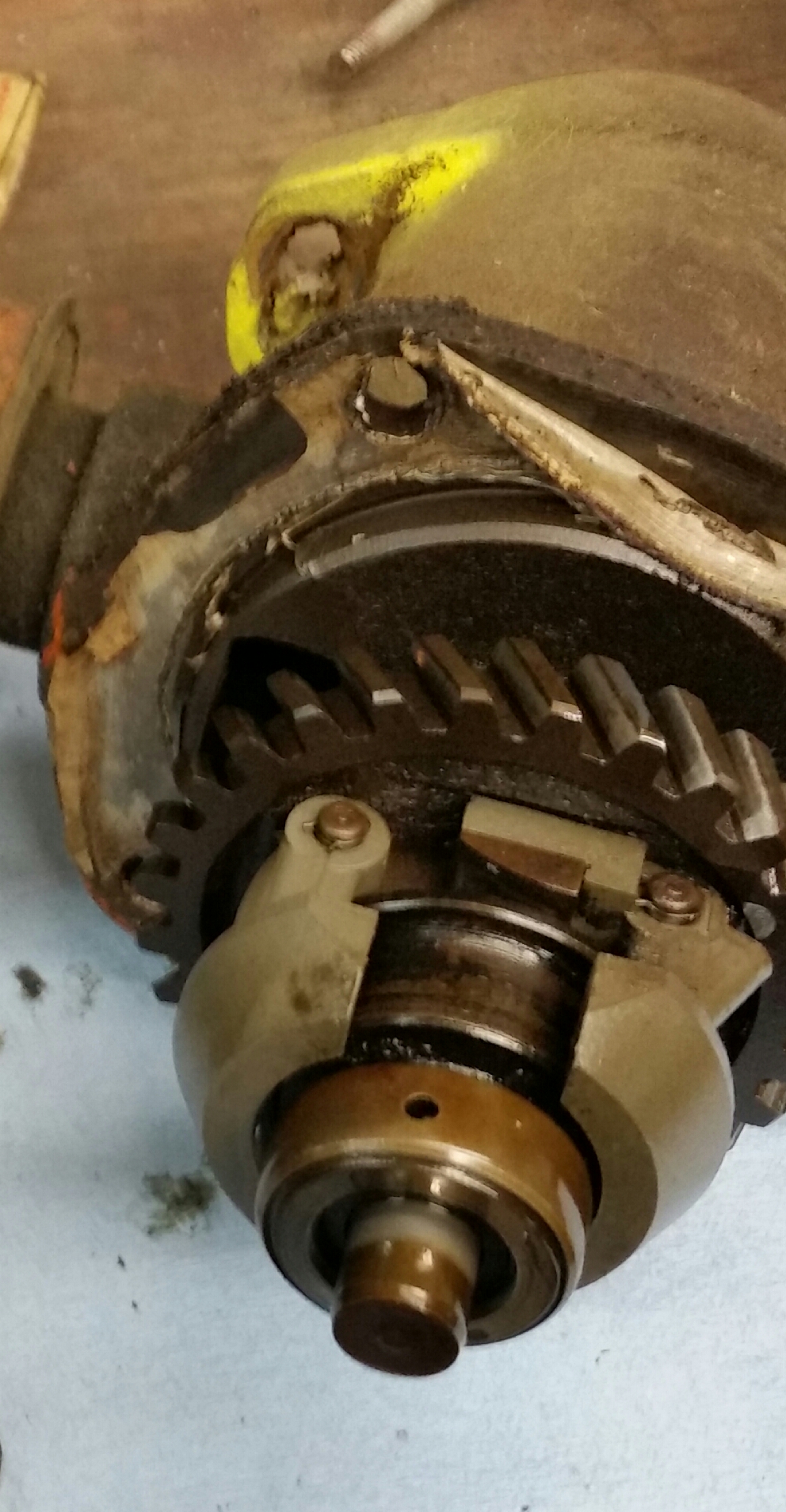

Post Options Post Options   Thanks (0) Thanks(0)   Quote danr Quote  Post ReplyReply Direct Link To This Post Posted: 21 Oct 2019 at 10:15am
Used tractor one season after this repair and the same thing happened again. So I replace the governor assembly again with one from another parts tractor I have.
It wasn't long after this governor let loose and engine jumped timing for some reason. I decided this time I'd pull the front cover off the engine and see what's going on.
What I found was that some of the disintegrated governor parts were laying at the bottom of the front engine coverr below where the timing gear is and the crankshaft sprocket is. (See attached pics) These were evidently rattling around and getting in the timing gear, the governor gear, and the crank shaft sprocket (gear). (See pics of damaged gear teeth) I also dropped oil pan and found lots of pieces in it.
I will be replacing the crankshaft sprocket, timing gear, and Governor assembly with parts off another parts tractor I have.
Moral of experience: if your governor lets loose and upon inspection find that pieces are missing do not assume they are in the oil pan. Pull the front cover off the engine and make sure nothing is in the cover and that all gear teeth are not damaged.

Post Options Post Options   Thanks (0) Thanks(0)   Quote Sugarmaker Quote  Post ReplyReply Direct Link To This Post Posted: 21 Oct 2019 at 11:41am
Dan,
 When I took the front cover off of one of the WD's I found the remnants of blown governor weights. They had been riding in there for years! Could have got caught and taken out the gears as yours did at any moment too. I also had another WD engine that was stuck at only one spot. Found it was a broken gear tooth stuck in the cam gear. I was lucky I didnt try to force it any more, till I took the front cover off!
Good thing you have some parts tractors too!
Thanks for the pictures!
