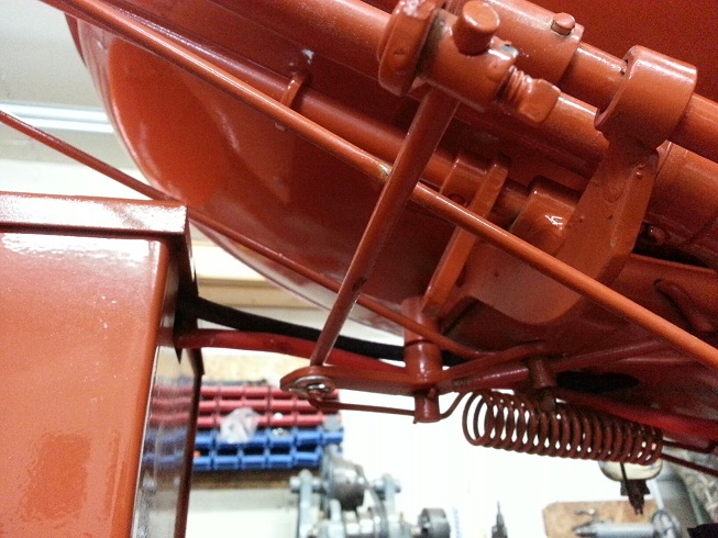

Post Options Post Options   Thanks (0) Thanks(0)   Quote firephight Quote  Post ReplyReply Direct Link To This Post Posted: 03 Jul 2013 at 10:58pm
some pics so some could help me out
Points: 22752
Post Options Post Options   Thanks (0) Thanks(0)   Quote DrAllis Quote  Post ReplyReply Direct Link To This Post Posted: 04 Jul 2013 at 6:23am
I want to see pictures of the carb side of the engine, with the hand throttle wide open. One pic of the governor arm behind the generator and another of the carb linkage up against the engine blcok. I see nothing wrong with any of these pics......nothing.

Post Options Post Options   Thanks (0) Thanks(0)   Quote firephight Quote  Post ReplyReply Direct Link To This Post Posted: 04 Jul 2013 at 11:29am
the carb side is with the throttle wide open
firephight View Drop Down
Joined: 16 Sep 2012
Location: st.louis
Points: 320
Post Options Post Options   Thanks (0) Thanks(0)   Quote firephight Quote  Post ReplyReply Direct Link To This Post Posted: 04 Jul 2013 at 11:34am
the last pic is at idle just wanted to show how the linkage was

Post Options Post Options   Thanks (0) Thanks(0)   Quote mlpankey Quote  Post ReplyReply Direct Link To This Post Posted: 04 Jul 2013 at 11:38am
if you pull the pins and remove the weights in you picture . get a piece of aluminum to slide on shaft to hold rocker arm spring up off shaft . cut spring to length and put pilot bearing back on shaft to work fork you will never break weights again but at the rpms your running that will never be a issue

Post Options Post Options   Thanks (0) Thanks(0)   Quote DrAllis Quote  Post ReplyReply Direct Link To This Post Posted: 05 Jul 2013 at 9:36am
Set hand throttle to wide open. Disconnect the carb link rod behind the generator. Grab the vertical governor arm and move the top of it towards the radiator. It should only move until the arm is probably straight up/down and the fork on the other side of the engine is bottomed out against the timing cover. Now, let go of the governor arm and it should spring backwards towards the carburator, and stop at some point. The governor arm is "pinned" to the fork on the other side of the engine. Whenever the arm is moved the fork should move. THERE CANNOT BE ANY LOOSENESS in this pin area and it is rare to have a problem like that.  If you can move the gov arm at all easily without stretching the gov spring, the tapered pin may be loose. Also the link rod to the carb should move back and forth very easily with no binding whatsoever when disconnected from the gov arm. I can visually see nothing wrong here. Do you have the gov arm synched to the link rod correctly?? It really shouldn't be a problem as things were just fine until you changed springs. I could fix it in five minutes if I was there.
