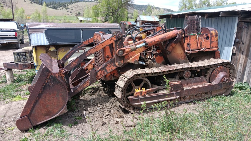

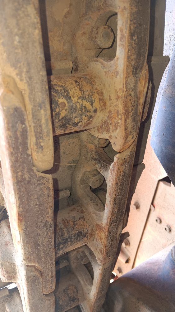

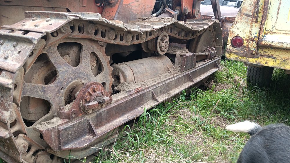

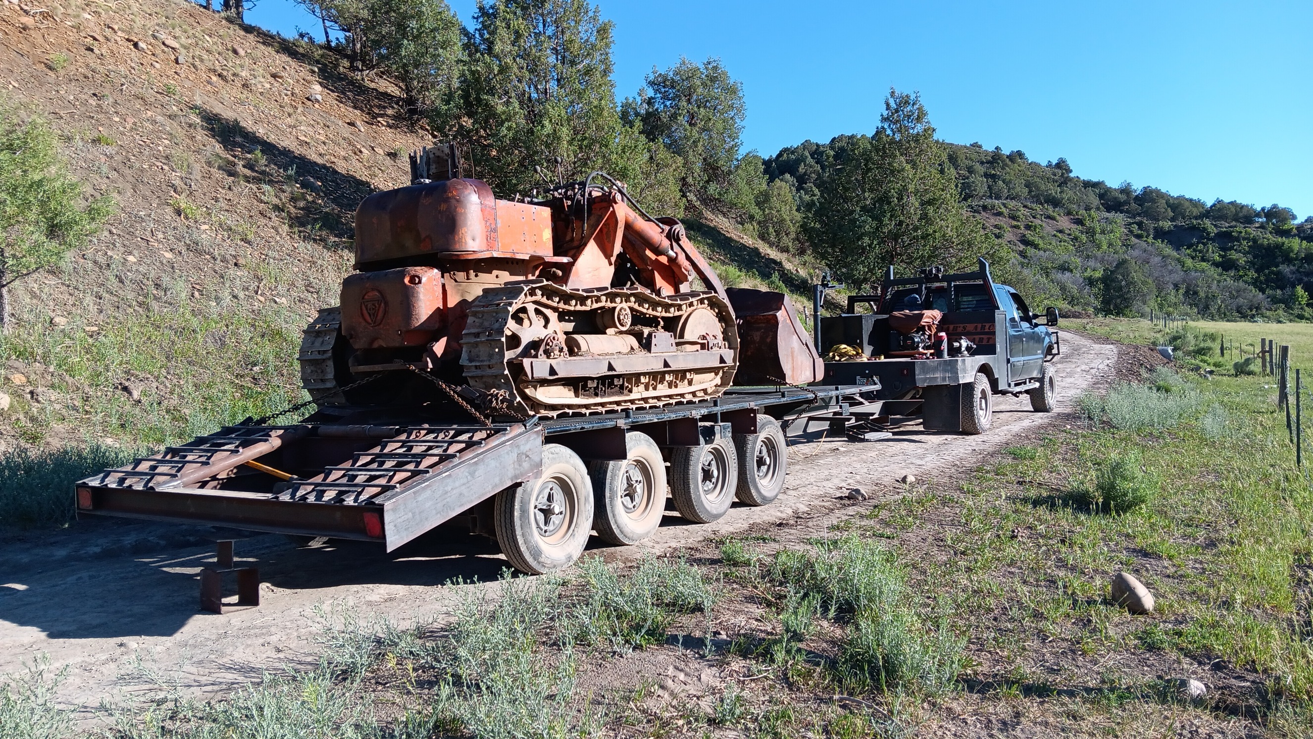

Traded some welding and fabrication for this machine, I would love to use it for a year or two on a property I got. it starts right up and moves and steers. Cylinders have been rebuilt and seem to be good condition. It does leak just about every type of fluid from somewhere but the main issue I see is one side track is loose and the other is good. I was actually amazed because the sprockets havent been welded and seem very good condition,the side with the loose track has woen down the back side of the sprocket tooth but I believe i can re surface that. the grousers are still like an inch tall and on the underside of track, there isnt any wearing through on the chain. One of the idlers seems to be different and I hope to get some information from more knowledgeable people. Thank you in advance,The model number on the back behind the counterweight is Hd5g 15783

Due to the different angle of the photos it is hard to tell if the idlers are pushed forward the same amount. I am wondering if someone may have removed a link in the tighter track.
The spoked idler looks correct, not sure where the solid one came from

Les,
I will get some better pictures soon. There should be 33 links correct? Thank you for the response and your help.

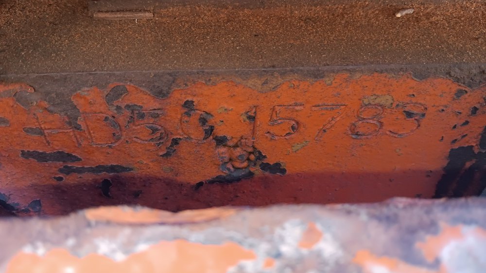

Srl # makes it a 1952 machine , can't see good of the loader cross bar behind bucket but looks like early type , not round update . Early ones had a tendency to crack in several places . Pins on loader frame may be early type where they hook to top point on loader frame - shorter by 1/2 " or so . Other part is early machines did not have 2 reverse speeds switching gearing for loader work . One extra roller was added to truck frame on long track machines .
Track is DOZER track pads as the 5G used a flat track with 3 raised area for grouser wear area. Looks like someone bent or broke the truck frame from picture of RT side angle reinforcement above rock guard , and piece added to front of Left side front of truck frame . With no counterweight or turning with full bucket they do bend the front axles easily and can bend the ears that support the front idler .

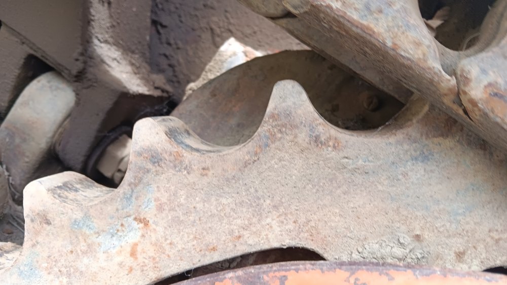

Front idler might be late HD6 , also wear on back side of sprocket may mean someone replaced the rear sprockets and switched sides of machine with them to bring unworn side of sprocket to contact bushing . Grab bushing and feel top side of it for wear to see if they have been turned .
HD6 uses same undercarriage parts as the HD5 - in fact full rear housing on 5 and 6 are the same .
 The single grouser will be hard on all parts of undercarriage when turning  especially if bucket is loaded - take it easy when turning

Also notice the links for bucket dump are bent , those should be straight .

just noticed the odd plate on truck frame by spring or adjuster area , looks like might have been a attaching point for some other use like dozer framework or something .
 Looking at area just ahead of sprocket can't see if it is welded there from repair or replacement .
 my HD5G is a 1955 , sold a 1948  HD5B  (4 digit serial #) nd a 1952 HD5G a few years back
 It's not always age but previous use that makes a machine worth keeping .
Just noticed bucket dump cylinders , not HD5G cylinders , have been replaced with a later style . Evidently in it's past life a lot of modifications or replacement parts have been obtained
Edited by Coke-in-MN - 24 May 2024 at 1:50pm

A threaded rod is used to push the idler ahead for track adjustment.  There is a diamond shaped piece also threaded, the outer corners have bolts sucking them up tight as a lock to keep rod from turning.
Judging undercarriage in pictures is still just an educated guess. I would say the one track look tighter than it should be. But it looks like the tractor may have backed into were it is sitting. This always tightens the track, a trick the tractor jockeys used at auction sales of crawlers. They made both styles of idlers. I think they are the same size. The old HD5 G here has one of each as well.
A very capable machine. I have lifted rocks that we chained to stay on the bucket with the HD 5G that is here.  A ruff guess of over 3 ton, the tractor was tipped up on the idlers, and we backed a flatbed truck under the bucket. Just don't use it as a battering ram.  Of course, don't think you can move things as fast as a newer machine.  If you take your time it will move a lot.

I imagine the replacement cylinders may have more lifting force, causing the bent links. There are quite a few welding repairs to accomplish but that doesn't scare me. Lack of parts do. I haven't been able to do anything with the loader quite yet. I will update you all real soon. Thanks

I see in one picture the outboard axle bearing has a grease zerk in the plate and 2 guards welded onto it . Many were drilled in the housing instead of the cap as there is a flat area that is easily modified . As dozer frame was bolted onto the housing on the  B crawlers with outside frame attached at axle .
 Parts are out there as many of the machines are still around - might not be running but parted out . Was a common weak spot it seems of upper rear first reduction bearing on outboard side , to go bad and crack housing

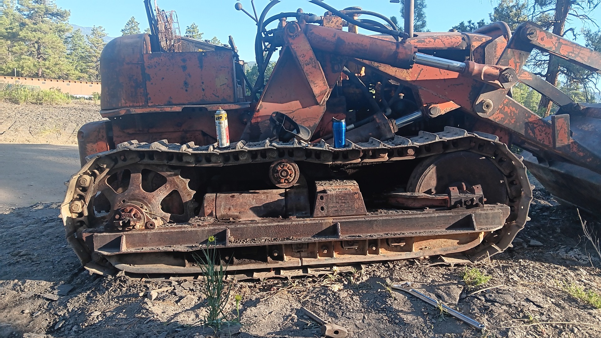

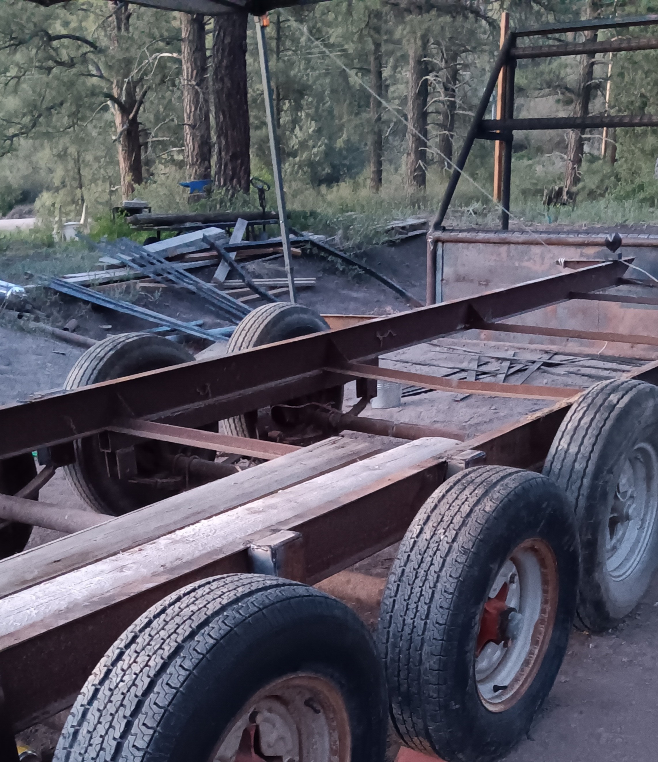

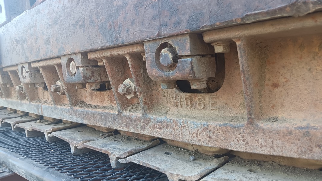

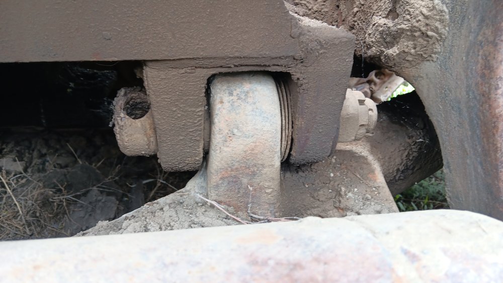

The entire truck frame, chain and tracks on the right side are from an HD6, I'll post more pictures tmrw.
Points: 90643
Post Options Post Options   Thanks (0) Thanks(0)   Quote steve(ill) Quote  Post ReplyReply Direct Link To This Post Posted: 06 Jun 2024 at 10:44pm
nice trailer........... to go with the HD ! ........... thats a DECK on a House trailer frame ?

Thanks! It was an old rv frame I got for 300$ I had a set of axles that matched. Most of the I beam was leftover material from welding jobs and the deck was a roof rack that was cut off a box truck awhile back.it worked out for under 1k in material. not bad for a monster garage style build. I only had like 4 days to build

It looks like both sides of the machine have been swapped to the HD6E undercarriage.

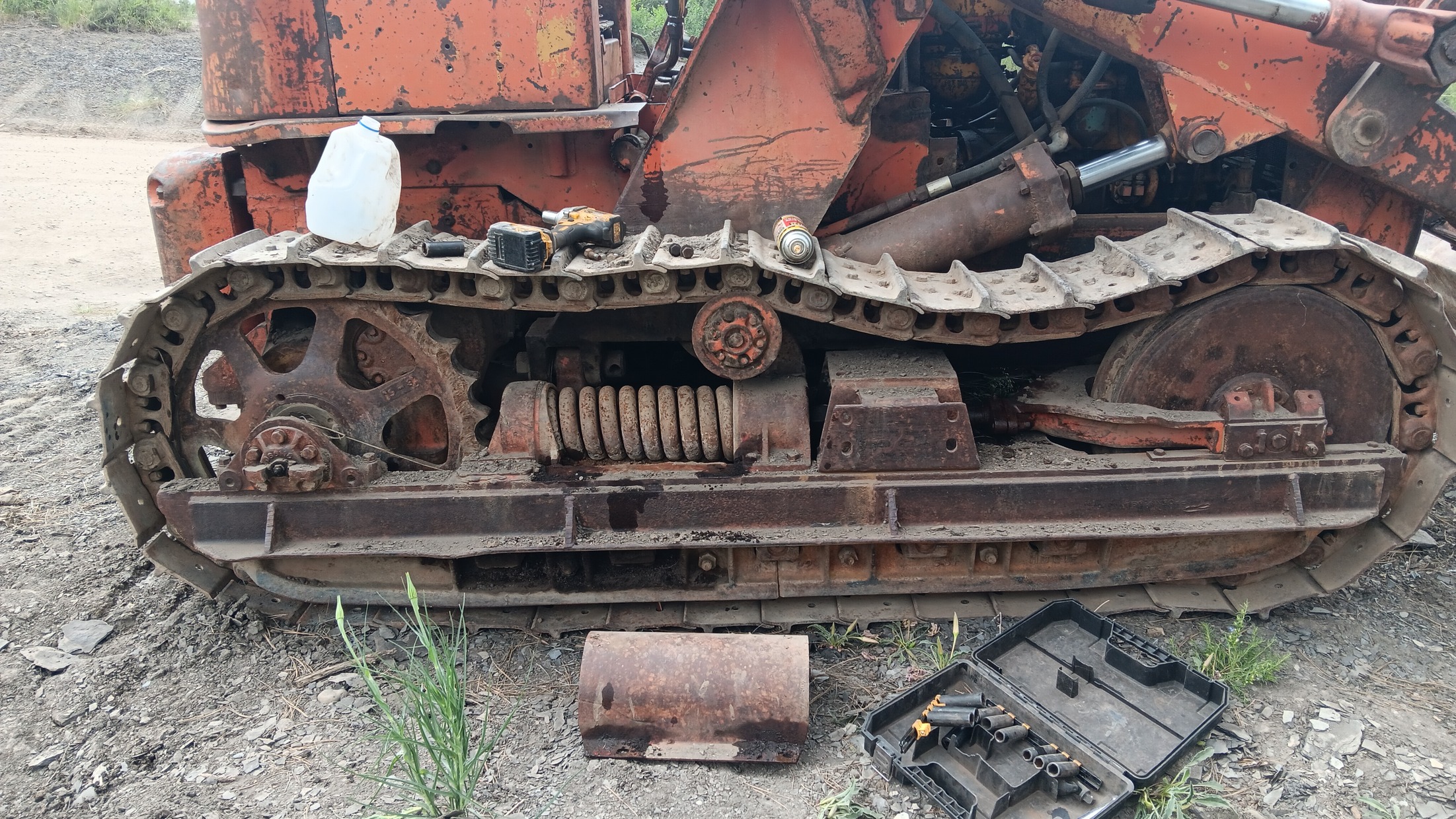

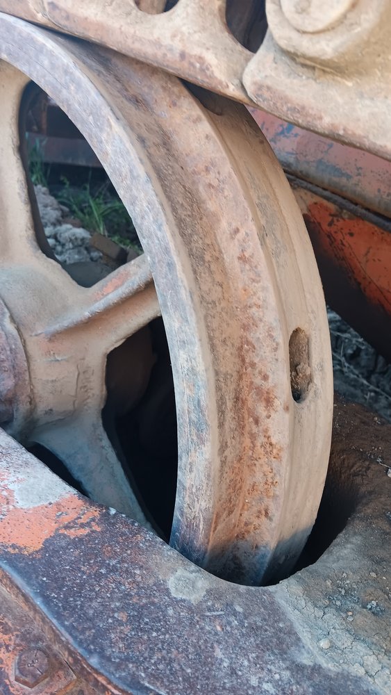

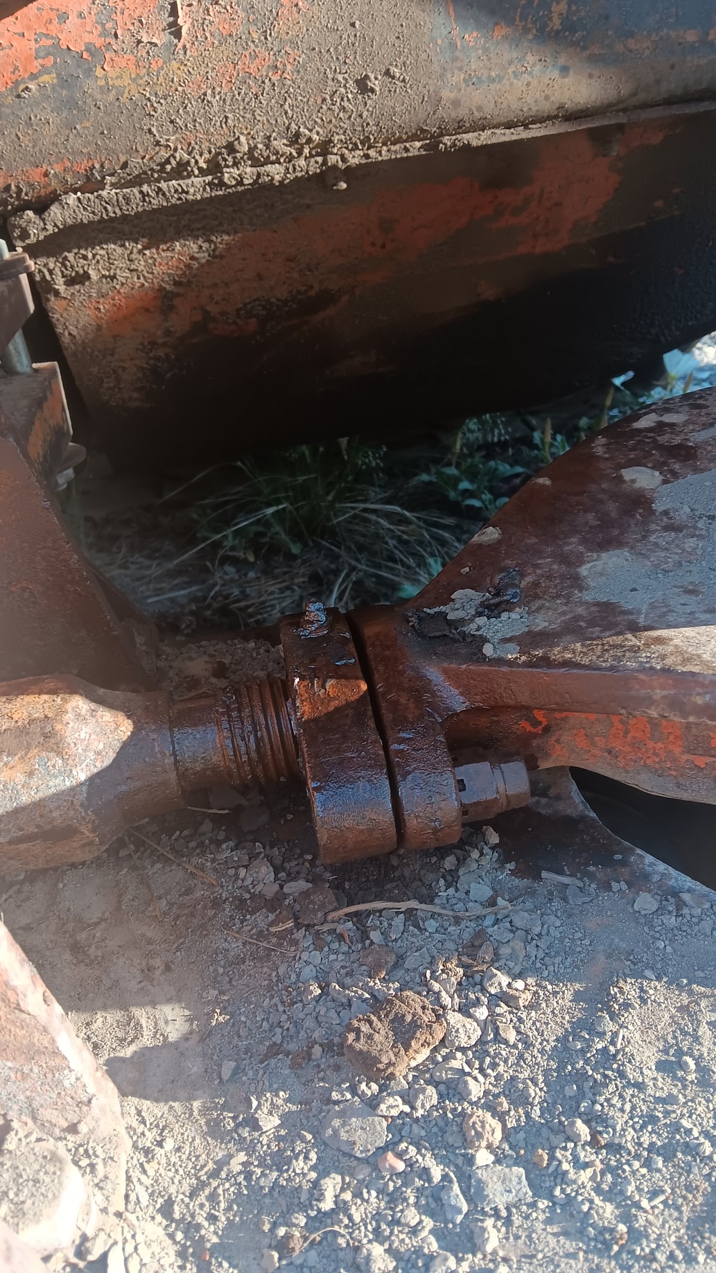

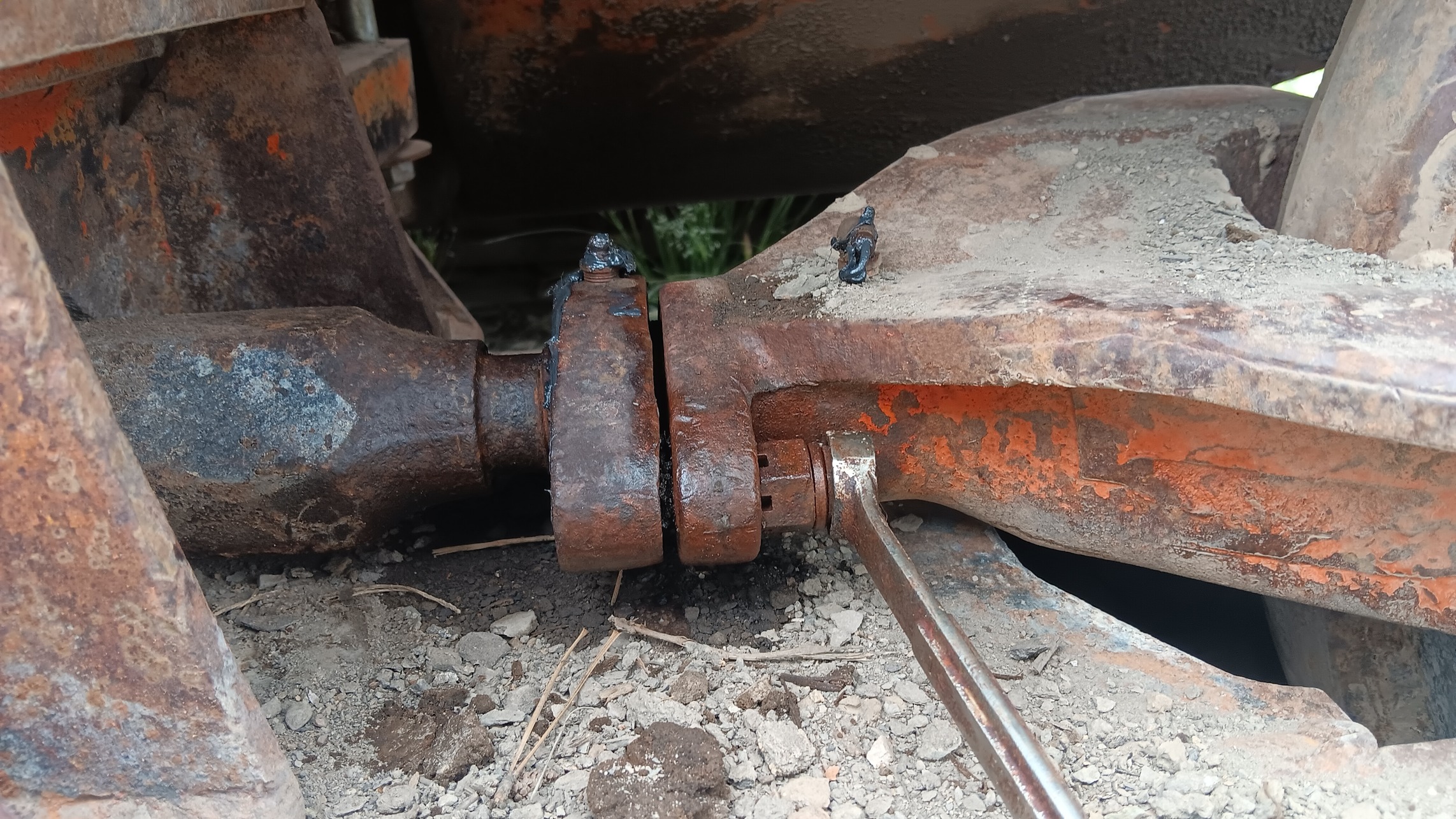

Now the fun begins, hopefully I can get this track figured out. I ran the machine for about 20 minutes smoothing my my driveway and decided it needs immediate attention.

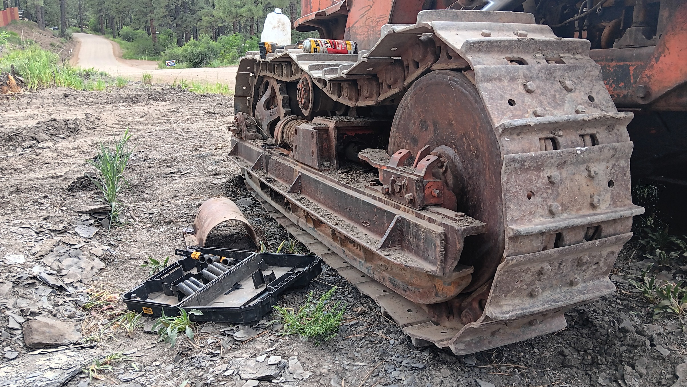

I loosened the cap lock and tightened the adjusting screw all the way in and didn't do anything to reduce slack. What next?

You need to removed the bolt each side from the yoke and turne the rod adjustement counterclock wise if the tread still good in yoke

I think but am not entirely positive you have a couple of different type track adjuster parts that are not working together. From your last photo I see a hydraulic yolk for tensioning the track incorporated with a mechanical type adjuster. These are not used together at all. In the hydraulic type, there is a piston with a seal that grease pushes against to force the front idler wheel forward. In the mechanical style, that externally hex shaped rod is what pushes the idler wheel forward.
I've not worked on AC machinery of this vintage/size myself so only surmising, but again it looks to me from this angle you have incompatible parts installed such as a mechanical adjuster from the original tractor, and replacement parts from a donor. Again, I don't know for sure. Have you counted the actual track shoes to ensure one is not longer than the other such as having a link removed? Pulling straws with that one but have seen stranger things done to keep old machinery operating.

I loosened the cap lock and tightened the adjusting screw all the way in and didn't do anything to reduce slack. What next?...
Turn it the other way? Confused

Yikes, I wasn't thinking to well last night. 🤡
Thanks Les and Codger, just needed to turn the other way. Thanks. Sure did take some slack out now.

I counted pads and both sides have 37.
I believe the zerk fittings were added or came standard on the HD6E the tracks came off. I believe the grease fittings are just for the threaded rod and do not tightened the tracks with hydraulics. What also odd is that Coke said this was a 1952 machine based on serial number but the machine has two speed reverse.

Originally posted by Noah Noah wrote:
... What also odd is that Coke said this was a 1952 machine based on serial number but the machine has two speed reverse...

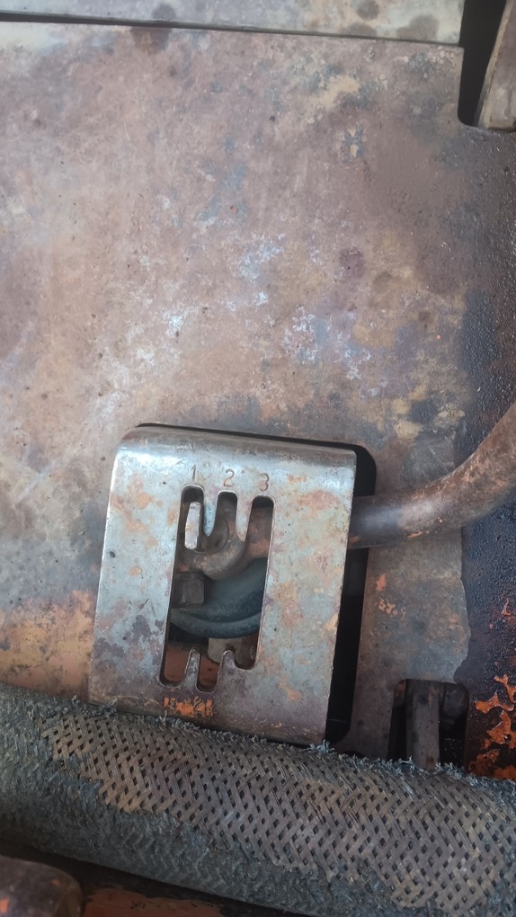

I believe all the HD 5G are the 2 speed reverse.  I have an HD5 B with a 2 speed reverse and have seen others with it also.  Most HD 5 B's sold here new where for ag work pulling farm equipment so most had 5 forward and 1 reverse. So I guess they could be ordered ether way.
