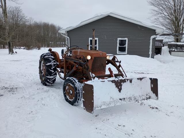

The D14 started hard out in the cold mini shop. Even with the battery charger on for a day. I moved it to the warm shop after about 10 min of running. I had the gas shut off but I saw some gas on the exterior of the carb. So I thought maybe it was flooded prior to trying the cold start. Anyway after being in the shop it started easily each time I tried it. Starter sounded good, solenoid preformed as needed. So I called Brenda at Sandy Lake several reasons. I ordered a premium carb kit for the Marvel  Schebler TSX 670 carb. Also a replacement sediment bowl assembly. The carb doesn't look like it's been off for years. A clean up probably wont hurt that a bit.
The replacement sediment bowl may actually shut off the gas to the carb when needed.
While talking with Brenda I mentioned that the tractor engine governor was "hunting" during initial running. She asked if there was a spring on the governor rod behind the carb. I looked and yes there was a spring but the hook portion was so weak from corrosion it had come off the manifold bolt. So I ordered a new springs also. I did try to put the spring back on and it did actually start better, and did not have rpm's going up and down.
I think the D14 just wants to stay in the much warmer shop!:)

Post Options Post Options   Thanks (0) Thanks(0)   Quote Sugarmaker Quote  Post ReplyReply Direct Link To This Post Posted: 4 hours 45 minutes ago at 8:36pm
Allis Folks,
The D14 reluctantly started today. Outside temp is around 20 deg F. same temp where the D14 is stored with the other tractors.
It worked well to plow the U shaped drive around the shop. Some of the piles are getting 4 foot or more in height. The high lift and plow work great to push snow over the top of them.
The engine did run better with the small spring in place on the governor to carb rod.
