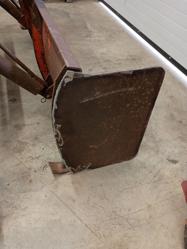

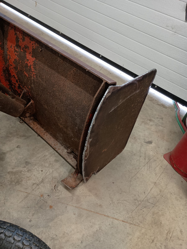

Post Options Post Options   Thanks (0) Thanks(0)   Quote Sugarmaker Quote  Post ReplyReply Direct Link To This Post Posted: 07 Nov 2025 at 10:31am
Allis folks,
 I have the wing design layed out for the ends of the push blade. Need to go to town to get oxygen to cut out the shapes. This will make it into a poor mans box blade. The end pieces may just be welded in place direct to the blade or may be bolted on so that they could be removed?? We will see how the end pieces fit when cut out and cleaned up. They are about 21 inches high, the height of the blade, about a 1/2 inch off the ground on the bottom. (room for a shoe if needed). The distance out from the blade is about 16 inches. (that's all the material that I had to make these two box ends).

Post Options Post Options   Thanks (0) Thanks(0)   Quote Steve A Quote  Post ReplyReply Direct Link To This Post Posted: 07 Nov 2025 at 5:52pm
I'd bolt them. That way if you ever modify it to angle you can easily remove one side.
Points: 8582

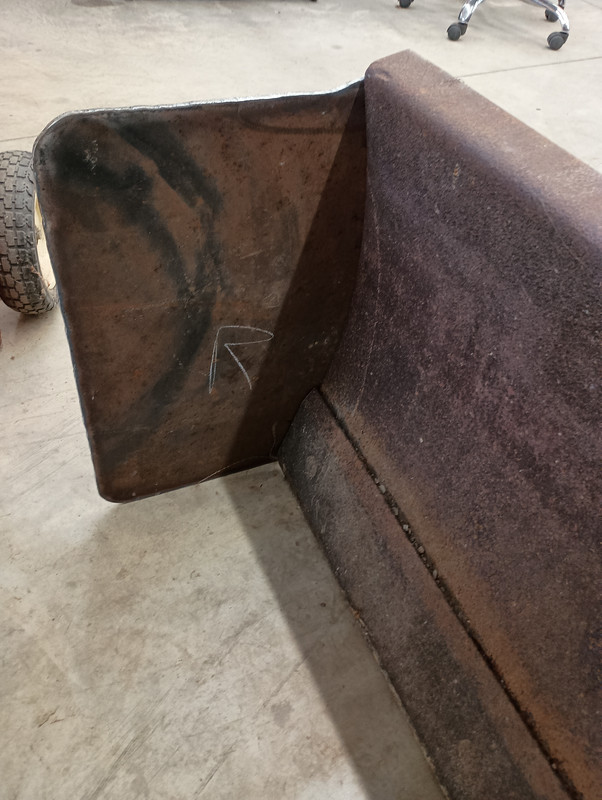

Post Options Post Options   Thanks (0) Thanks(0)   Quote Sugarmaker Quote  Post ReplyReply Direct Link To This Post Posted: 14 Nov 2025 at 8:27pm
Steve A, folks,
I touched these end plates out this morning. Was good to do some oxy/act cutting.
Yes I plan to bolt these wings on to the ends of the blade. Good suggestion. We don't have any snow yet. Maybe wont need this plow tractor this year??
I drilled 4 holes in each side for 3/8 bolts.
