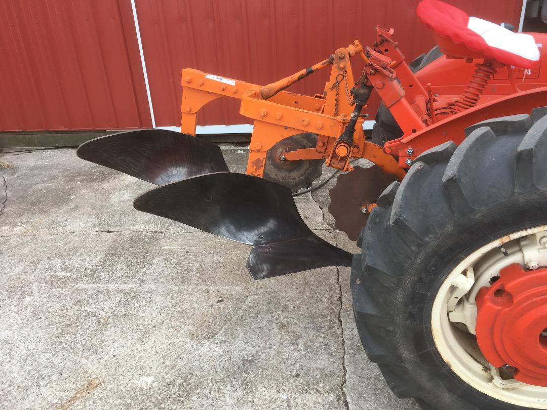

Started a little work on the plows. They are in bad shape. Not sure they will scour?

Put it back together about dark and then turned to the two bottom plow. She is rough!
Flap disk to clean up whats left of the plow points. Get them less jagged. Then rolled the torch over and heated up some nuts to adjust the coulters where I think they should be.
I dont know how my Dad farmed for 50 years without a set of torches on the farm!

Just itching to get that two bottom plow hooked up. Our plow day is a month away and would like to have this there and set up ready to go. I would take off the loader. Can you even run the plows with the loader cylinder connected?

Chris, if you're going to use that plow in a month you better get busy! Looks like the lift arm links are rusted tight, they could b e set ok, or not. I like to be able to adjust things. Can't see the beaming screw in your picture, guessing it may be stuck too. The bottoms look like they will clean-up with a good wire brushing then a flap wheel and finally, lots of dirt!
Here's a shot of mine, different bottoms than yours. Mine are 24's, think yours are 124's?

Chris, No need to show pics on that other thread in the other area.  I see em now!!  You did REAL GOOD!
I'd like to see how that plow blade is attached to the bucket frame.  I'd like to put a plow on mine.
