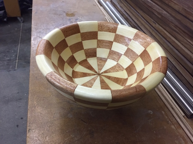

My biggest bowl to date.  I like it!  Blank was 6-3/4" layers thick by 11" across.

So Greg... what does your blank look like BEFORE you turn it?  You glue a bunch of blocks together to make the blank?

I cut and glue up the pie shape times 6-using a strap clamp.  After the glue is set I sand both surfaces flat on my bench top belt sander.  I then drill for the dowel in the center-helps with orientation and cosmetics!  I then glue up the 6 blanks into this!  Once dry I cut the blank from the bottom at 22.5 degrees before chucking it on the lathe-helps establish the shape.  I figure I have 4 to 5 hours in prepping the blank and 1.5 hours in the actual turning/sanding/sealing!

Wow... that's cool... a whole lotta chips on the floor.  Must be really good glue?

Titebond II glue is great!
