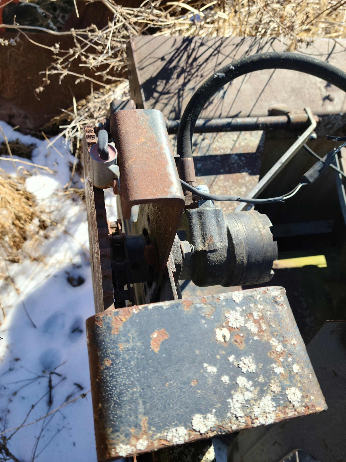

Post Options Post Options   Thanks (0) Thanks(0)   Quote Daehler Quote  Post ReplyReply Direct Link To This Post Posted: 20 Feb 2022 at 10:59am
There's a sensor that goes by the real drive motor and large sprocket that it reads off of. Might need wiring that goes to the combine but I think it's all integrated into the wiring harness you already have

Post Options Post Options   Thanks (0) Thanks(0)   Quote CrestonM Quote  Post ReplyReply Direct Link To This Post Posted: 20 Feb 2022 at 8:22pm
Thanks for the photo! Now I know what I need to be looking for.

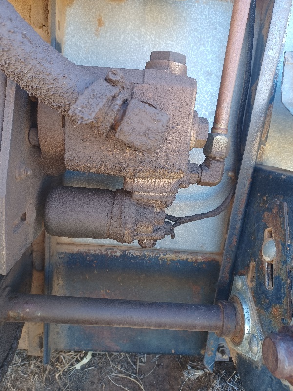

Post Options Post Options   Thanks (0) Thanks(0)   Quote Michael V (NM) Quote  Post ReplyReply Direct Link To This Post Posted: 22 Feb 2022 at 12:23pm
Besides the sensor on the drive motor,ya gotta have the servo on the pump,this is what actually changes the reel speed
