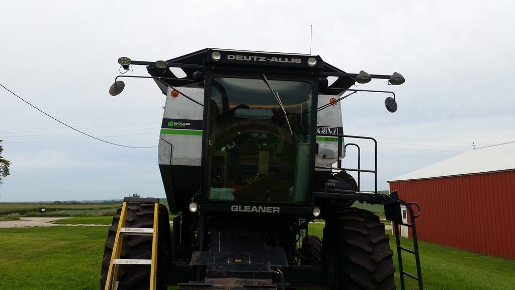

Starting a thread for the conversion of our R50 to LED's  all lights will be replaced except the 2 cabmounted driving lights (haven't tired real hard to find a replacement for them.)
Lights are Buyers Product 1492113. Rated at 1350lumen, draw 1.5amps and are flood style.  Housing is Aluminum.  http://www.buyersproducts.com/Electrical-Lighting/utility-light/work-utility-lights/oval-clear-led-flood-light-12-24v/5209/
The plan is to replace the 6 forward facing, 2 side facing, and add 1 to each rear corner.

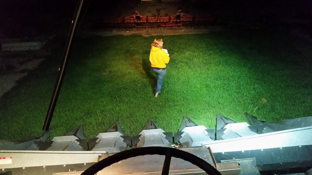

Here's the first 2 pictures, the Led's are not aimed, just threw up there for now.  I replaced the 2 on the right side light bar and intentionally left the other 2 for a comparison.

Your favorite "crop" right?

Steve, yup, she's actually holding our 3rd child.  Kenny, if I had the big bucks and could just stay home I think I would try that.

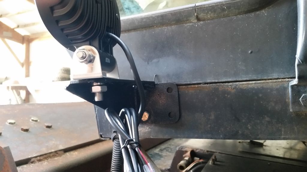

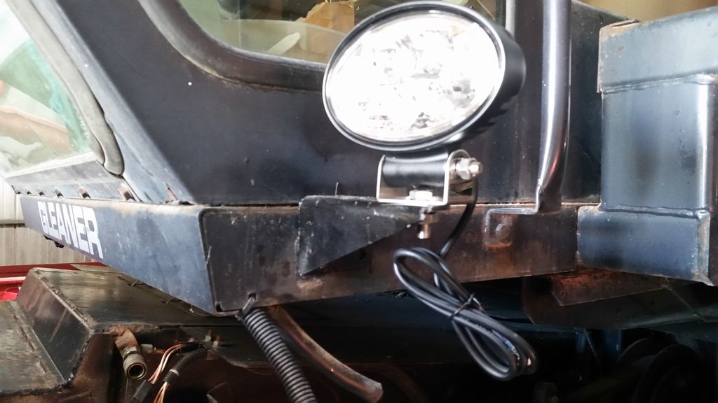

brackets I lasered and formed to mount the header lights
