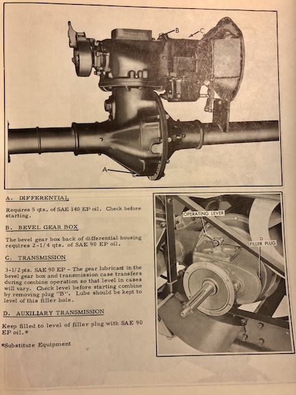

I would hold out for an F/F2 - they are getting cheap. The input shaft and truck style trany on the A /A2 - I have memories of laying in the mud on a cardboard sheet changing out parts... The wooden raddle - it is probably gone - a lot of chains were ag type flat chains.  You are looking at a 60 year old machine - and w/o a cab - crops are different today than in the early 60's.
So the input shaft and transmissions were a weak point on these? I will be sure to look at the raddle.

Post Options Post Options   Thanks (0) Thanks(0)   Quote AC7060IL Quote  Post ReplyReply Direct Link To This Post Posted: 11 Mar 2024 at 6:37am
This photo shows the Gleaner A's transmssion/differential/axle configuration that tbran eluded to his earlier post.

I ran a A2 1967 for 19 years on 88A. No variable head speed,no header clutch. No big deal. 3-30 corn head and 13ft platform. I would weld up rasp cylinder bars if not worn or rusted paper thin. I liked it.
Worst thing about the A,C,G was the traction drive. Spring in variable wouldn't get through mud. The cam drive spring in F2 was BIG improvement.
