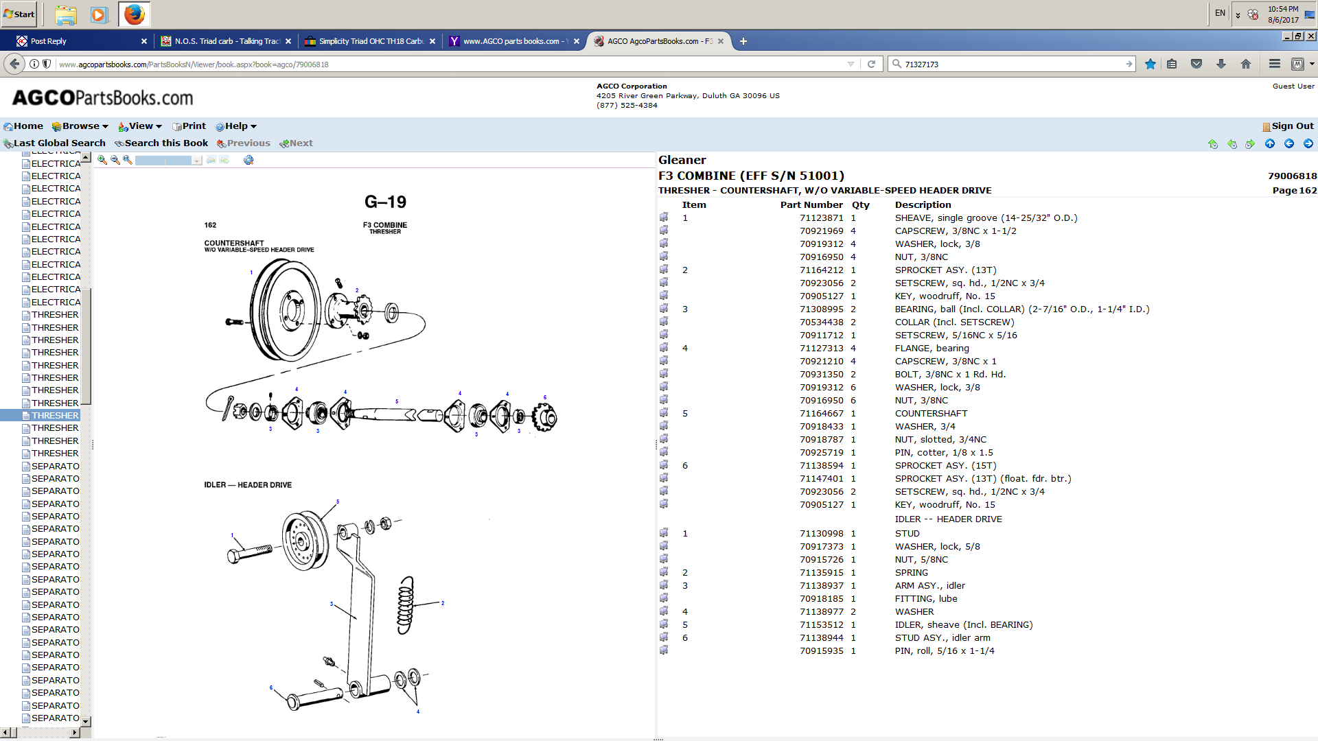

Anyone have any specs for what the torque setting should be for the nut on the left end of the thresher countershaft without the variable speed header drive on an F3?  This is the shaft that drives the head and the feeder beater.  Is there a torque spec or just do the German spec of Gutentite then just enough more to get the cotter pin the castle nut?  I'm typically fussy on using the torque wrench whenever a value is given.  Thanks.

The shaft and sprocket are tapered. I'm asking because the old sprocket has been welded to the shaft some time in the past and it's either not square or the shaft is bent. The big pulley bolted to the sprocket wobbles a lot as a result. We just want to get it fixed. I was wondering if this was something that was prone to coming loose if not tightened properly and was just wondering if a shop manual would have a torque value. If not I'll just go pretty tight and then watch it. This should not have anything to do with the tightness of the bearings.

Are you sure that the "weld" isn't the sprocket welded to the tapered hub? That is exactly why we had to change our shaft AND that sprocket(ours is a double sprocket on a tapered hub-that part # is in a cornhead book),the pulley wobbled so bad it rolled and then threw the belt off. After closer examination, the tapered hub was wollered out,threads on end of shaft stripped and keyway slot in shaft ruined. Since this morning,I went out to the farm to look how snug that castle nut was and found that the pulley is loose on the sprocket hub!

I can assure you that the sprocket is welded to the shaft. Someone did that some time in the past. Ours has the double sprockets for the corn head too. Like you said you have to look in the corn head book to get their part numbers.

I don't know if this link will work, but it shows the combine running today with a new shaft and bearings and sprocket installed.  No wobble any more and sprockets and celts all are nice aligned.
